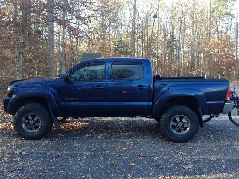

    I just picked up the st maxx today and have to say I really like them so far. I came from 265/75/16 Firestone Destination AT and the looks are totally different. The st maxx are definitely more aggressive looking. I noticed no loss in power or torque, but only drove them about 50 miles today. Should get some more miles this weekend. I'll be tracking mpgs so I'll be able to report on that for anyone interested. With the 265/75s I was averaging right about 19 mpg. Pics to come once daylight gets here tomorrow.

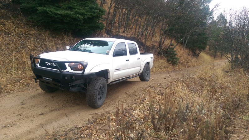

    This has still been a great size tire for everything I have thrown at them. IMAG0908.jpg

    Snapped a pic of the new tires today. Liking them a lot so far, low road noise and love how they fill out the wheel wells.

    looks real good!

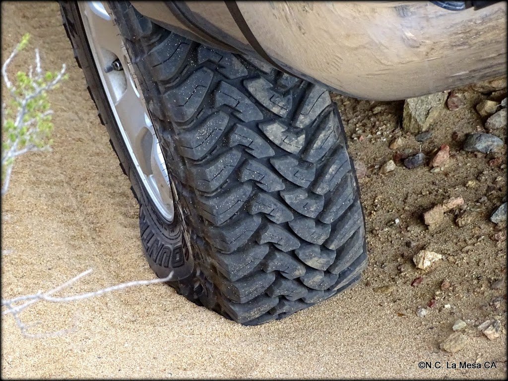

    Great photos guys! I always liked the aggressive look of the Toyo M/T's, they have a pretty wide tread for the 255/85.
    I am currently running 255/85 Cooper S/T which are a pretty mild looking tread but they work superb in rocks when aired down to 18 or 20 PSI. And as you guys say, that tall sidewall makes them ride like a Cadillac on a cloud (well sort of...).
