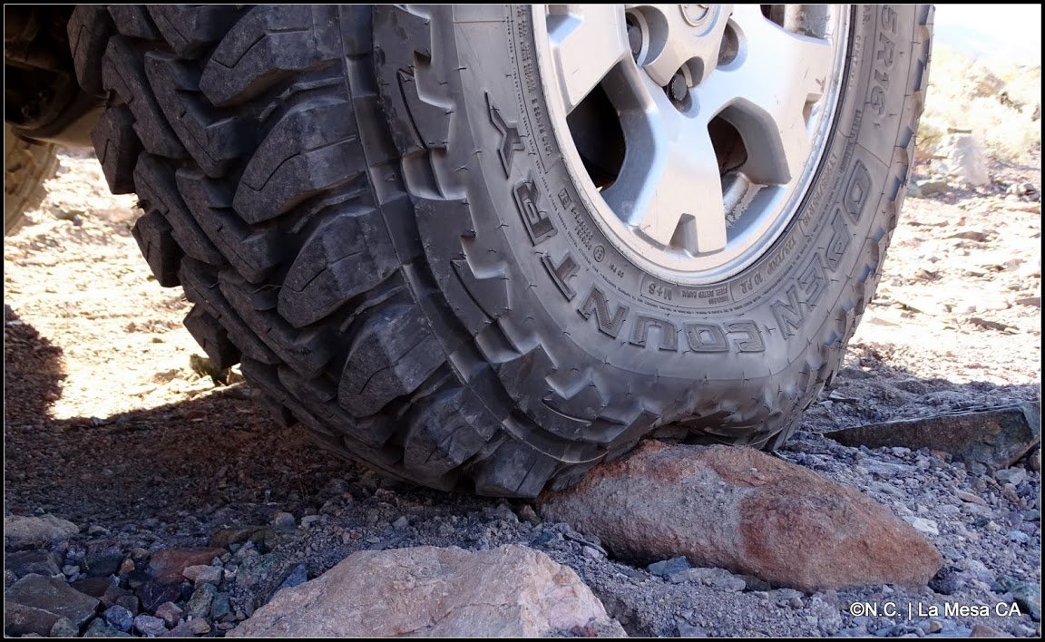

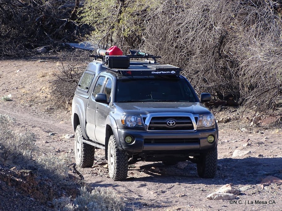

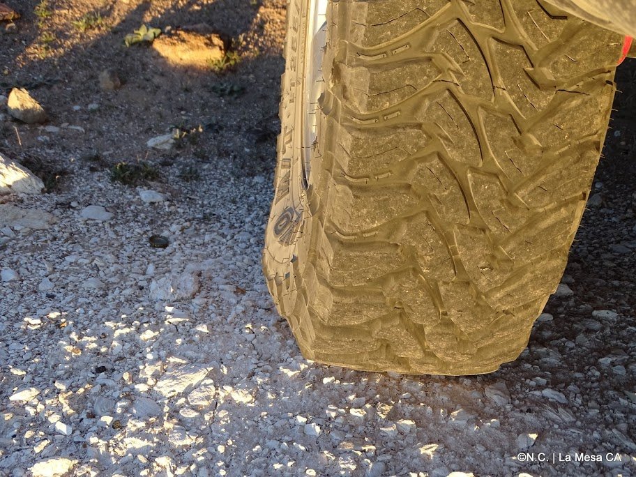

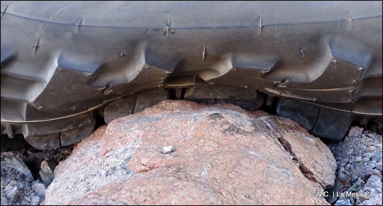

    I wanted to share some info with yall wheelers I learned from my last trip. I've been experimenting around with different PSI levels. I'm settled on 36 PSI for street. I was running 40 PSI, but the ride was too god damned rough, and 36 PSI is working very well.
    I ran my Toyo MTS at 20 PSI for 250 miles off road in Death Valley. Speeds range from 1-53 MPH at this PSI. Terrain was mostly hard pack with lots of rocks. Alluvial fans, etc.
    A pic of the truck.
    Here is a pic of the sidewall deflection at 20 PSI, truck was 400-500 lb over stock, i'm including the weight of dual battery, shell, fridge, recovery gear, water, etc.
    Ran over a small rock, and decided to take a close up view.
    Check out the tread formation. Near perfect engagement.
    At 20 PSI the ride was very comfortable in the rocks. I've gone down as low as 12 PSI with these tires, but I think the comfort for me was near the same. Very subjective, comfort, but I was happy to say the least.
