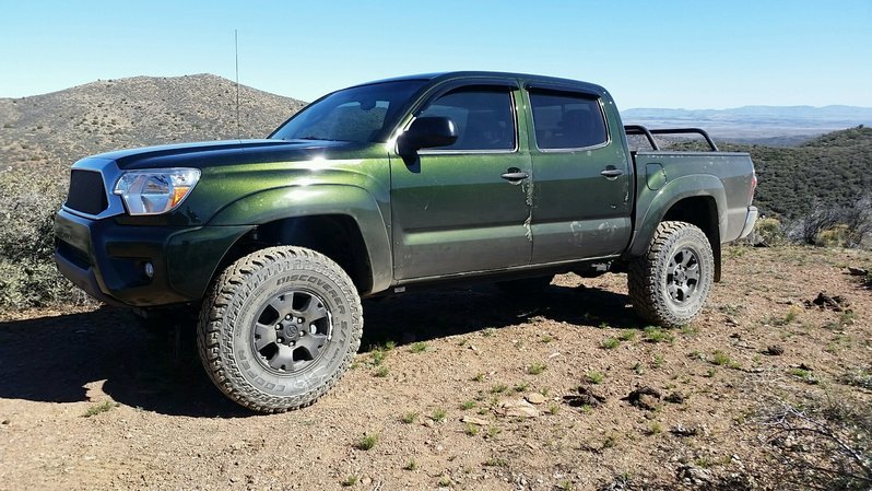

  8. Mar 16, 2016 at 3:09 PM
    #3308

    Ok I'm going to be lazy rather than read through this whole thread and ask :crapstorm: I have 5100's all around set at zero with eibach springs with 1/2" top spacer that puts me at 22.5 center hub to bottom of fender how much trimming/cutting will it take for me to run 255's

  9. Mar 16, 2016 at 3:48 PM
    #3309
    Boston10Taco
    Boston10Taco Dented
    Oct 3, 2012
    #88261
    2,372
    MA
    2017 Tundra
    Remove mud flaps and minor trimming of inner fender plastic.

    British Columbia
    Are you on stock wheels with no wheel spacers ?

    British Columbia
    Not you

    2017 Tundra
    No. Km2s on 16x8 0 offset. They don't hit the cab mounts. I think stock offroad wheels might need spacers.

    British Columbia
    Thats the whole point though , with stock wheels you're less likely to rub with this tire size

    2017 Tundra
    Less likely to rub the frame, still going to hit plastic

    2014 Spruce Mica DCSB
    Zero rubbing at all for me. Although I did take those little mud flap things off long before the lift and tires.

    British Columbia
    Adding wheel spacers or going to a 4.5 BS or similar wheel increases the scrub radius and the chance of rubbing
