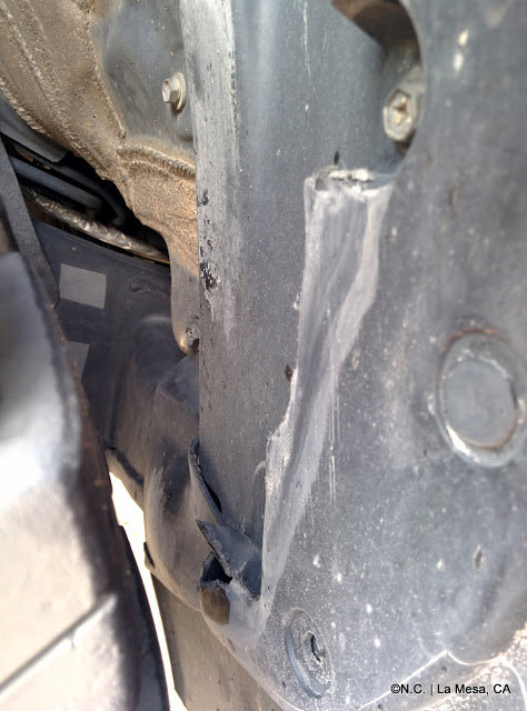

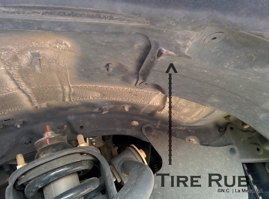

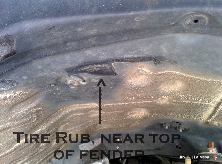

    I can't believe it's come to this, but I think I am going to have to cut or beat the crap out of the pinch weld.
    My Toyos rub bad under heavy compression the back side of fender well, on the so called pinch weld (no pic).
    But also rub near the top.
    Mud flap

    Front flap removal might solve the rear rub. A little smashy smashy will obviously fix the upper fender rub issue... Unless you shim your bumps... Losing uptravel sucks tho.

    I think I'll pull the plastic liner out, notch the pinch weld in 1" sections, beat those over, paint, put back plastic fender liner and then reshape it with heat gun. That will take care of most of the rubbing. I'll find a way to retain mud flaps, I have to have those to not destroy paint on my doors. Not sure what to do for the tops of the fender liners though. Maybe a little pounding, but don't want to get carried away. :)
