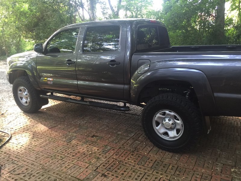

    Here's my truck with 255 85 r16 Cooper STMAXX's. They look much beefier in person. Happy with the tire selection. Suspension setup is Icon Stage 3 with Dakar springs. Semi-happy with that... once I can get some vibes figured out.

    Looks good!!!! any rubbing ? how much of a lift do you have ??

    Want the same tires just don't want it to rub.... have the 6112 set on the highest level and 2'' blocks in the back

    You won't rub if you use stock OR wheels. Even without a lift.

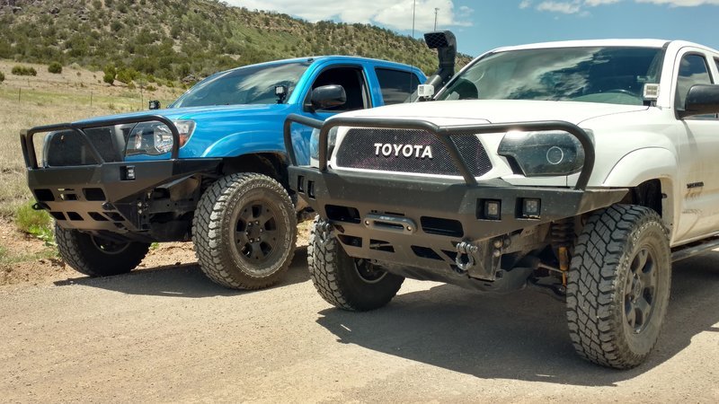

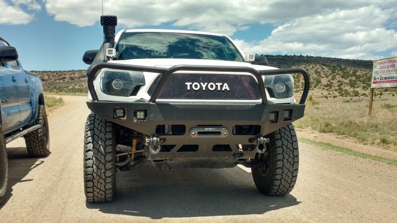

    Who out there has a steel bumper? I'm thinking of getting one but want to see what it'll look like with the 255's :D

    (leaning towards an ARB).. maybe not the most stylized, but I feel that it has the most rugged look.

    White truck is 255/85r16 and blue is 285/75r16.
