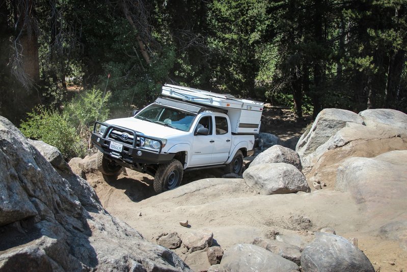

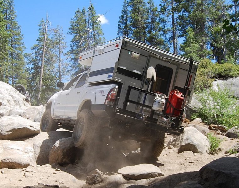

    A week ago I beat the pinch weld flat as a pancake on my truck, and reformed the fender liner with a heat gun. Did major cuts to the mud flap. Installed 1/4" Bump stop spacers.
    Finally, finally! I can wheel the truck without any rubbing.
    All the work for the Toyo's I've had to do...
    • Moved to 4runner Limited wheels with 4.5 back spacing to solve: frame, LCA, and UCA rubbing.
    • I had to beat the pinch weld flat with a sledge hammer,
    • I had to cut back the mud flaps a lot,
    • I reformed the fender liner with a heat gun to make flat (after pinch weld was beat flat)
    • I also had to relocate the spare tire carrier back 1" to avoid the diff hitting the 255 spare under compression.
    • I had to install 1/4" bump stop spacers to stop rubbing tops of fender well under full compression.
    • Cab Mount Chop
    The 255/85/R16 Toyos are the largest in their size and to make them fit was a lot more work than I bargained for. But I am glad for it. They are a really tough tire and have performed really well off road and I'm quite happy with them.

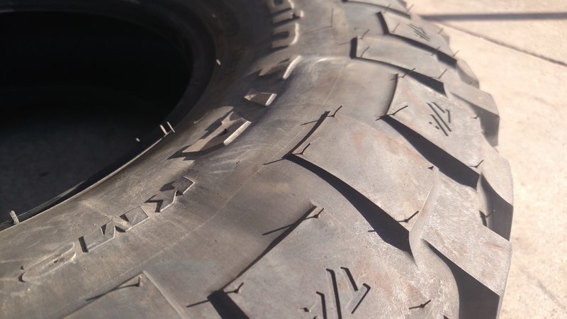

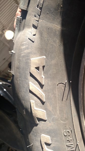

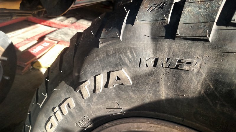

    So far I've been impressed by my pizza cutters. They perform well on everything I've thrown at them including mud and loose sand. In the mud and sand I've noticed I have really good steering authority. If I am in a rut and choose to steer out of it, the tires just cut through and right out. Same thing crossing ruts, they don't try to steer into an established rut, they go where I tell them to. On the highway, I picked up about 2mpg and for an M/T they're fairly quiet. Being 10 ply, they are a stiffer tire and you will notice potholes hit a bit harder.
    I would also like to add that I did get a defective tire from BFG. The tread began to separate from the belts after only 5000 miles. Pressing on the bulge pictured was like pressing on a soft loaf of bread. Just wanted to share that for anyone else running these tires to keep an eye out for.

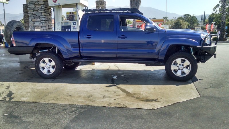

    Hey all. I'm going 255/80/17 on my sport and curious whose running spacers with this set up? If so, what size spacers? I haven't trimmed or chopped anything. Currently running 265/65/17. Thanks! Here's a pic of my current set up.

    Ontario
    Double cab SR5 4x4
