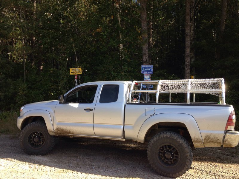

    Any pics of the front and rear? Looking to see how tucked in the fender well they are. Or if they stick out at all.

    None right now but they are 16x8 -10bs and they stick the toyos out about half inch looks great really and they don't rub at all

    i feel like an idiot asking this but i don't want to dig, and i forgot. lol. my wheels have 4.5 backspace. that means mine will be further tucked under the fender right? your -10bs pushes the wheel out correct?

    I think maybe I posted wrong and my offset is -10 making my backspace around 4.3ish

    16x8 -10 would have a 4.3" backspace.

    right. so technically my 4.5"bs will make the wheel stick out .2" further than his 4.3". or is it the other way around?

    You will sit .2" inboard. Backspace is the measurement from the inside wheel edge to the mounting surface. The lower the number, the further away from midline the wheel sits.

    post a pic of how much they stick out whenever you get a chance! would like to see

    Off topic, but can you please tell me who made that aluminum bed rack?? By the way...good looking truck.
