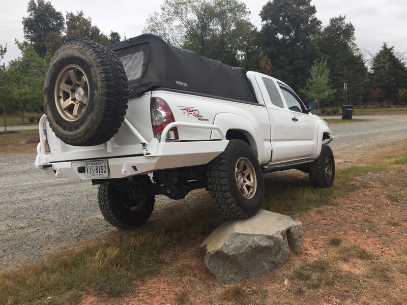

  5. Oct 10, 2016 at 6:28 PM
    #3705
    Base Camp
    Base Camp Instagram: @willismtc
    Aug 26, 2014
    #136993
    1,263
    Willis
    Roanoke, VA
    '14 Base Model 4x4
    Today testing out the shackle flip. This is my second set of 255/85/16, and ill never get another size. Unless 35's of course.
    Inmand09, Watt maker and Casper66 like this.
