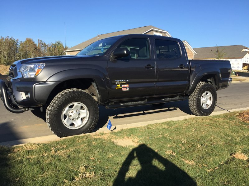

    Have had my lift and tires for a while but haven't posted on here. Cooper ST Maxx's with Icon stage 2, rear dakars.

    Any idea what you have the stage 2 set at? I am contemplating same tires, dakar, and a different setup in the front. I like how yours looks. (I can't tell if I can get away with 2.5 in the front or whether I need a full 3.) BTW, I'll have at least 300 lbs in the back at all times.

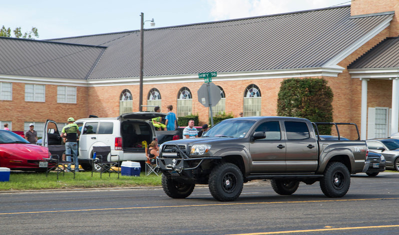

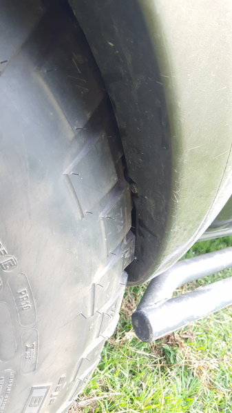

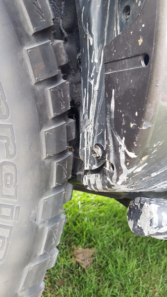

    OME 886 coilovers and AAL.
    The only times the tires even slightly rub are when the suspension is maxed out. At the front, the tires will catch on a bolt/screw at the bottom of the inner fender, and will clean the dirt off of the cab mount. If any extra weight is added up front, I'll probadly need to do some trimming.
    In the rear, there is no significant signs of rubbing. I can thank the stock bumpstops for that since they stop compressing after an 1" or so.
