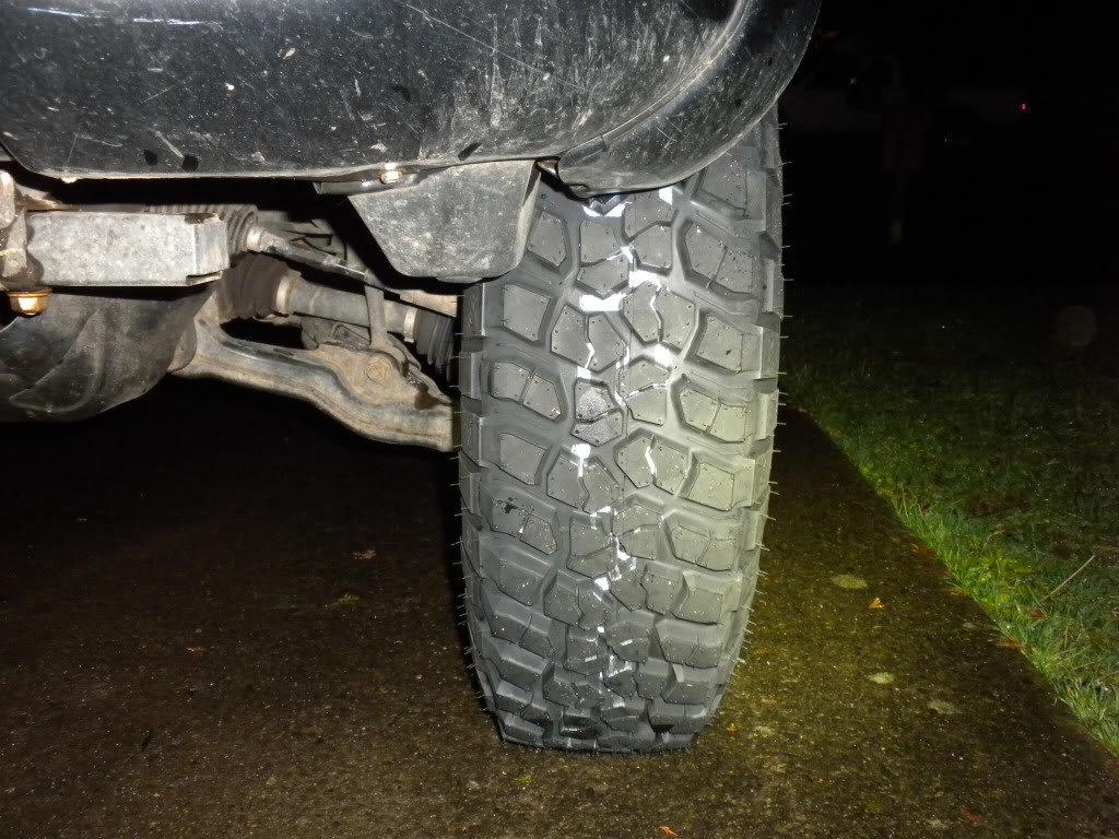

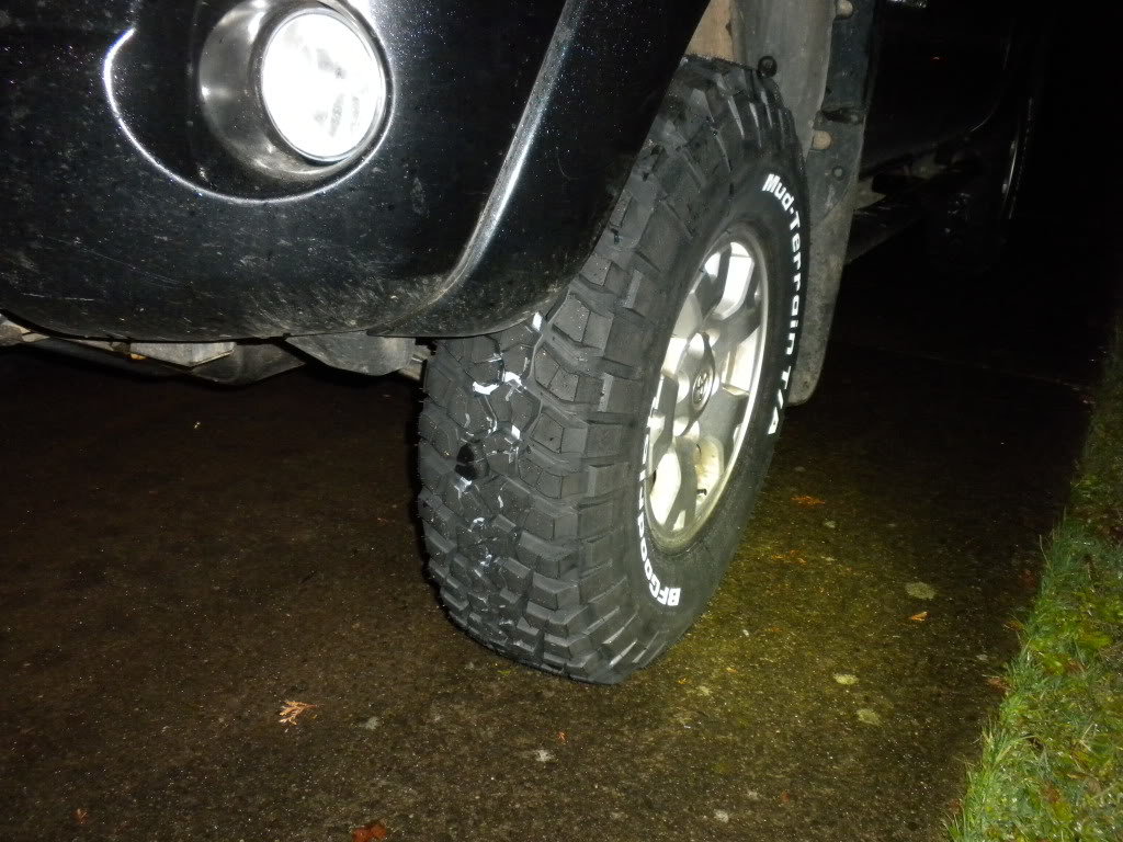

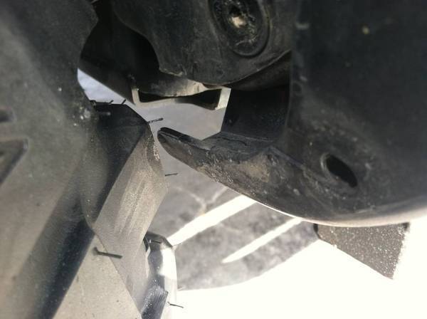

    Just had the 255 KM2's w/ silver TRD wheels put on this morning by America's Tire, and here's my 20 mile review (due to finding my sway bar was disconnected... grrr).
    FYI, these were put on a truck already having Kings set at minimum and Dakars. SO... There IS a noticeable height difference which I only felt getting in and out, but not behind the wheel - weird. There is a slight hum while rolling, but nothing remotely close to bothersome. Aesthetically, they look phenomenal from the side, and still kickass from the front, imho. I haven't noticed any decrease in acceleration, but my ATO skids aren't on yet.
    When I initially backed it up to take photos, the tires rubbed on the stock mud flaps, which I quickly took off. There is no more rubbing, but by mere millimeters.
    I chose white out, because I dig the look, btw, but it DID take ten minutes of spinning a new tire and a delayed removal of the stock tire to the chagrin of the mechanic.
    Without further ado, but see my build for a few more photos:
    BEFORE:
    AFTER:
    Tire difference (265/70 vs 255/85):
    Initial rub on mud flap while turning:
    After mud flap removal it barely squeaks by:

    ^try flexing it out, you'll find a lot more trimming is in order.

    I trimmed nothing on a 2.5" lift. No spacers needed either, stock wheels.

    thats nothing..
    you should trim it so you don't have any issues in reverse....otherwise youll be fine locked and stuffed from the looks of it.
    also check them aired down before making your final cuts. I found mine would rub more aired down.
    whats your caster at? I'm guessing low 2's. around 3*+ I doubt you would need to cut anything
    doubtful, I'm running the same size and have flexed it out plenty including some high speed runs. if he just cuts off 2" of that lower nub about 1/2" high he should be fine.
