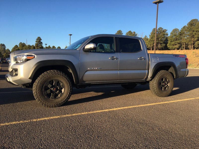

    It has hit it's fair share of dirt roads but nothing major yet.

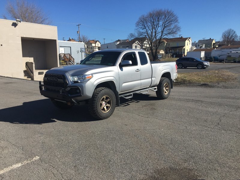

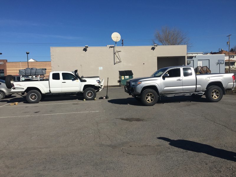

    How do you have no rubbing.......Impossible...... I'm running OME 888's and rear dakar leafs and still can't clear a 255 85 16........ Absolutely no way you are not rubbing on stock suspension! @fatfurious2
  10. May 18, 2017 at 6:32 AM
    #4070
    moe2o4
    moe2o4 Well-Known Member
    Feb 9, 2015
    #148236
    7,849
    Corey
    Pittsburgh PA
    2016 SR Silver 2.7L 5 Speed
    OME 3" Lift, 32" Tires, Lots of Mods!
    Hope you plan on driving straight all the time and not going any turns or flexing the suspension at all. Cause I test fitting @fatfurious2 255 85 16's on his truck on mine with a lift and In order to fit them properly you need a cab mount chop and lots of plastic trimming!

    Yea I agree with @moe2o4. Unless you never go off road/flex.
    Maybe you have a spacer lift and you dont even know!
    Although i dont have a CMC done

    The biggest difference between @fatfurious2 and mine that I see at a glance is that the 3rd gen sits an inch higher from the factory and he has 16x8 wheels with a zero offset so it pushes his tire out farther causing it to rub when turning. But I do agree that it will probably rub with any large amount of flexing but I also don't plan on doing any serious off-roading. My goal for the truck is camping and hunting so I like the extra ground clearance.
