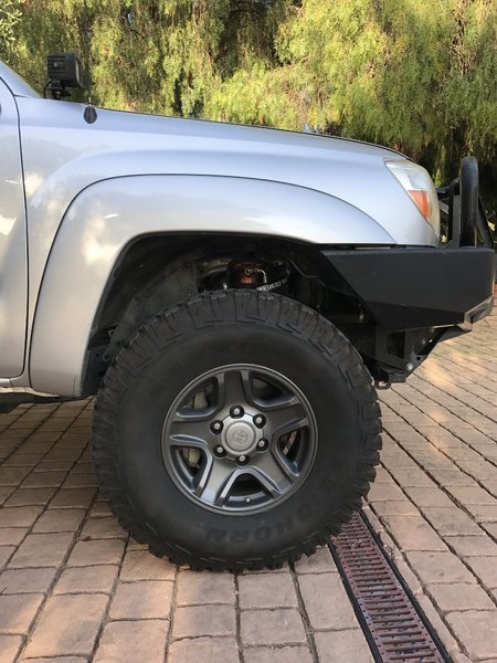

    I think I posted when I got the tires but I never updated when I put the new wheels on. Bought these shortly after I put the Maxxis Bighorns on and PCed them gunmetal grey. Had the center caps color matched but they lightened up a little when they cured but it's kinda growing on me. The wheels are 4Runner limited wheels and they fit perfect. No additional trimming required for me from the original fender trimming when I first put the 255's on

    I like the gunmetal. I went with the older T4R limited wheels PCd black. Painted the center caps and left the centers alone.

    Those look awesome. Any chance that you have a shot down the side so I can see how the stick out?? You running any spacers?

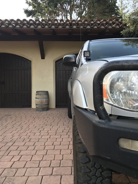

    Hopefully this picture helps kinda hard to see with the garage door color but it's pretty even with the fenders. I'm not running any spacers on my setup either

    Great. Thank you. That's exactly how I want mine to fit. Running 285s now on 16x8 with 4.5" BS. They stick out a little and it looks good, but my truck is getting beat up by rocks and shit thrown by the tires. 255s and wheels like that will somewhat fix it without being totally tucked under.

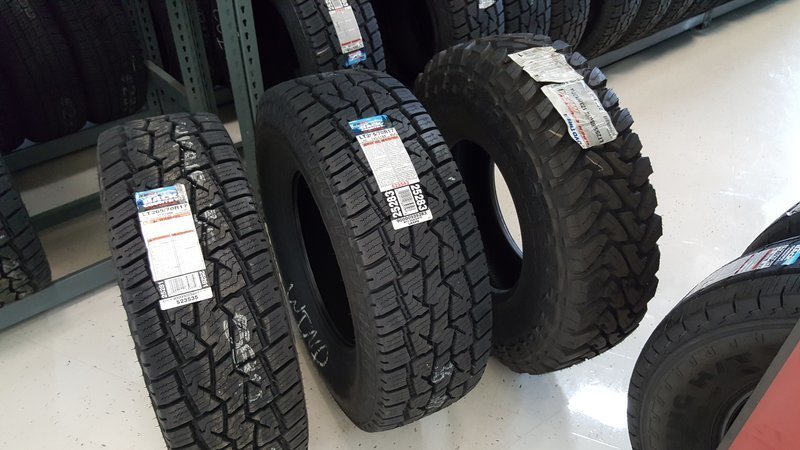

    Buying new tires in July, and I have been looking at how tall different 255s are. I was leaning towards the ST Maxx, but discovered that there is no height difference between the Cooper 285/70/17 and 255/80/17, they are identical. I know the Toyo mud terrains are taller than most 255 series.
    is there a 255 AT tire out there that is taller as well?
    I am adding the 29dxl add a leaf to my Dakar pack so I will be close to 3" lift front and rear. Looking to fill out the wheel well with a tall tire.
    Pic of 265, 285 in at, 255 toyo mt

    My 255/80R17 Cooper STMaxxs measured in at 32.5" (give or take) brand new and unloaded, basically measured as soon as they got off the UPS truck. I feel like the filled the wheel wells great. Didn't affect MPG at all, still get 19mpg daily driving over 20+ on the highway. I didn't want to deal with 285s due to trying to fit them in the front and also I knew it would hit the MPG from what others have said.

    Yes despite toyo website nor anyone else selling toyos not listing the actual height their whole product line does run on the tall side, which is what I am looking for. Anyone know of another AT 255 that is taller than 33"? As for the KO2 34s would be very interested but yikes the price! over 300$/per
