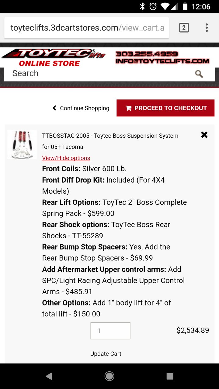

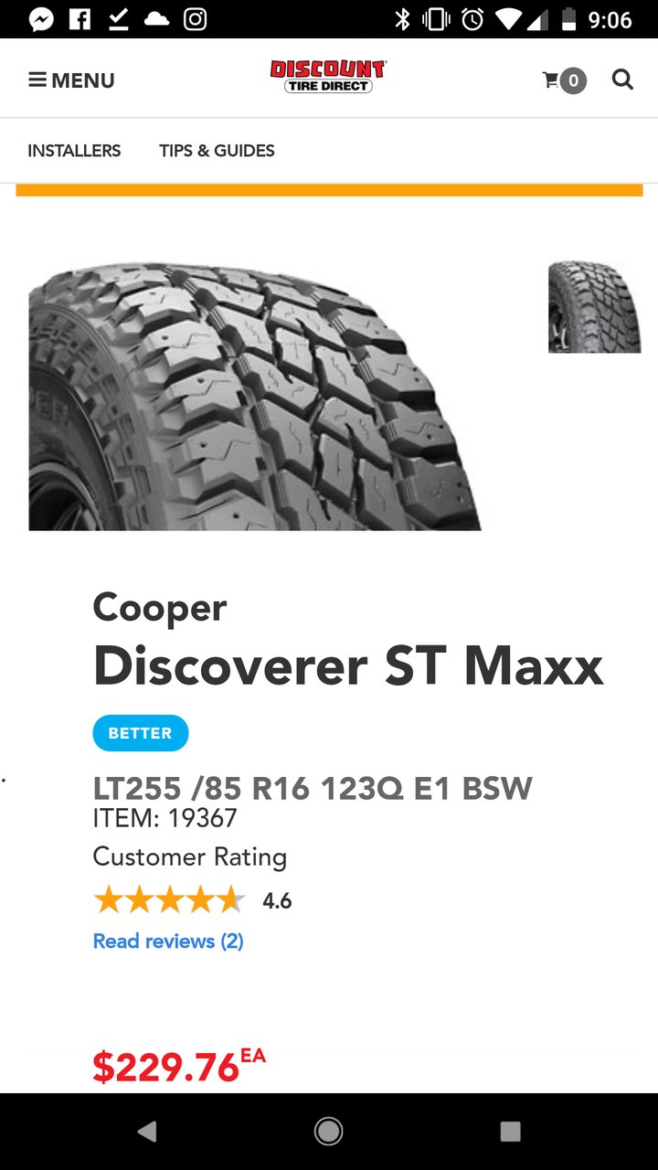

    I hate to be "that guy," bc I'm sure the answer has already been posted but here it goes....I read the first 50+ pages if this thread then realized how many pages it was. I need to order the tires ASAP to get them in w the lift which is getting installed on the 18-19 Jan!!!
    Ordered the 3" Toy Tech Boss with full rear springs (not add a leaf), Light Racing UCA's, and rear bump stops for my now stock 2005 TRD Offroad ext cab 4x4. (Decided NOT to add the 1" body Lift as originally planned to get full 4 ")
    I was originally looking for the biggest tire I can fit under it on the STOCK 16" TRD Offroad alloy rims without trimming and have no rubbing at full lock going back and forth between 285 and 255. Running 265/70/R16 on it all stock now.
    I'm thinking 285 will rub for sure and 255 will be ok from what I'm reading and am pretty much sold on the 255.
    If the 255 will be good what tire is anyone running? I wanted the BFG's but I'm being told they only make them in mud terrain in that size and not all terrain. This is my daily driver so I want to stick with an AT. Looking at going with the Cooper Discoverer ST Maxx.
    Any "PROOF SOURCE" that can tell me if this set up will work without rubbing or needing to trim and info/recommendations on the tires?Screenshot_20180111-210622.jpg Screenshot_20180103-000620.jpg

    +1 for ST Maxx

    There's no guarantee they won't rub. Only tire guranteed not to run is stock size on stock wheels. You'll probably have to do some trimming if you plan to cycle through the full range of suspension travel.
    It is dependent on many factors, lift having nothing to do with whether or not they'll rub. Alignment geometry and wheel backspacing being the 2 Biggie's.

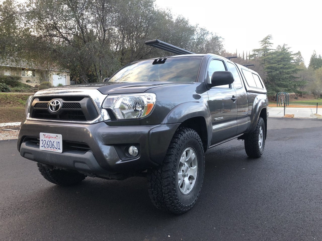

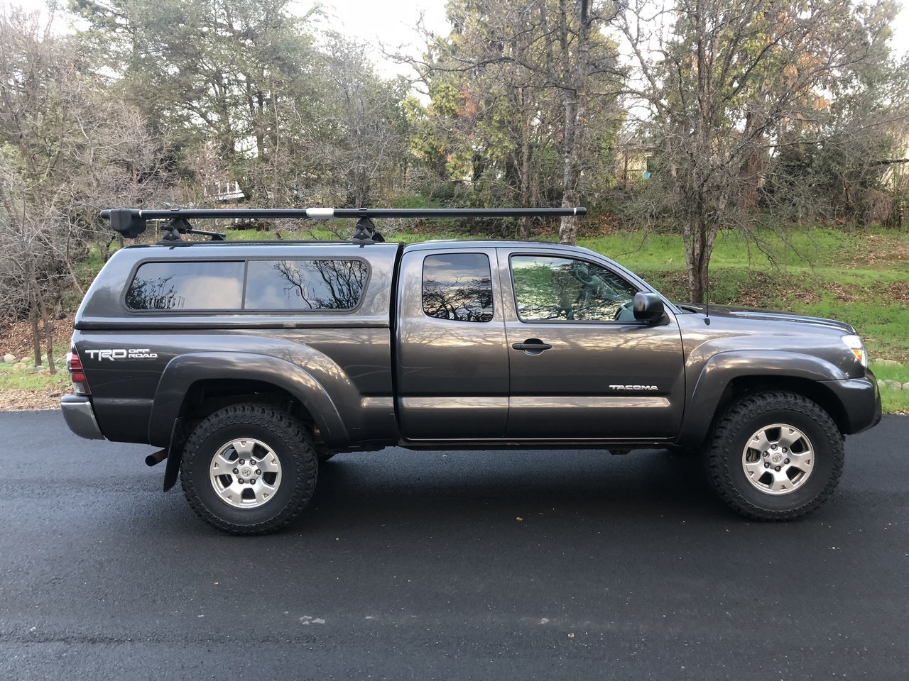

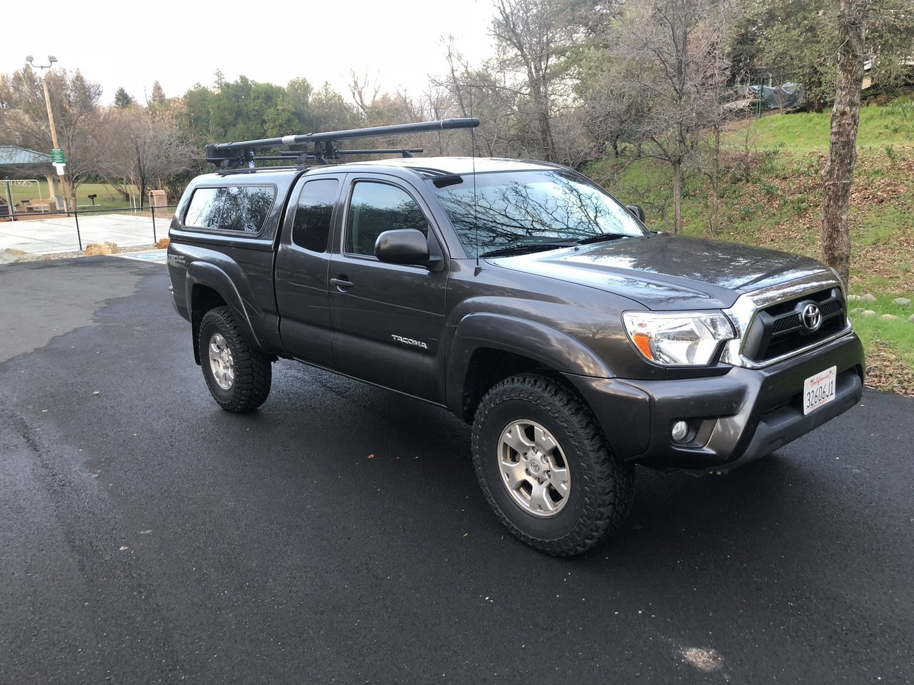

    I just got a set of 255s Cooper ST Maxx and a OME kit (2885 w/ no spacers, nitro chargers all around, and standard dakar pack). I really like the tires. The tread pattern is awesome, they are burly but quiet, and they look angry. They don't rub at full lock in forward gear, but I was able to get them to rub a bit at full lock in reverse (one side only). Like everyone else, I wish I would have sprung for new UCAs, but they aren't necessary.
    I'm not sure why people obsess about re-gearing for these tires. I could tell a slight difference, but it wasn't a big deal. It's not like these trucks are torquey to begin with. I also like how the truck brakes now (worse). I have the TRD OR, which I think has a larger brake cylinder. The brakes were always very grabby, like a wet drum brake on a gold cart or something. Now, they feel a bit more normal. If your brakes are squishy before installing these tires, you might need to address that.
    I added crappy quick pics below. As you can see, the rear is a little high. I intended for the rear to be higher because I carry some constant weight, tow frequently, and can't stand when the back starts looking low. I was surprised about how little I got from the 2885s and how much I got from the dakars. Overall, I think it looks fine and will be perfect for my taste if the rear settles just a bit (it's only been a couple days). I'll check back in with any developments.
