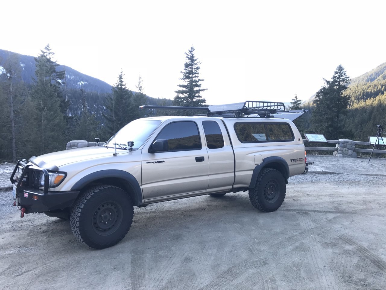

    Literally in the same boat right now, except I have a OME 3"lift on the way, with LR SPC UCA's. I have been looking at the same wheels, but currently have steelies on mine. Here is how my truck sits as of a few days ago. IMG_5980.jpg
