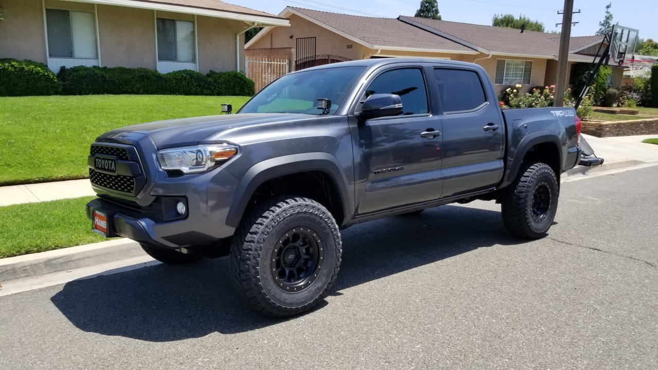

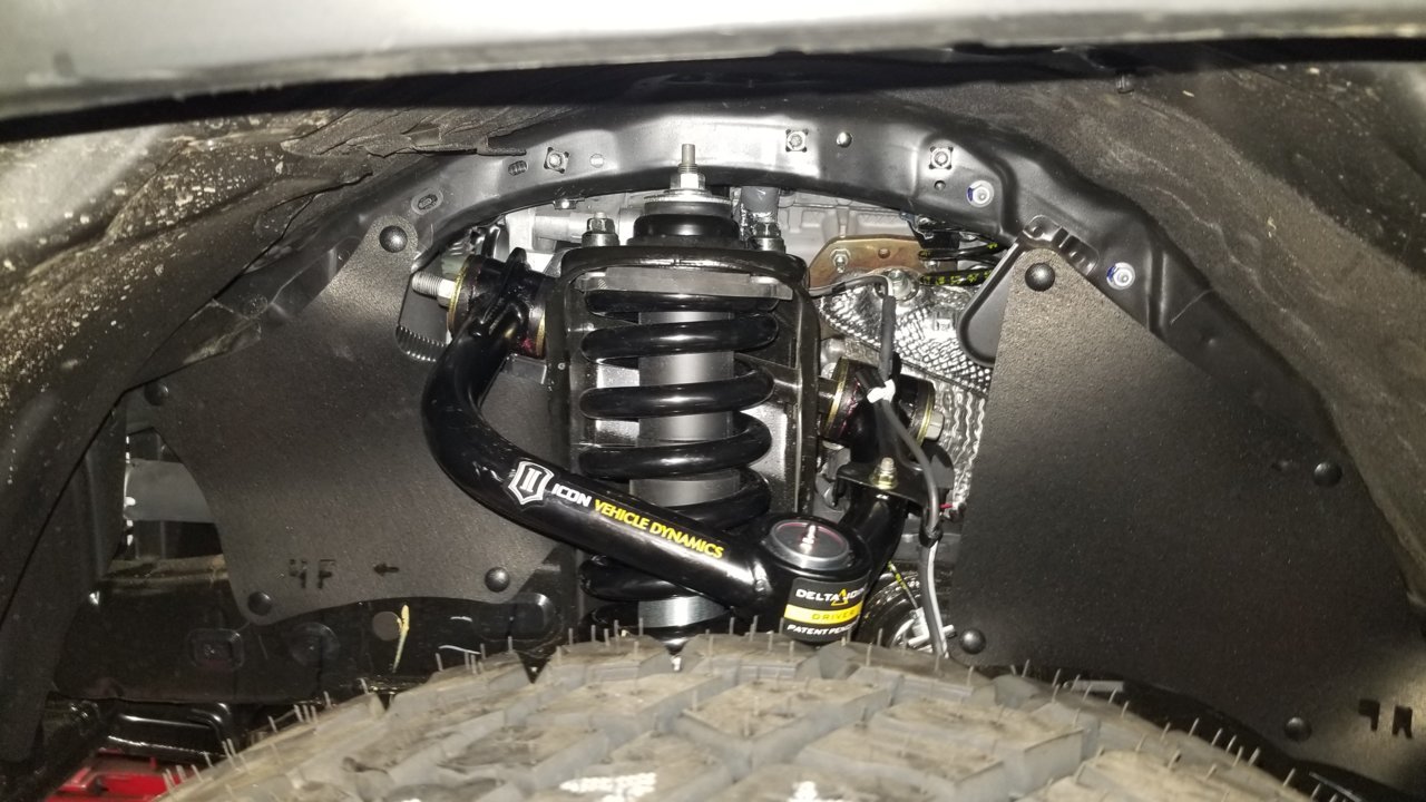

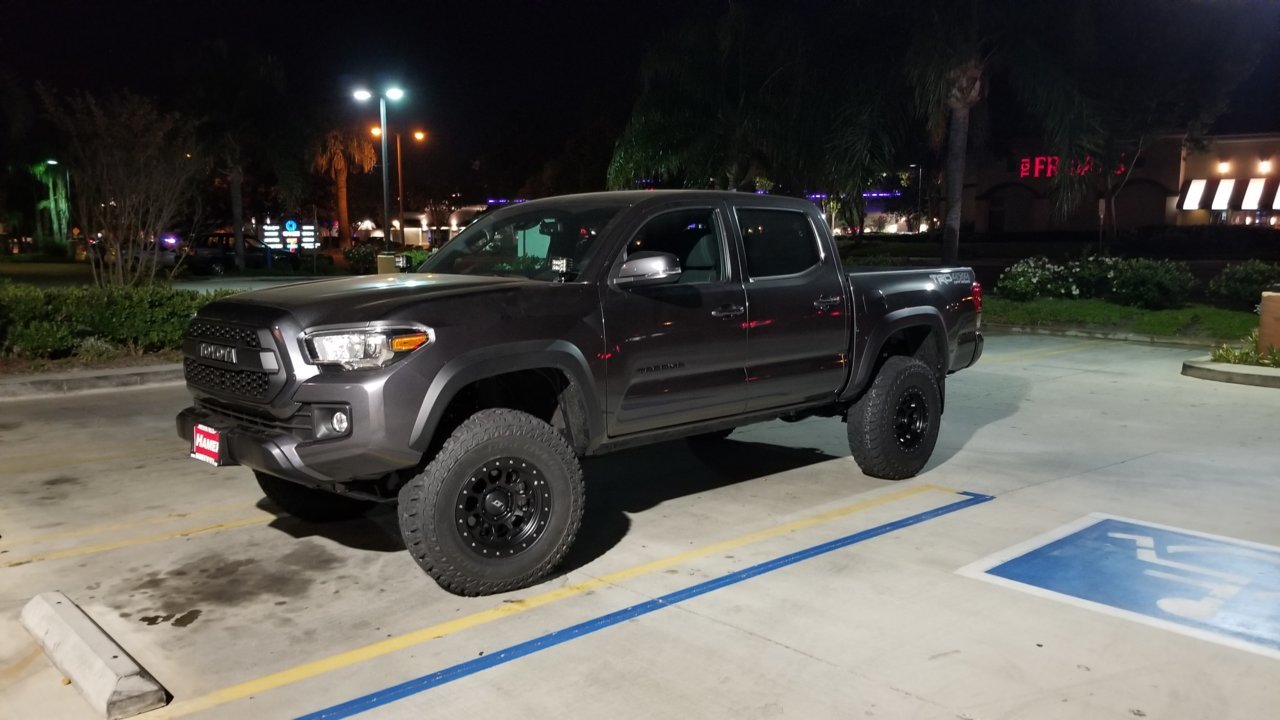

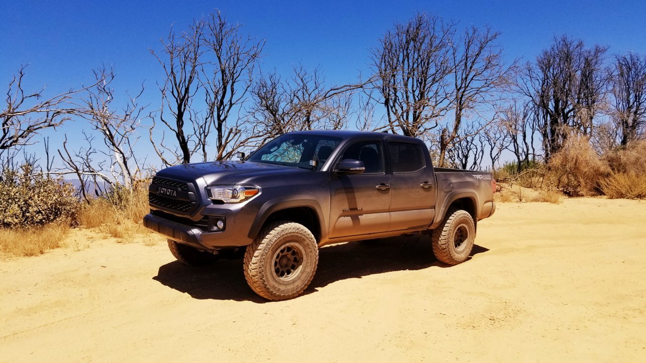

  13. Jul 29, 2018 at 3:52 PM
    #4533
    Vengar613
    Vengar613 Well-Known Member
    Apr 4, 2014
    #126958
    79
    Simi Valley, CA
    2018 MGM 4x4 TRD Off Road
    Will do a more comprehensive build thread later.
    20180729_133306.jpg 20180729_133306.jpg 20180728_223413.jpg 20180728_180825.jpg
    -OME 888 Coils
    -Dakar Leaf Replace (medium)
    -Icon Tubular Control Arms (Delta Joint)
    -Bilstein 5100 Front and Rear (0 Setting for front)
    -SCS Ray 10 (16in)
    -Cooper ST MAXX 255/85/16
    -Cali Raised Led Ditch Lights & OEM Switch
    MynameisMUD, KnoxTac0713 and Vertaco like this.

    I have read and searched all pages and cant get a good answer. I have a stock 18 OR with 1.25 spacers. Can I run 255/85/16 on stock tires with that spacer without much rub? I like the tire but I also want a little wider stance. No lift right now. Can anyone help me out before I lose my mind?

    Took it out finally. Rubbed 3 times since install. Twice pulling into a gas station and once making a simple right turn while on a trail. Have no idea how much I should be concerned about it.
