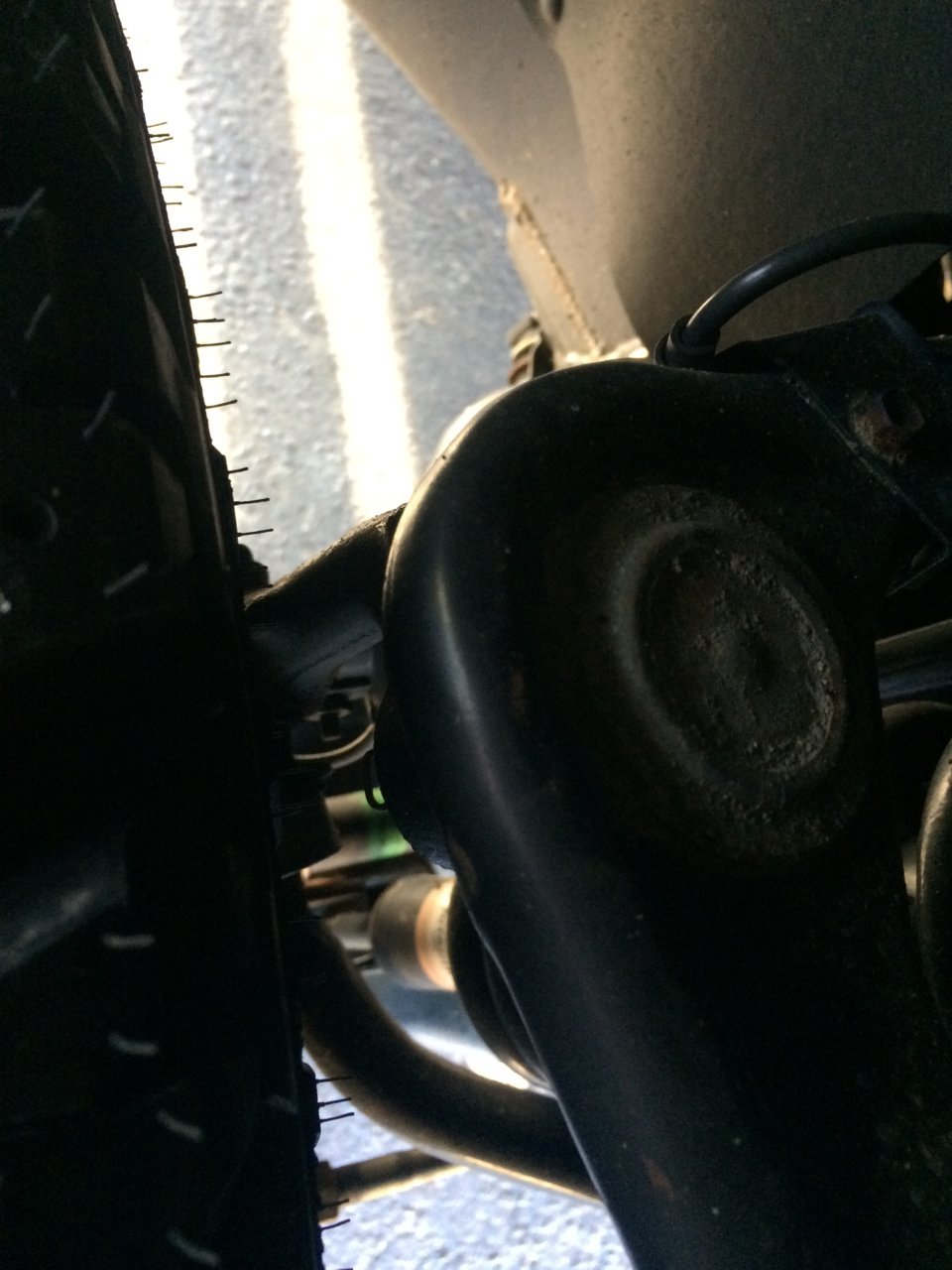

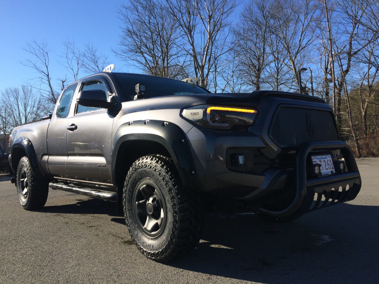

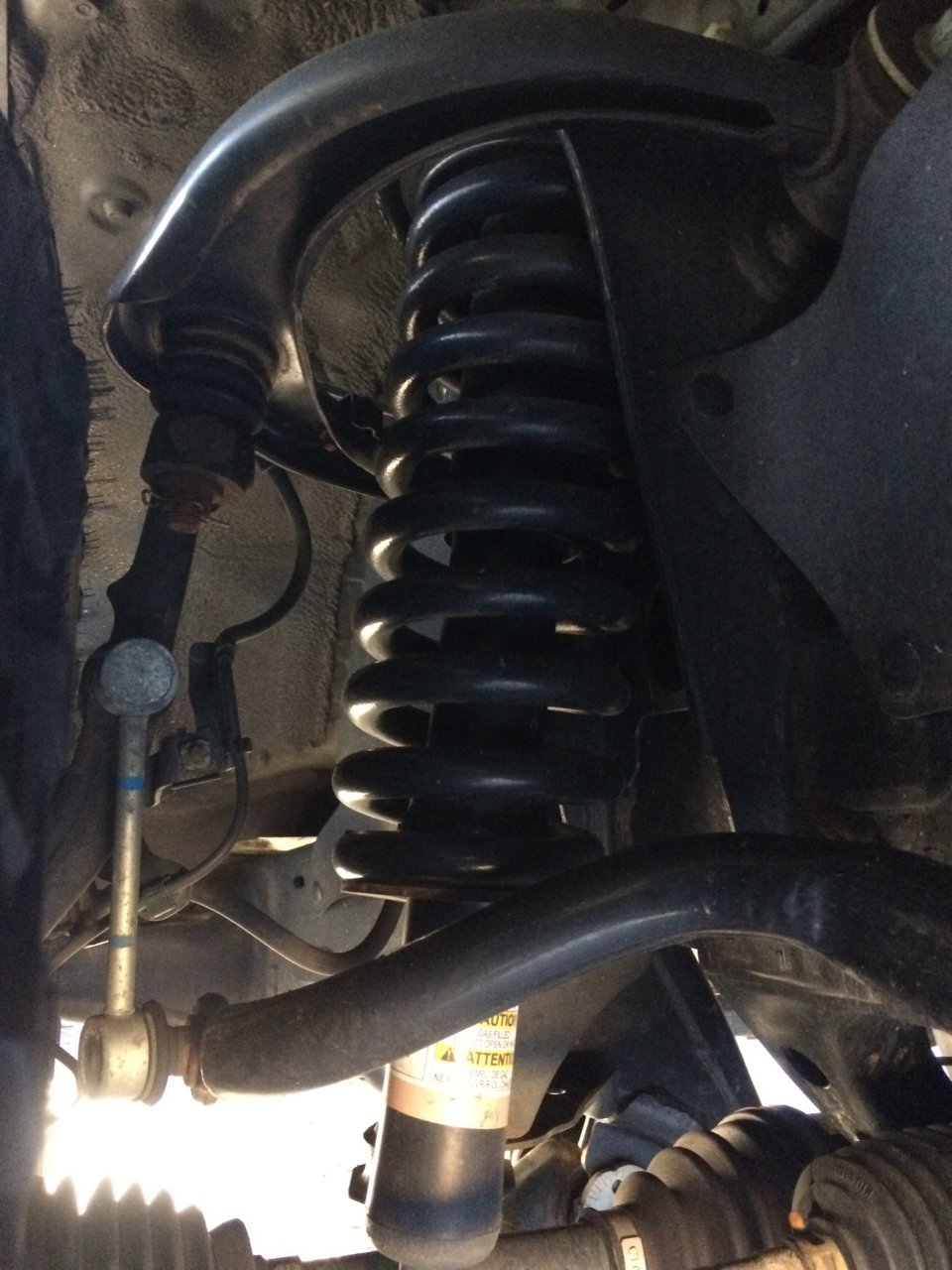

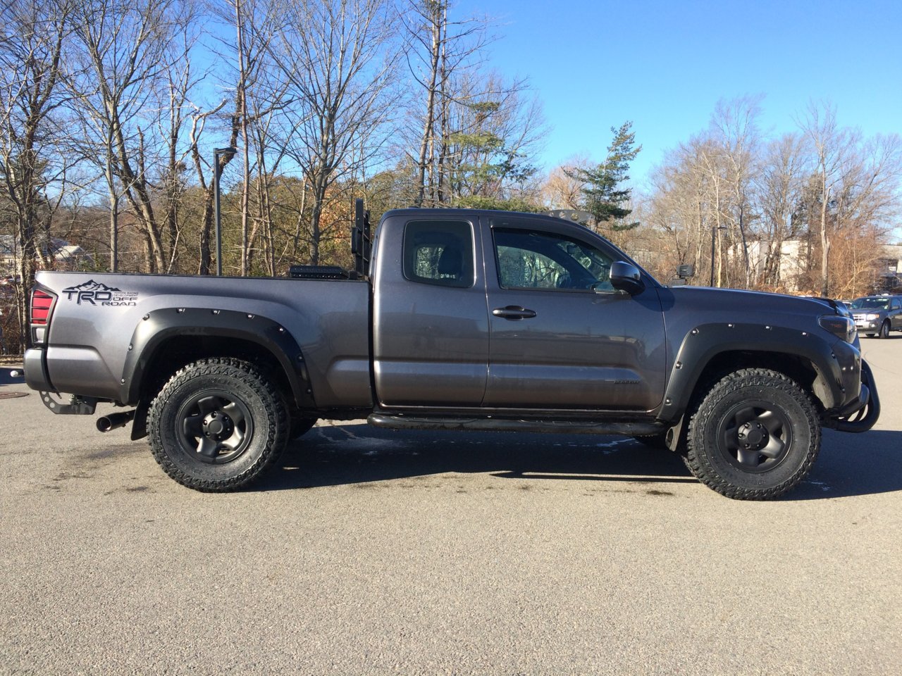

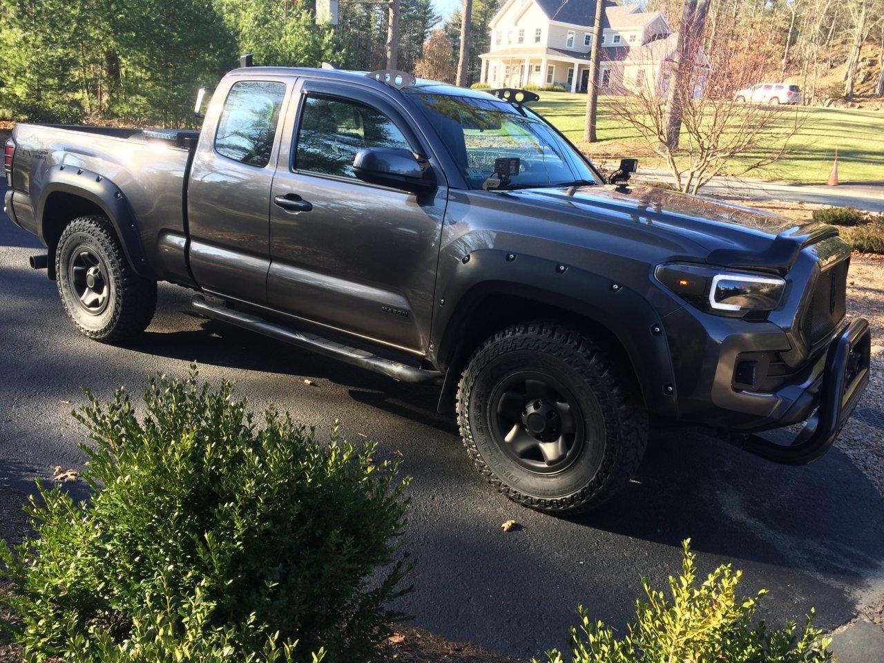

    I fit 33s on stock suspension, with stock steel wheels. Cooper ST Max 255/85/16. I had seen stock OR/Sport/SR5/Pro wheels with 33s, but I had never seen these steel wheels so I took a gamble and it worked out (Couldn't find the offset on these particular wheels, so I didn't know if they would work but they did). Power loss is hardly noticeable, but braking takes more effort. My stock SR highway tires were humming, and these are actually quieter. No rubbing at full crank or full stuff, drove these puppies for 60 miles today. 2016 SR ACLB. I can't believe it fits, I'm losing it over here.

    I exactly have the same truck as you. I recently buy 4 new bilstein shock and rear leaf to raise the truck 2 inches back and front. I look for 255/80/16. Are you sure that is absolutely no rub even if there are bump on the road? Why do you remove your Light Bar

    My truck is not lifted, and geometry changes when you lift. I'm on stock suspension with zero rubbing at full chunk or crank, but if you lift it you might have to do a cmc or wheel well configuring. I took my light bar off because I'm about to repaint my brackets
