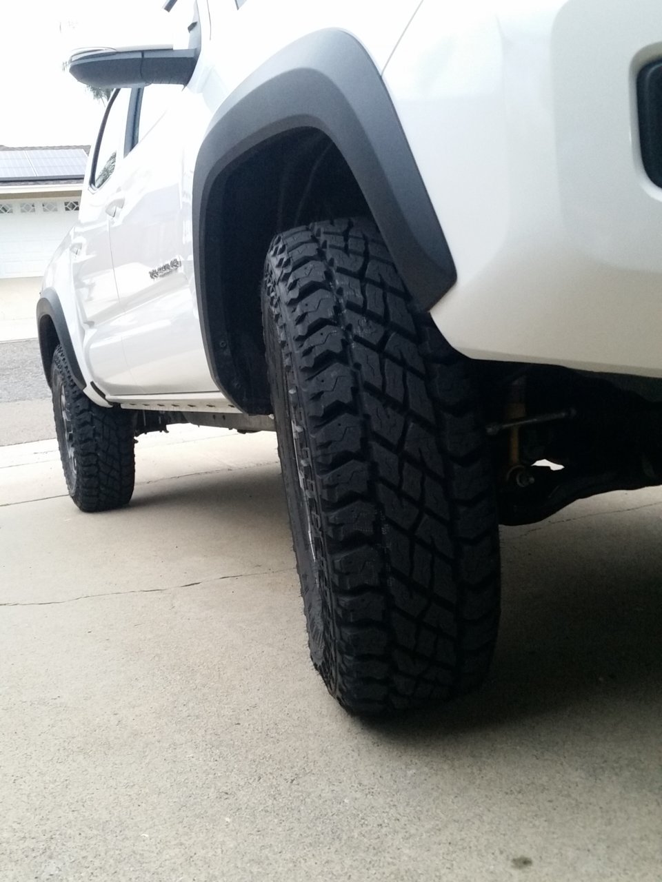

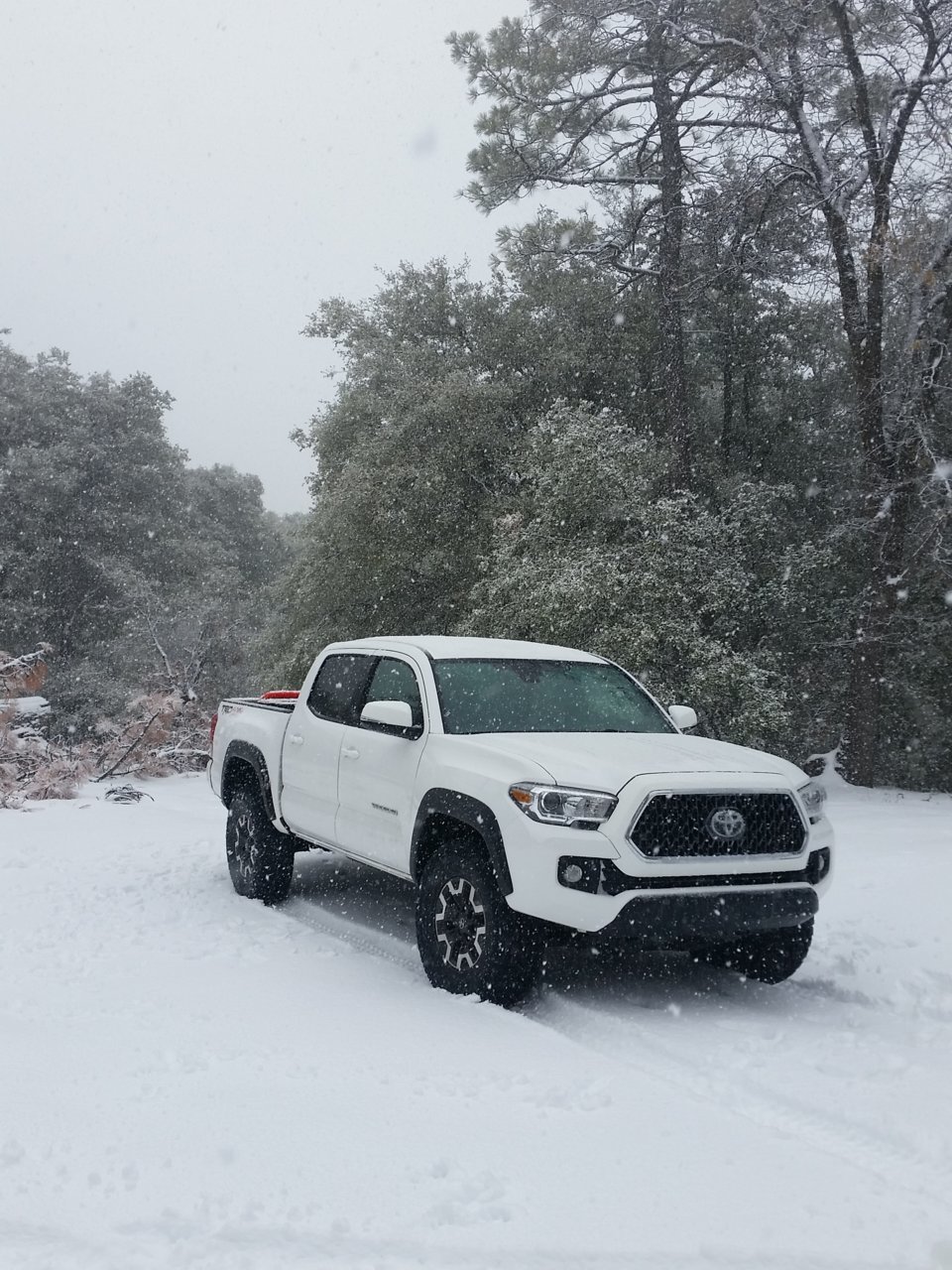

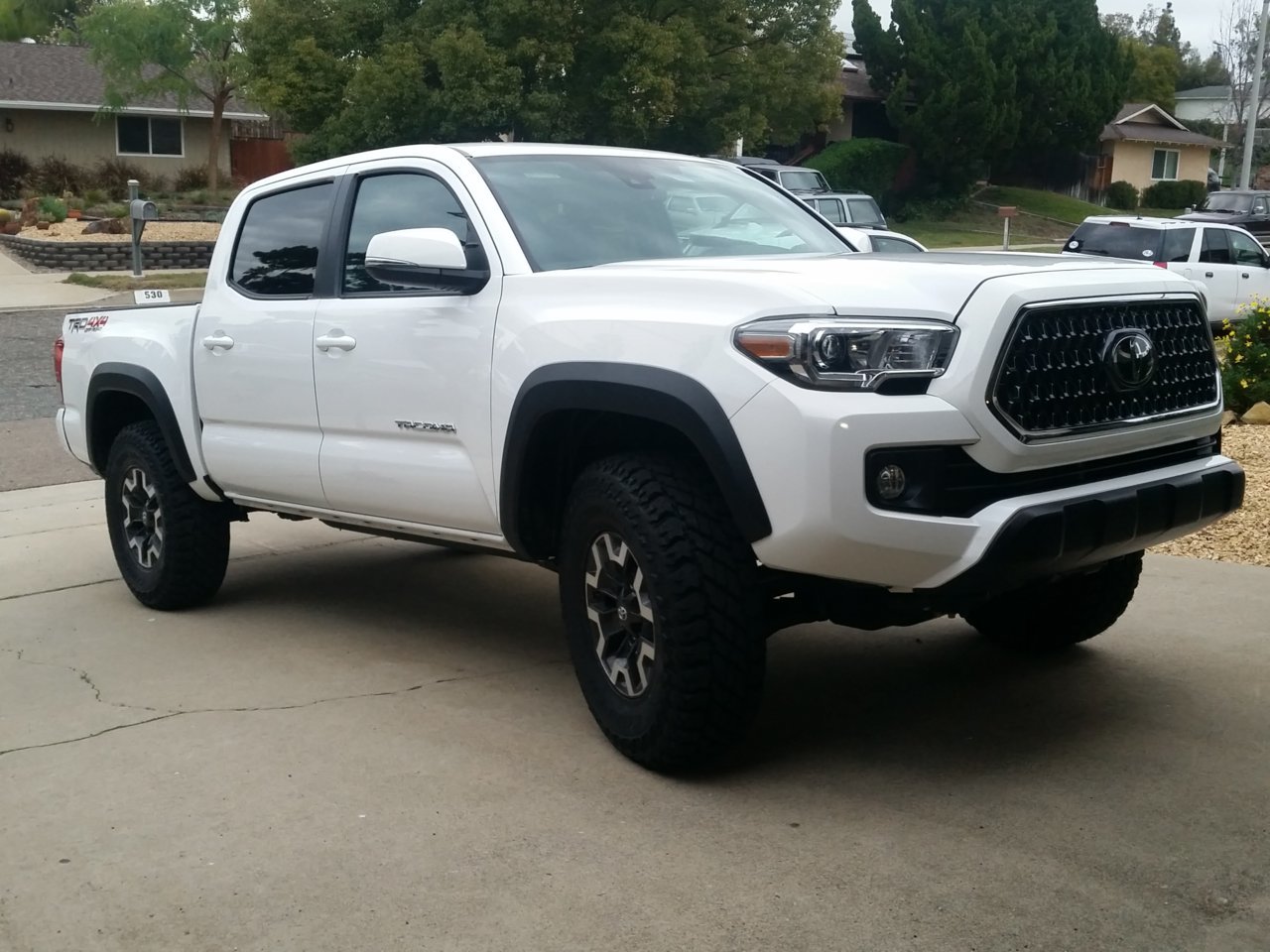

    20190201_170321.jpg IMG957606.jpg cooper st maxx all day long. ..no rubbing ..all stock 2019 4x4or20190209_112948.jpg

    Took a chance on Coopers aND I'm sold.. bfgs never again ! Tall skinny is $$$

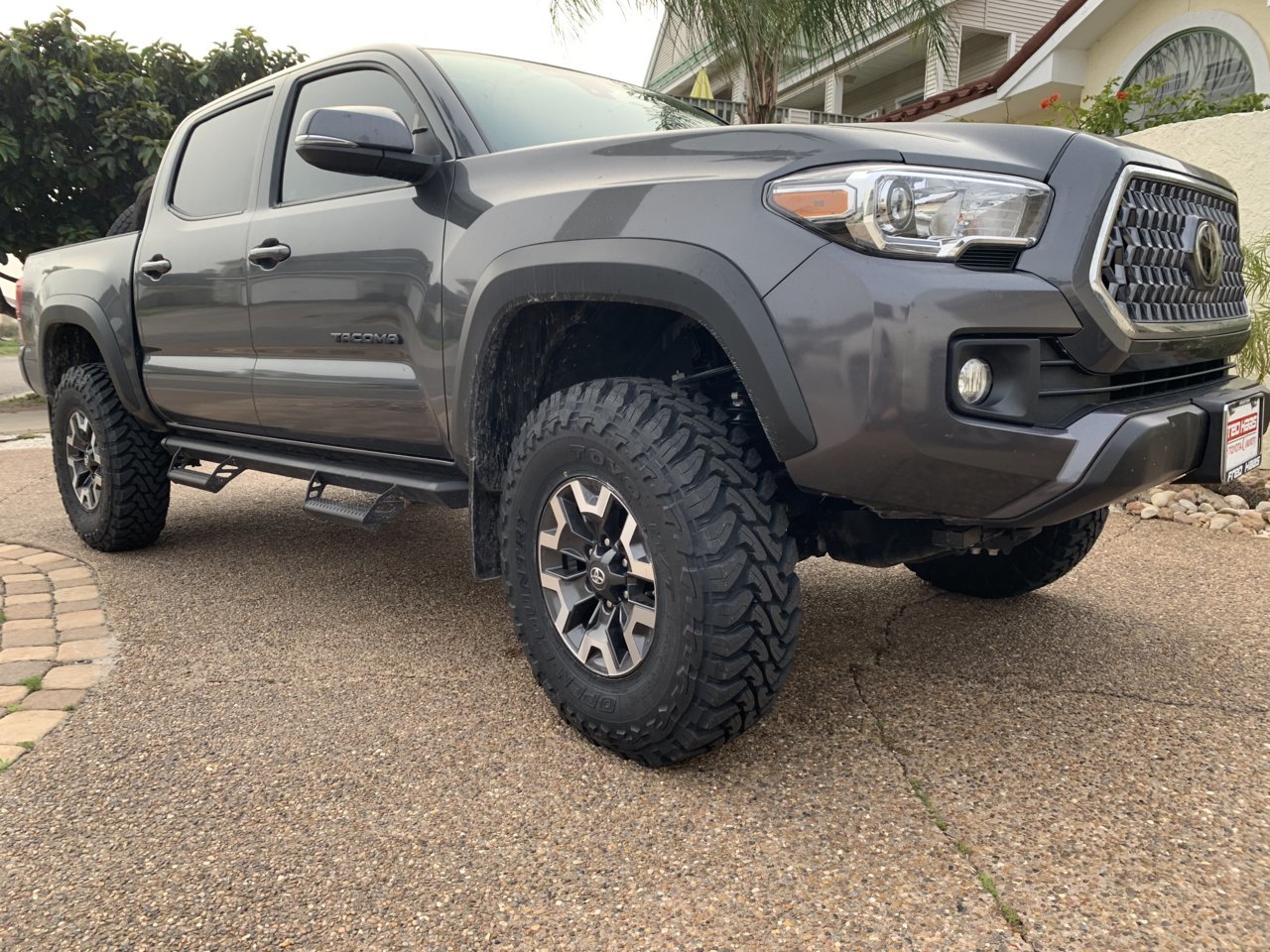

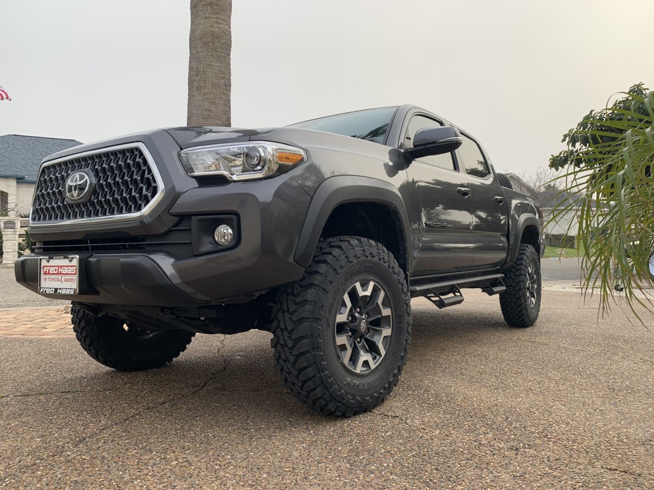

    OME 888 3/2” lift, 1/4” driver side spacer for taco lean, with Dakar 2” med leaf packs, extended rear break lines, Bilstein 5100’s, spc lr UCA’s 255/85r16’s Toyo MT’s and 1.25 spydertrax wheel spacers
    2D5F2EAA-3077-417F-8D81-DE08A5569A99.jpg 3C360C01-F6CF-4308-AC16-77128233E0CA.jpg
    Toyo MT 255/85r16

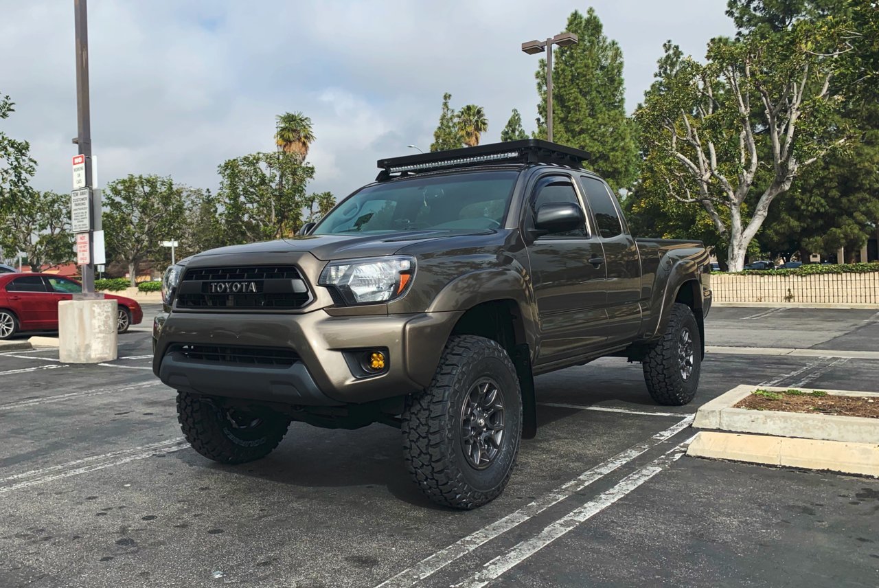

    Just bought a set of 255/85r16 Mastercraft Courser CSX from Amazon. Long story short....I called and asked when would they be shipped out because it was taking longer than expected so they refunded me 75% of the cost....so grand total of $186 for 4 tires!
    Great tire overall. Very little road noise, they are on the heavier side I believe they weigh out at 53lbs. Discount tire did the balancing on a road force machine. They did mention the tires did take a lot of weight to balance out too. But overall very happy.

    Hey, thanks! I have no rubbing at all even at full lock and flex (Its close, but non). I wanted to share my experience because there is very little info and not many people running them I noticed on this forum..... I also wanted to keep the stock mudflaps...I was adamant about that. I'm running a ICON 2.5" lift, ICON UCS's, ICON 1.5" rear AAL with overload spring. I really wanted the Cooper ST Maxx's first but for the price of the CXT's you can't beat them. Plus Cooper tires makes Mastercraft.
    These are also factory wheels, so I'm not quite sure on back spacing...but any aftermarket wheel should be fine if these OEM work..

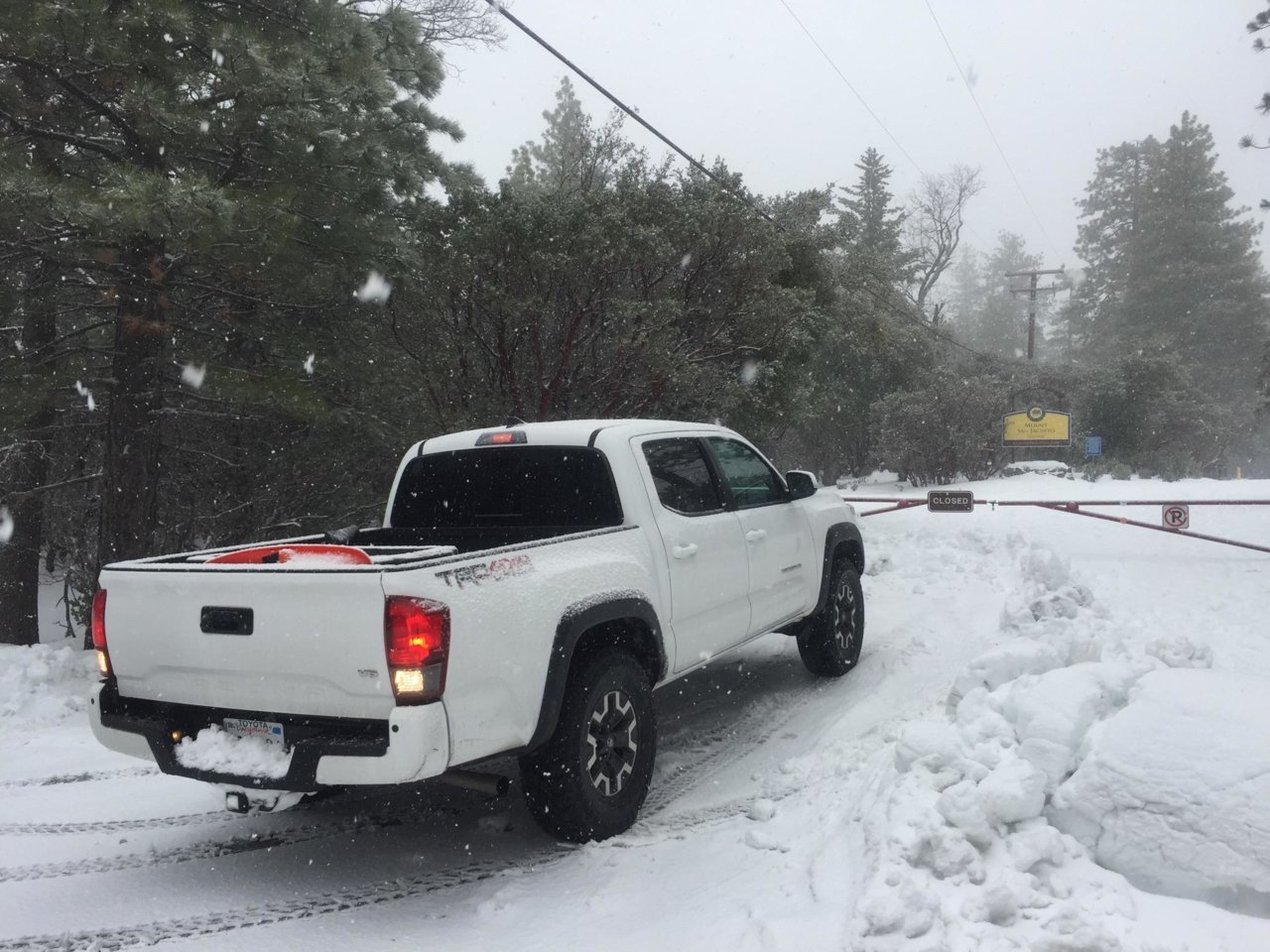

    Bammm... done .. they fit! Go wheelin! 20190201_170321.jpg 20190201_170345.jpg
