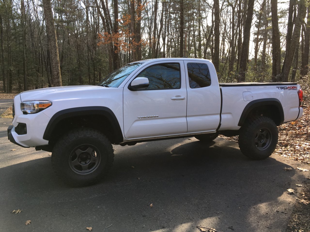

    Just a quick update since I put on the 255/85 BFG KM2's. Taco OME HD.jpg OME 866's, HD Dakar rear leafs, SPC UCA's and HS off road 3 degree shims installed. Alignment all in the green, drives smooth as butta and no more rubbing. Very happy with this.

    Looks great! I just ordered a set of KM3s in 255/85. Can't wait for then to get here.

    Thanks. I'm really surprised by the overall quality of the ride, thought it would be stiff especially with the truck unloaded, but I think its fine. Went with HD Dakars in the rear because I've got a Vagabond Drifter wedge camper shell on order. Tires at 33F/34R PSI.

    :jellydance: you need to post pics of that vagabond when you pick it up!
    I have been running KM2s in this size for 3 years. I balanced them before I mounted them every season. I loved them. I do recommend that you balance them regularly.
