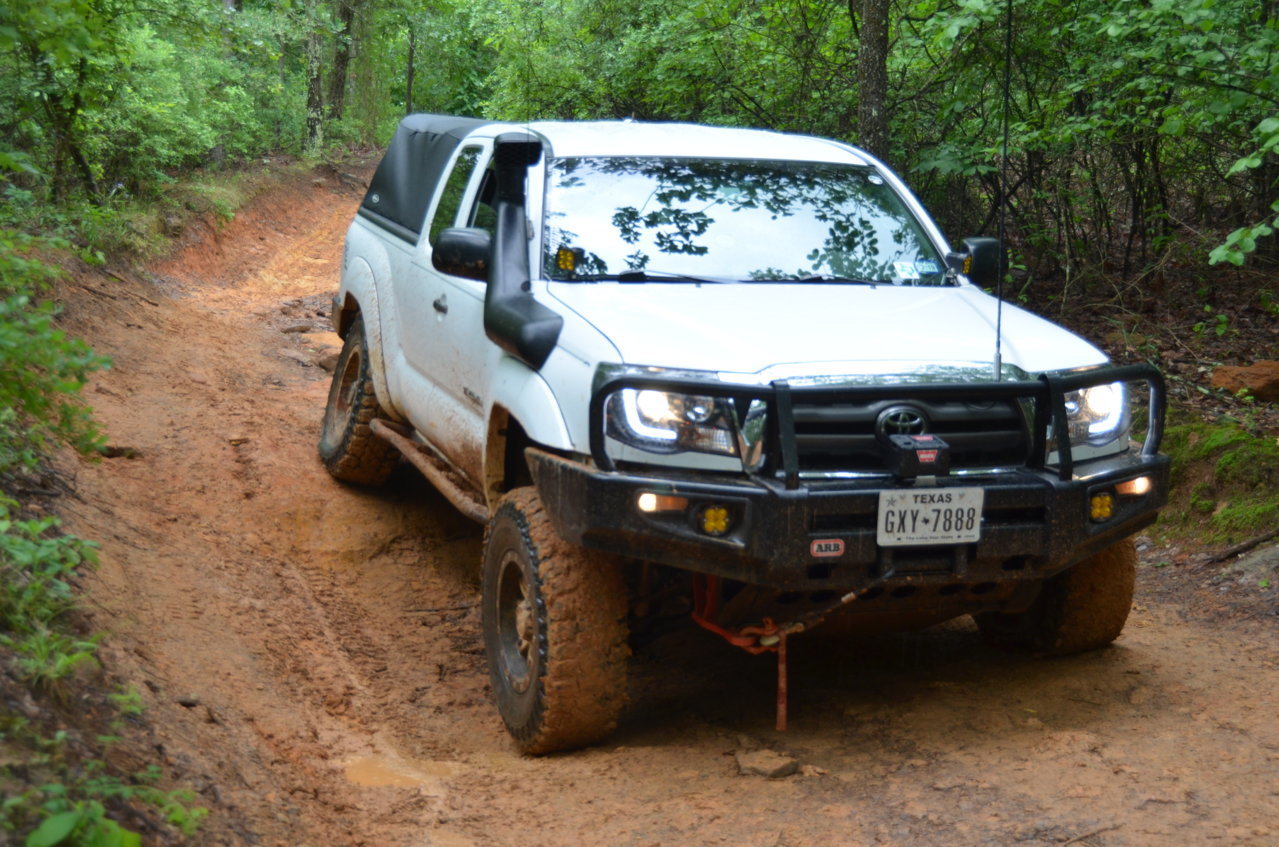

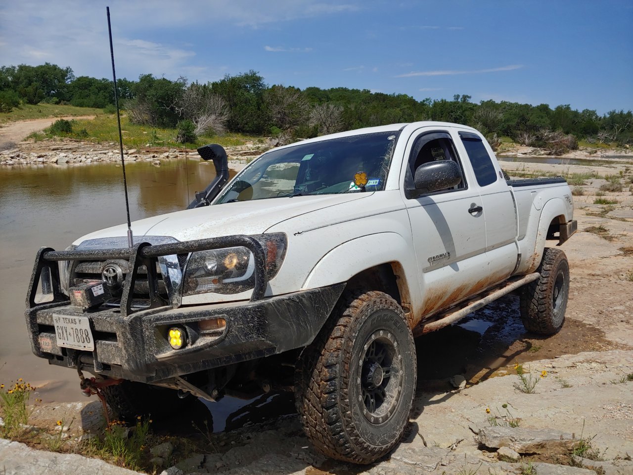

    Been running mine on trails, off-road parks, mud and DD. They've been fantastic. So far 19k miles on these 255/85r16 Cooper ST-MAXX

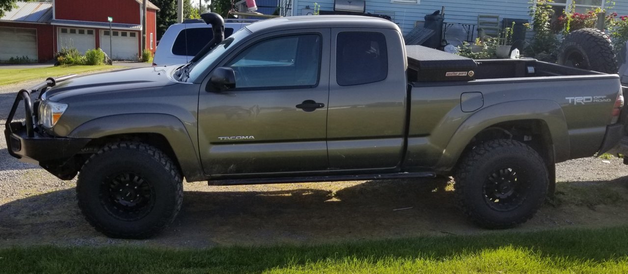

    I ran these on my 2nd gen: https://www.procompusa.com/wheels-p...1551-1557-2339&pqa=13676-8275-8057-8268-13829
    I had a tiny bit of rub at full stuff but I was running an ARB bumper and it would have gone away with a half inch more lift. The rub was very rarely on the cab mount, but mostly on the pinch weld.
