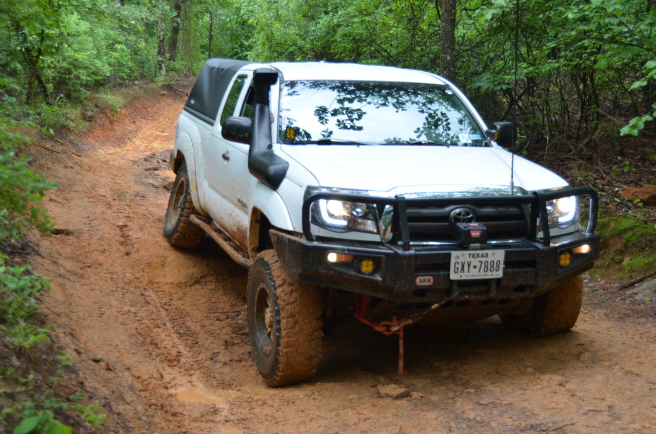

    Josh
    Temple, TX
    6-speed death mobile
  8. May 31, 2019 at 6:07 PM
    #4708
    rngr
    rngr Aix sponsa
    Jan 13, 2015
    #146258
    9,244
    01 SR5 4x4 2.7L
    I run that at 12 lbs. and have never lost a bead.
