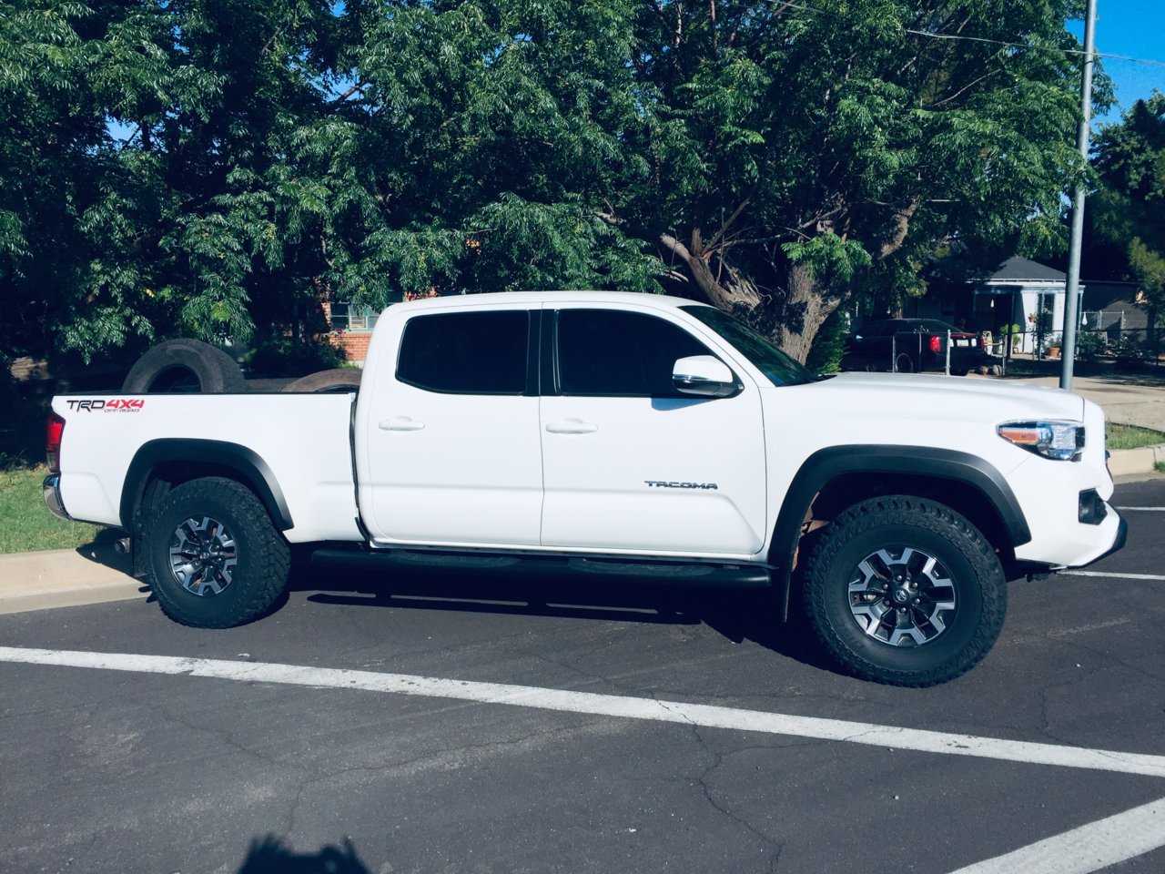

    Bed mat Console organizer Softopper Cooper ST Maxx in 255/85/16
    Cooper ST Maxx in 255/85/r16, no mods, no rubbing.

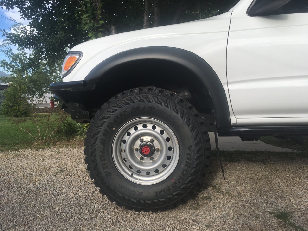

    I'm in the club now. I wore out a set of 235/85r16 Cooper ST Maxx's and just got Yokohama Geolandar M/T's newly minted in 255/85r16.

  14. Jul 27, 2019 at 1:11 PM

    Looking good! What have you done to the suspension to clear them? Rubbing?

    2003 Regular Cab 4X4 5MT
    Thanks so much! I have SPC UCA’s, OME 880 coils and a Wheeler’s Off Road 3/8 spacer on the driver’s side to correct taco lean.
    I also got a custom alignment maxing out the caster on the LCA’s, which moves the front tires forward. The 255s don’t contact the wheel wells or cab anywhere but will rub the frame with the steering wheel at full lock.
    I expected that because my 235s did the same thing. But it’s no biggie because even without going full lock, regular cabs still have a tight turning circle.
