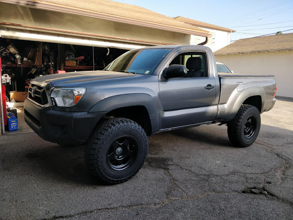

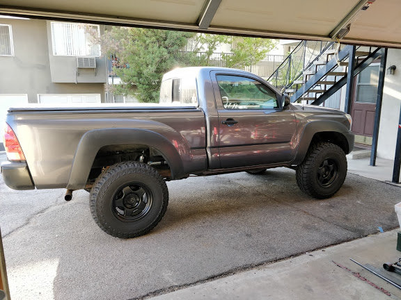

    Joining the 255 club today.
    2014 Regular cab 5MT 4WD. Not much info for RC guys so I'm going to post all the specs I was looking for before I started my lift.
    255/85r16 Cooper ST Maxx's on SCS F5 16x8 et0 wheels. Bilstein 6112 ( 3rd setting ) and 5160's on Headstrong 3 leaf AAL (retaining helper spring). 2.75" lift all around (with a factory 1.5" rake). Used OEM UCA's and was able to max out at 1.5* caster. No rubbing after I removed the fore and aft flaps.
    I also purchased a taco lean spacer and forgot to install it. Was too lazy to tear it apart again but it leveled out perfectly, even with me in the cab.
    I was also afraid that the AAL + helper spring would stiffen up the rear considerably but the Bilsteins made quick work of it. The ride is AS smooth, if not smoother, than factory. Definitely easier on my back driving through pot-holey streets.
    Will see how she does on the trail this weekend.
    If all goes well, I'm going to start building my front and rear bumpers next week. Weeeeeeeeee

    Sweet truck. I wanted the regular cab but they are as rare as hen’s teeth.
    pro tip, cut the exhaust pipe off after the last hanger. I watched my buddy crush his up into the bodywork last weekend.

    Thanks!
    Yeah when I started looking for one a few years back, all my buddies told me I'd never find a regular cab in 4WD AND 5MT. Found one one day and jumped on it. Haven't looked back since.
    I will take your advice about the exhaust pipe and chop it. I can see it getting hung up on something too. Thanks!

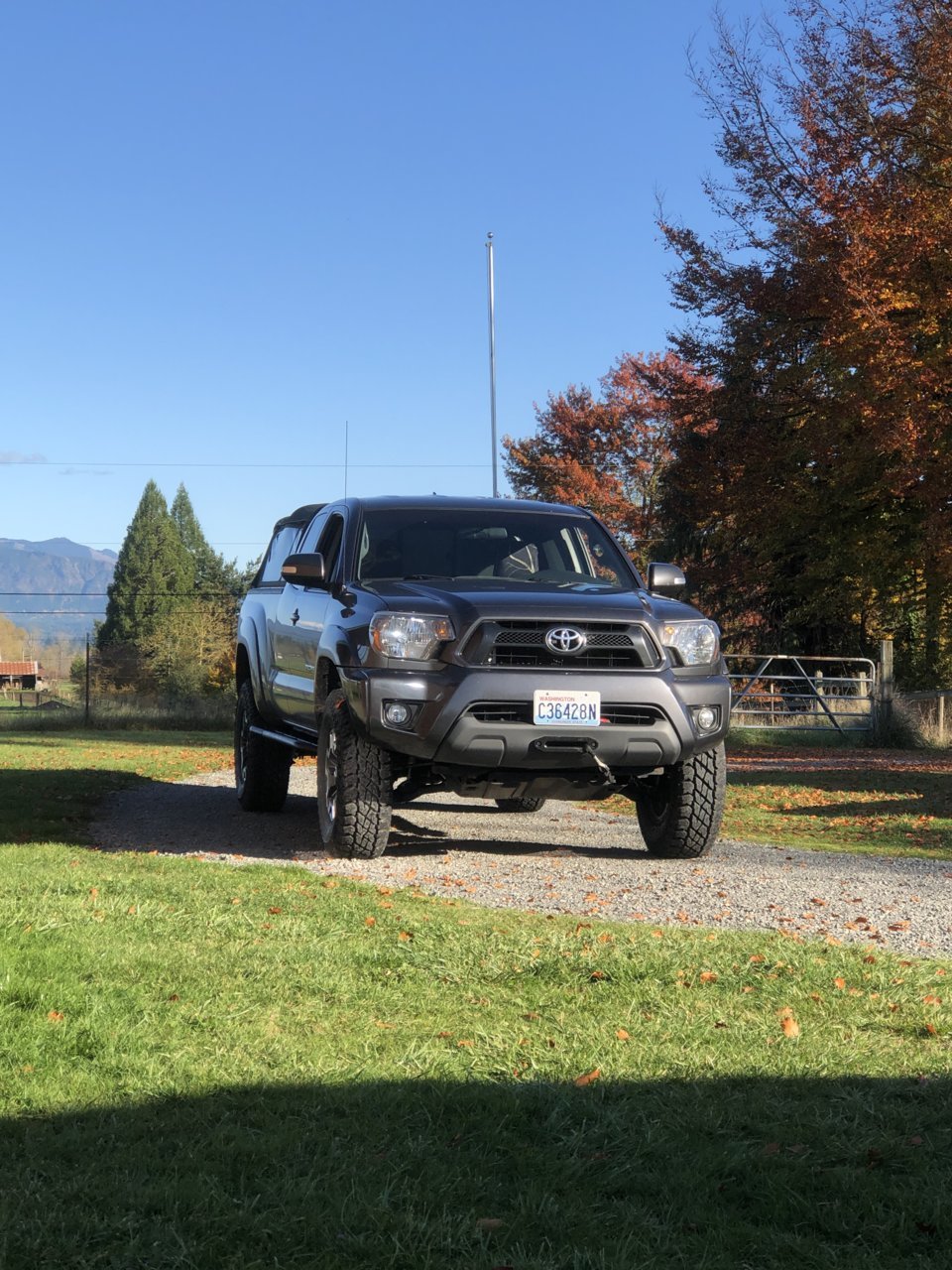

    • 2042B54F-628B-4B2E-99F1-0DCDAE809A41.jpg 7E379F31-2624-4595-AF90-5D3A101DAB0D.jpgHappy to be in the skinny 33 club! Cooper ST Maxx! they’re a little tall with the stock gears and 6 speed (specially reverse) but I’m excited to try them out in the deep snow

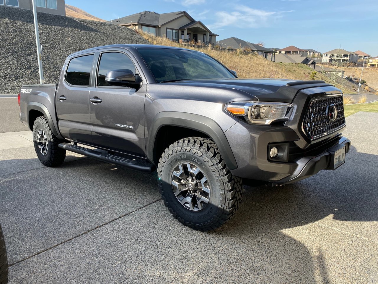

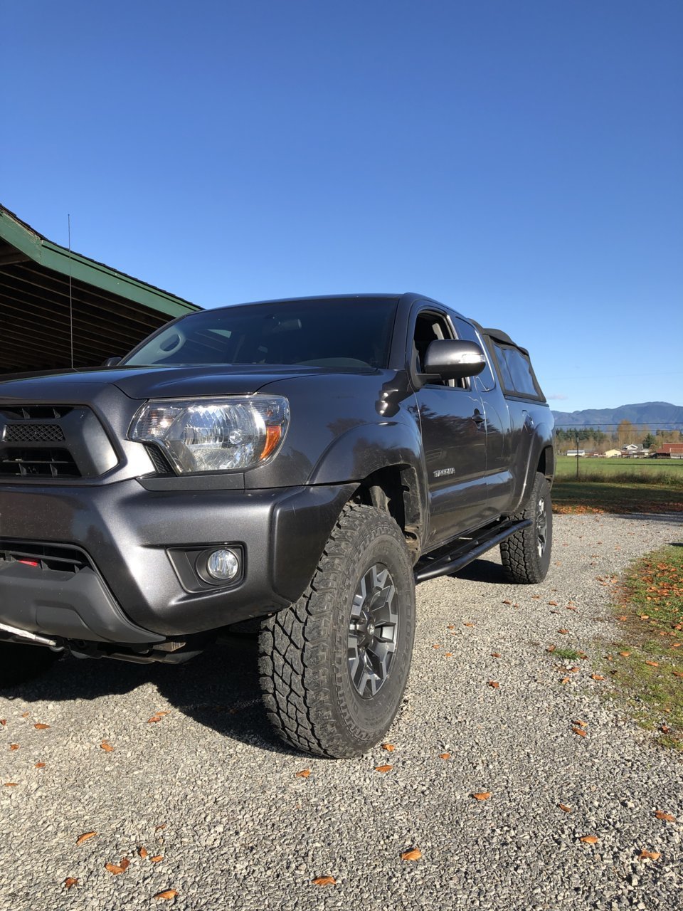

    Joined the club! Toyo Open Country MT 255 85 16B915584C-DBBC-410A-A981-D8E96D1C4CCF.jpg94529DF9-9EE3-42F5-8F95-AB03C96A29AC.jpg

    Took her out for the first day since I got the new ST Maxx's. Gotta say, they feel really good! Aired down to 15 psi with no issues. Road noise is very very minimal. The new size did lower my fuel mileage. Was getting 19-20mpg before, now I'm at a solid 17mpg.

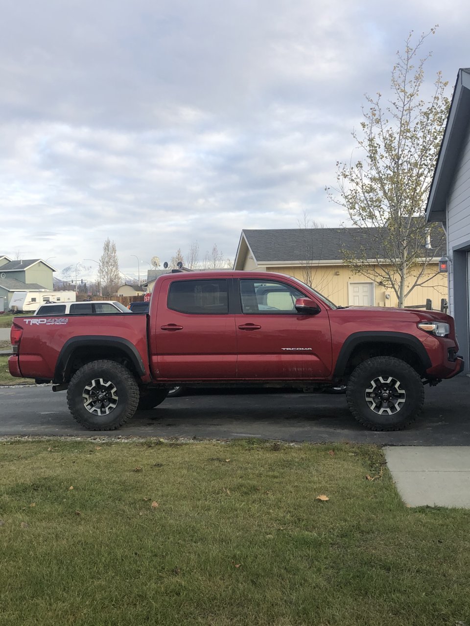

    Bilstein 5100, 2887, add a leaf in the rear. Maxxis Bighorns. Works good.

    How easy did the spare fit?
    I love these.
  17. Nov 5, 2019 at 6:49 PM
    #4777
    urbanplanner
    urbanplanner Well-Known Member
    Nov 16, 2010
    #46276
    143
    washington state
    You have to bend over two tabs before it fits. It’s snug, though, for sure.
