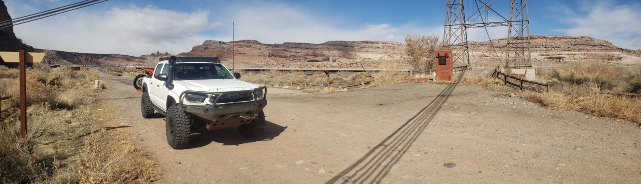

    Barcelona Red 09 DCOR- Icon 2.5" ECOs w/CDC - 14" 700lb, ICON 2.0 RR Ext rears, AP EXPO pack, Diff Wedge, Diff and Skid Drop, Discoverer S/T 255/85/16, Ride-Rite Bags w/ Daystars, ARB Bull/winch Bumper, Warn 8k, ARB CMK12, Budbuilt skids, BAMF bolt on sliders BAMF diff diaper, bedlights, hoodlights, BAMF CB, etc.
    I do.
    LCA and gas tank plate too. I have a cap with a rack and a Prinsu as well.
    The armor barely had any effect, probably a wash with the improved air flow underneath.
    The racks were a big negative, probably 2 mpg.
    Tire weight seems to be the biggest issue, more weight to spin, lower mpg.
    15 around town, 17 highway up and down hills at 65ish, can get 19 on long turnpike and interstate trips if I stay at 65.
    Whens she is naked, I have seen 20-22, but I drive like a trucker on long runs.
    Your results may vary.

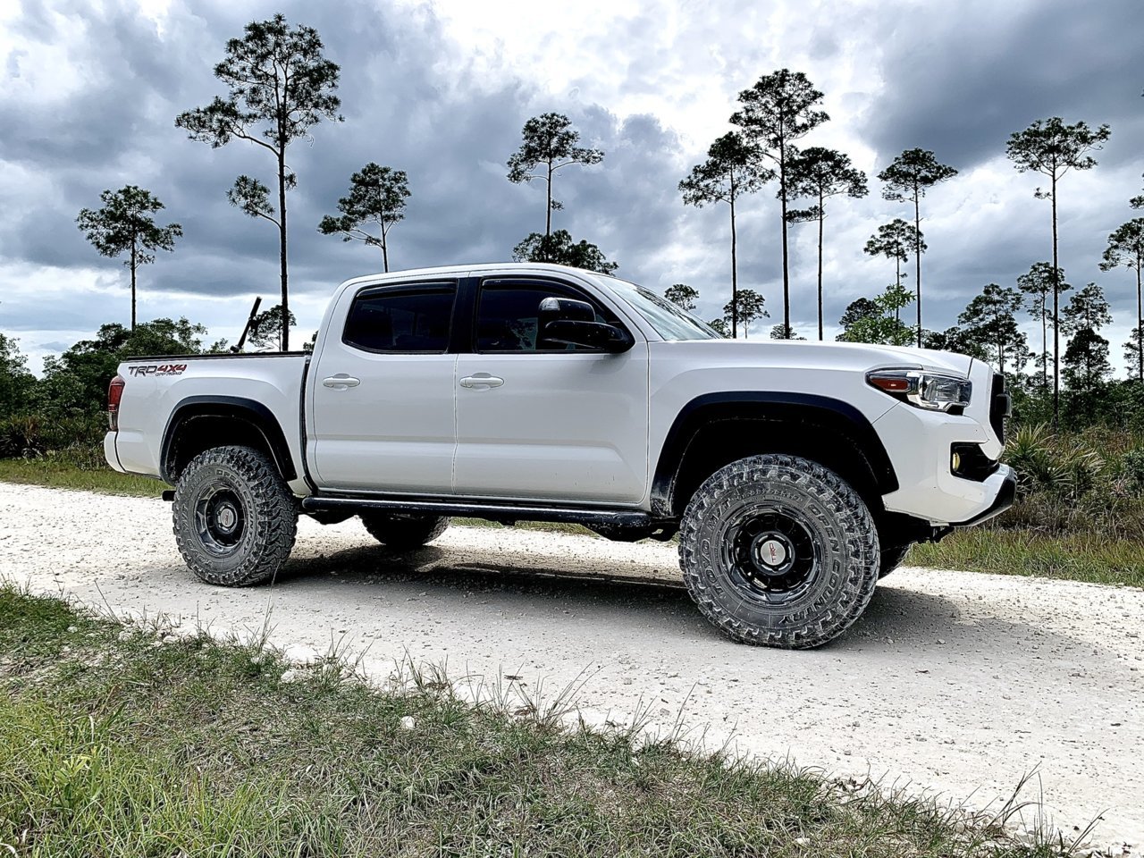

    i got the 5100 with the 888 coils and AAL and jba control with the 255. No rubbing whatsoever

    Love the look. Going for just about the exact same thing, color and all haha. How do you like the tire size? Any rubbing or issues?

    love the tall skinnies very capable of eating dirt, highway over 70mph not bad but definitely feels like a regearing is coming soon. Towing the boat with the new set up kills the gas. Very little rubbing and its only when barley turning and going into a drive way that has a gutter in front have never rubbed off road just doing that

    Dang. Such a good look haha. Have you done any trimming or massaging of the inner fender yet? I think this size is going to end up what I go with. But I wanted to see who all had highway experience because about 50% of my commute is highway 70+

    no trimming at all or anything, highway cruise control is no bueno revs super high. But if its not a long commute and keep the rpms down feels fine. Mine right at 70 is sitting right at 2000rpm which isnt too bad but cruise control at 70 is like 3500rpm. I am most likely getting the 5.29’s when i do the regear so towing at those highway speeds the motor and tranny doesnt struggle.

    Last question, what is your exact specs for tires/wheels? Thank you for all this information by the way

    The tires are 16x7.5” trd beadlocks (beadlock piece removed) i believe with a +10 offset. The toyo mt 255/85/16. Id say the poke from the fender well out is about 3/8”. From stock trd to the bilstien is about 4-4.5” taller sits same exact height of a fullsize maybe a taller
