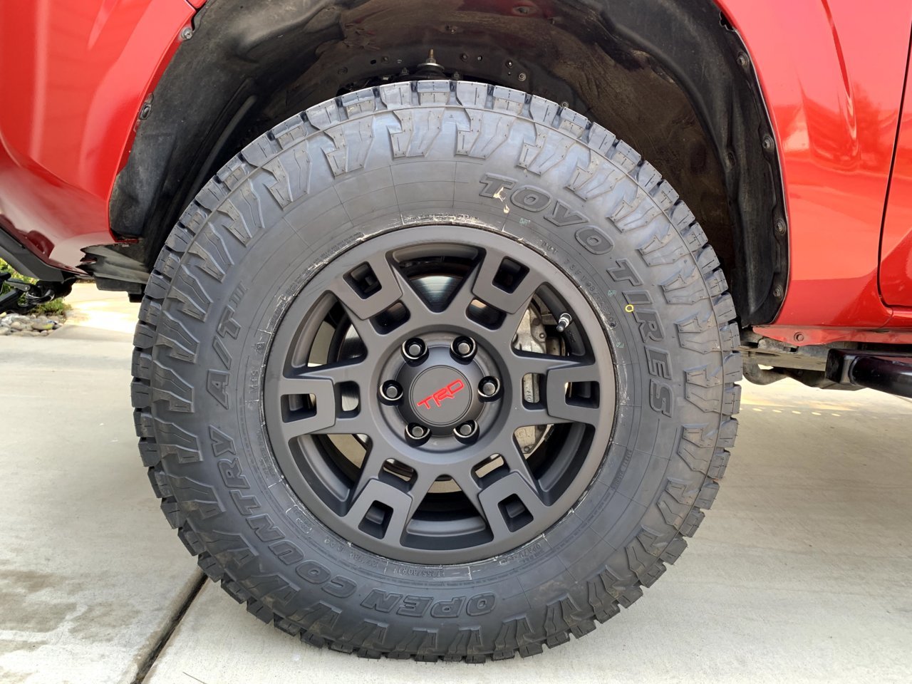

    I'm glad that I took the time and read a couple million pages of this thread. I have those same wheels on my truck, but I just picked up some 255/85's and had them mounted on the 3rd gen TRD OR wheels. The shop said that there is a good chance that they might rub my JBA UCA's, so they are recommending spacers. I really don't know how I feel about running them, but glad to know that I am not the only one that needs them. I was wondering if mounting them on the wheels that you're running would help. I guess not.
    I ordered those Toyo's at first, then I saw that the Yokohama G003 MT's were almost 10lbs lighter. They're within a pound or so of the Kumho AT51 265/75r16's that I am currently running. I actually like the look of the stock steel wheels, more than the TRD OR wheels, but they are almost 10lbs lighter, each. My Taco is the 4 banger, she needs all the help she can get! lol

    Tiny_Taco
    Tiny_Taco Well-Known Member
    Sep 27, 2020
    #342143
    217
    Bakersfield, Ca
    Turd Gen TRD OR AC 4X4
    Stuff and Things
    Shhh, I'm still getting caught up with my build thread. lol
  20. Oct 10, 2020 at 10:58 PM
    #4860
    TacoEspecial
    TacoEspecial SSSlow
    Jul 19, 2017
    #224500
    1,642
    Mark
    Sacramento
    13 Sliver TRD AC
    BAMF RCLT Deaver Fox 2.5 StopTech Dana 60 37s 475:1
    You need 4.5" of back spacing.
    Mine have 5.25" and they rubbed a little on the uca so I added 1" spacers and now they are fine.
    Handles really well.
    I don't notice any issues.
    Think its much better to have wheels with the correct back space.
