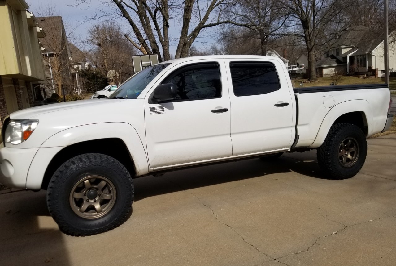

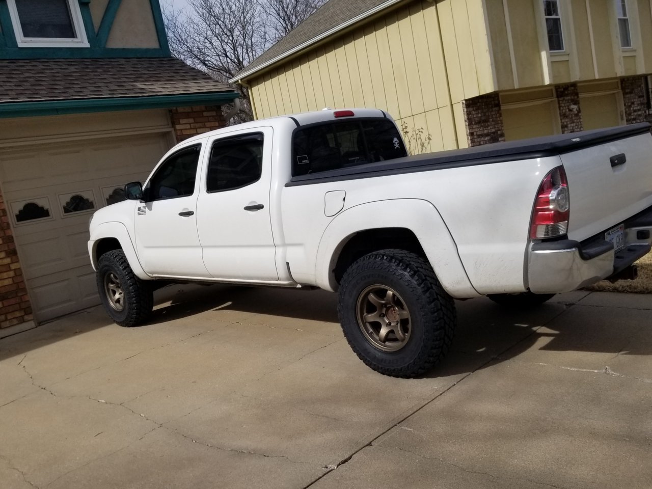

  15. Feb 15, 2022 at 11:16 AM
    #4955
    1madmnky
    1madmnky Well-Known Member
    Jan 30, 2016
    #176630
    299
    Tony
    Kansas via Fullerton 714
    2010 Tacoma 4X4 DCLB
    Hella Supertones
    Jumped on the skinny tire with Cooper ST Max today in 255 85 16s
