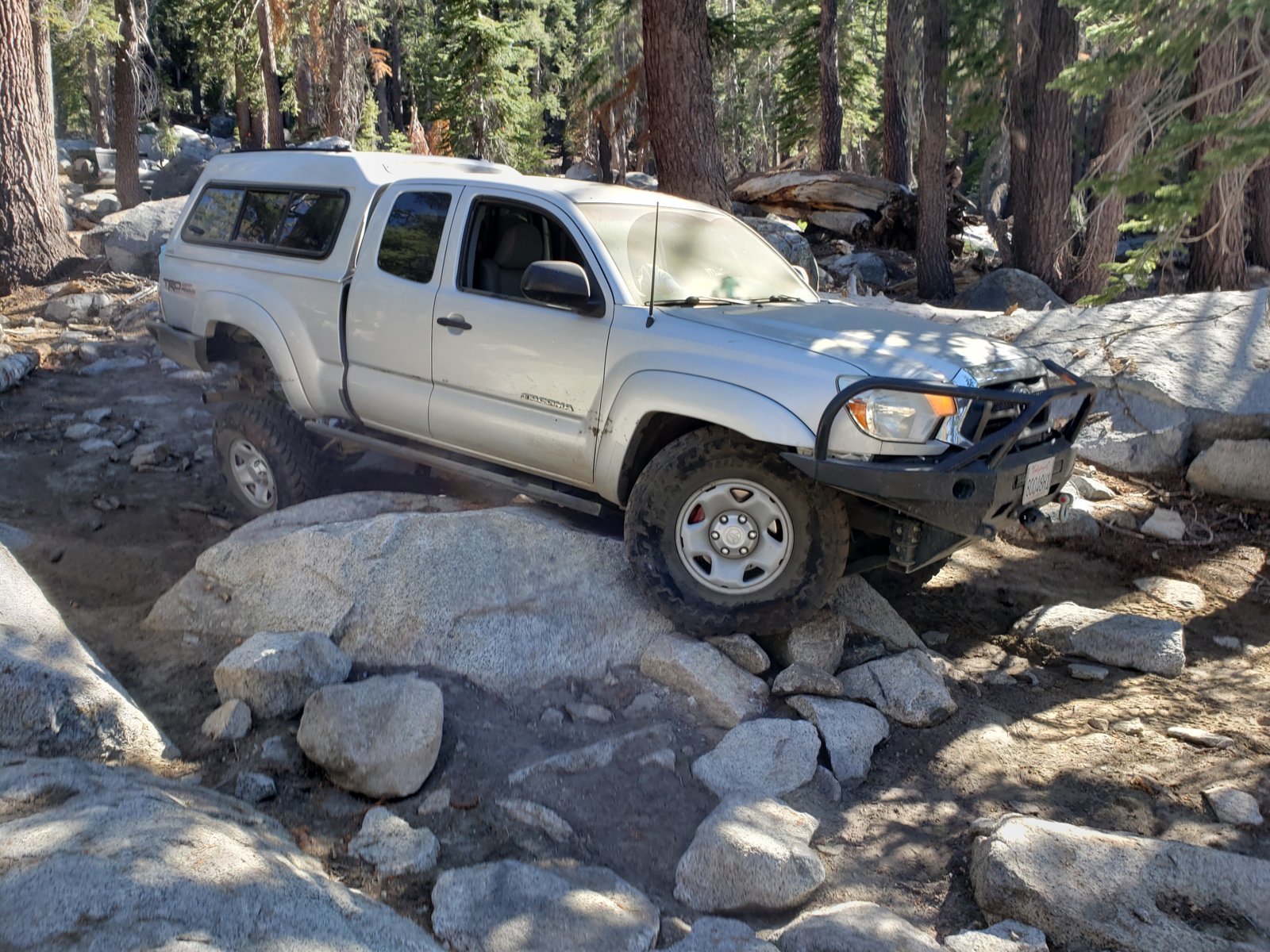

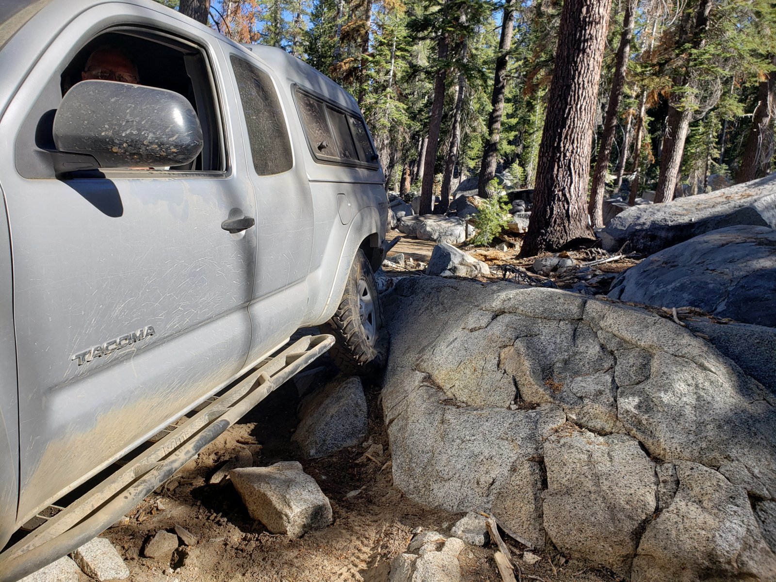

    I didn't need to trim but I had to take off the mud flaps.
    I did put on superbump bumpstops with a 1/4" spacer on the front.
    Also added an add a leaf in the rear but that was just to match the extra lift on the front.

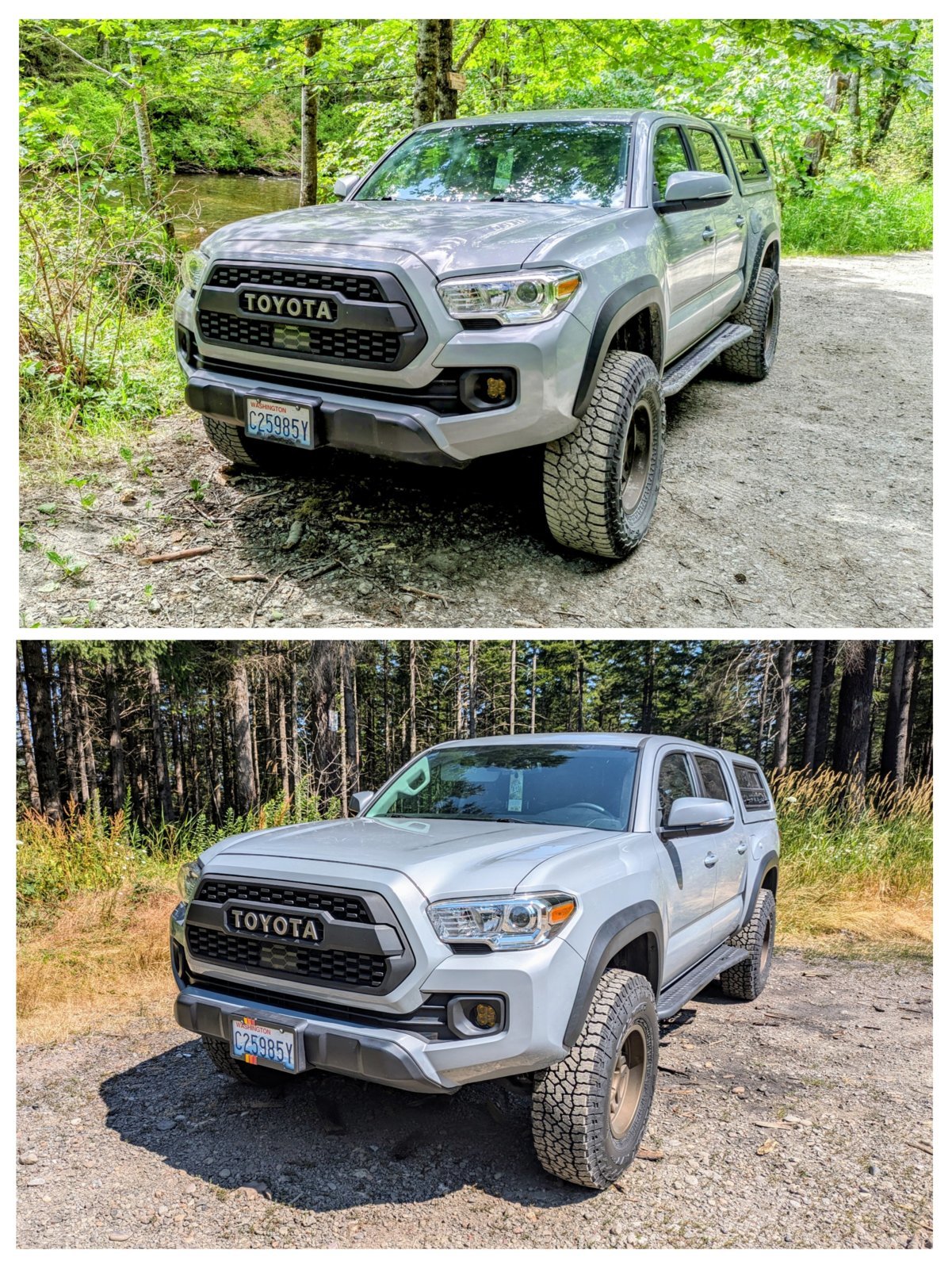

    Just upgraded from 265/75R16 AT3W to 255/85R16 AT4W.
    Before/after:
    Here is my experience so far, copied/pasted from my post in the AT4W thread:
    My tires were delivered early and I got them installed Wednesday. After driving around with them the last couple days, I can say the ride quality is almost the same as my old SL tires. They don't seem any louder, and even though they're 14lbs heavier than my old tires, I don't really notice the weight. I can feel maybe just a bit more grab when breaking just as I'm coming to a complete stop, and maybe just a bit more of a push needed at initial acceleration. But after that, getting up to speed is fine. These narrower tires seem to corner easier too, but the heavier turning on my old tires was probably due to the offset of my wheels (-25) and the high castor of my alignment (5deg). I did get a CMC last week in preparation for these tires and I'm glad I did. I do still need to trim the front fenders a bit as those still rub a bit when turning in reverse. As far as MPG, still need to put a few more miles on 'em to see where I'm at. I'm definitely revving higher and cruising at a slightly higher RPM. It also doesn't seem to know when it wants to shift into the next gear, even worse than the usual gear hunting. Looking at getting an OTT tune to adjust for the larger tires plus a few other things. Don't think a re-gear will be necessary.
    Overall, I'd say I'm very happy so far!
