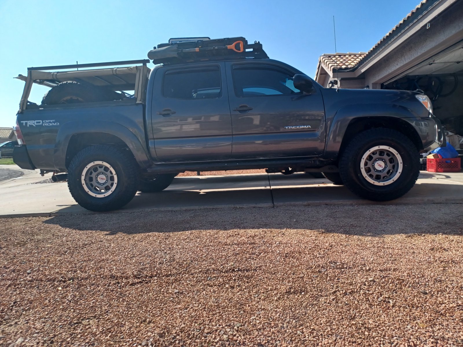

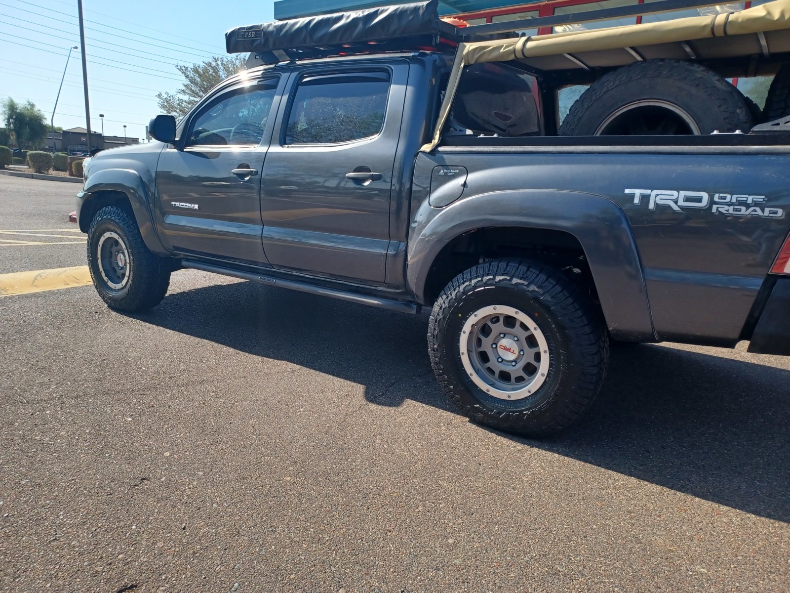

    I bit the bullet and have it on a hitch-swingout now. I love the AT4W! The 33s beat the shit out of my 265s, I can feel the truck going over obstacles so much easier and I was able to get past a spot where I bottomed out my frame and sliders before. The C-rated AT4Ws ride so much nicer than my E-rated KO2s, but I feel that they don't do quite as well in sand. Overall, I really like the change and I havent experienced too many negatives!

    Can you elaborate on “don’t do quite as well in the sand” @PilotBoy352 ? Like sand isn’t your norm or what’s your overall comparison to the opinion.

    When I'm wheeling through washes (theres a huge one that is my usual wheeling grounds) they seem to slip more than my old tires. They still do really well, but they like to spin just a bit.

    Sorry if mentioned elsewhere but are you on stock suspension? Any updates on rubbing? And what brand are your rain guards - weathertech? Beautiful rig

    I was on Icon 2.5 coilovers in the front, a 2" lift leaf pack and Icon 2.0 remote resi shocks in the rear. All in, she was pretty level at about 1.5-2 inches of lift. I did slice and dice the rear part of the plastic fender and it quieted all the rubbing.
    She's gone now, but I'm going to be lifting my new 3rd gen and putting the same wheels and tires on it, so I will report back.

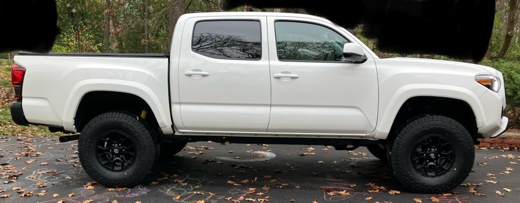

    IMG_3241.jpg Another happy 255/85r16 owner here. Falken Wildpeak AT4W. 2 inch suspension from Dobinson's and 1 inch Toytec body lift (I know, a volatile subject. Just sharing my results). Stock SR5 wheels from the end of the 3rd gen run (the nicer, black version)
    AT4W's on for a week and already tested in 3 inches of sloppy, wet snow at 34 degrees F. Performed perfectly fine if you drive like a grownup, but not as good as the true winter tires I had on my Subaru.
    overall very happy with the tires, and great service as always from Discount Tire.

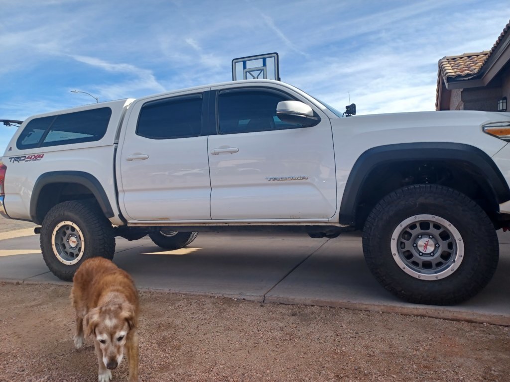

    Lifted my new 3rd gen and moved my 255/85r16 Falken AT4Ws on my TX Baja wheels to it. Looks freaking amazing, and I am so excited to continue building this new truck!
