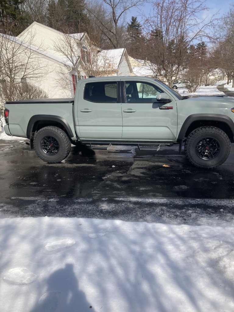

    CB53F0DA-F00D-4F18-8D7F-DEB3F17CC2EF.jpg This thread convinced me to run skinnies instead of 285s. Only about 50 miles on Wildpeak A/Ts. Here are my thoughts coming from 265/75: noticeably heavier and rougher but fine for me. The height increase is noticeable both visually and getting in and out of the cab. I regret not getting these sooner. I have 2/1 lift and it looks perfect. Not skinny looking, but not wide looking either. If people on here didn’t call them skinny’s, I would not call them that because visually they just look normal width. Slight rub at full lock. Discount Tire’s service was outstanding as always.

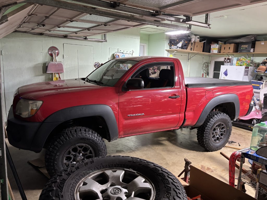

    Just got mine on this weekend too! Haven't had time to drive it yet, I still need to figure out my lift numbers. From hub to fender in the front I'm sitting about 24" so I may need to bring it down some to save the CVs. Does anyone have experience with Eibach Pro Truck 2.0 and how much they may settle (If at all on at 2.7 RC)?

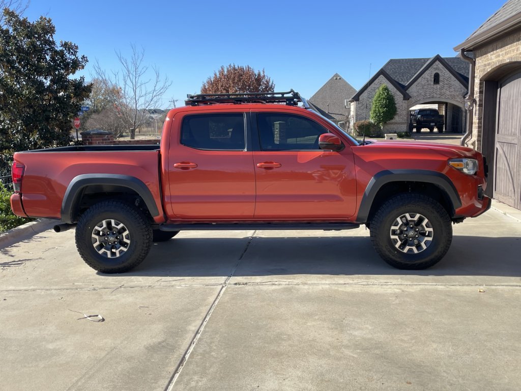

    Part of the skinny club! No up close photos yet, but here’s a side shot. 255/85/16 in the new Falken AT4W. Rides really smooth so far. No highway speeds yet though. Down to about 1/2” clearance in normal stance (6112 lift) at the rear of the front well. Rears seem fine. Spare was a tight beotch. May get back under there and knock the tabs out a little. I relocated the tire hanger a little. A pox for 4 generations on the engineer who decided those 4 bolts would be better coming in from the top than the bottom. Probably easier to install before the bed is in.
    I still need to pop my dash open and update my speedometer calibration, and get my tune updated to 33’s. I also have a set of new brake cables all the way around that I’ve been waiting to install. Probably time for that and a brake fluid refresh.

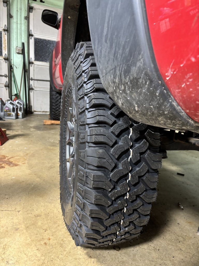

    Just slapped on the Falken 255/85R16's. First to go was the front mud flaps. Rubbed on the drive home. I've had a couple of slight rubs on the few miles I've driven since. I don't have any lift on the 2021 TRD OR. Weekend after next will be an off road test. Three days in Superstition with https://sd4wheel.com/. This will tell me if I need to put a lift on. Trying to do as little as needed to get the job done!
