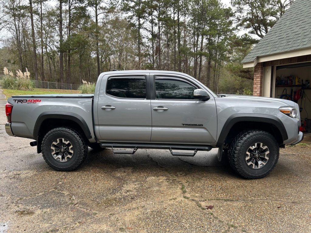

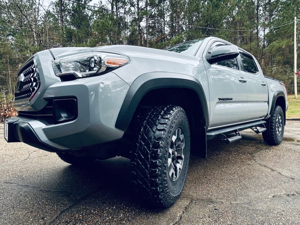

    Threw on some ST Maxxs over the holidays, 255/85/RR16. I've put about 400 miles on them so far and love them.

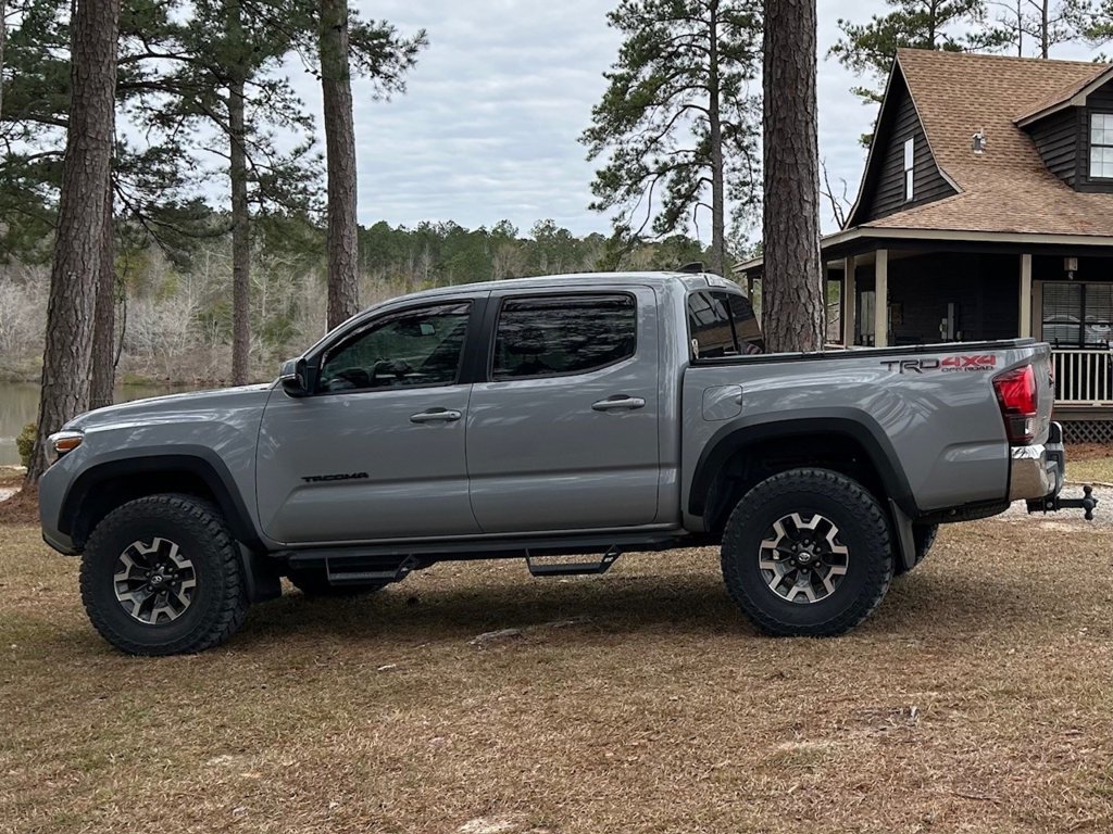

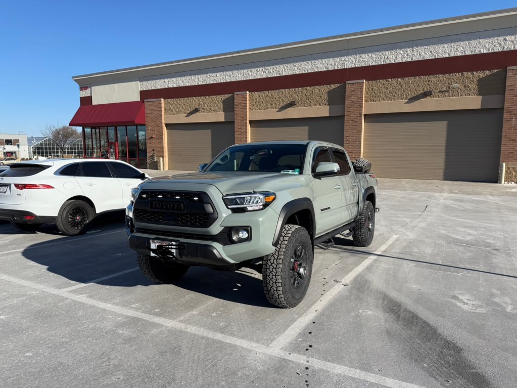

    Put on some 255/85 16 AT4Ws today

    Scrubbed some tires, and knocked a dent out.
    Suspension?

    Trd lift

    Your truck looks great! Do they pull to the right like other have mentioned?

    Thanks, I've tested it a few times to see, sometimes it feels like there might be a slight pull but it's hardly noticeable, other times it seems to track straight.

    No rubbing unless I hit a good sized bump at full turn. But I also have 1.25” spacers installed on stock wheels which puts me at roughly -6mm offset. I think without the spacers the tire would clear the fender well easily.

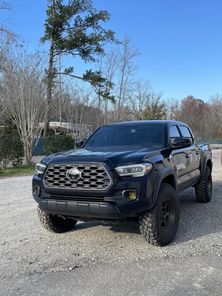

    After reading through this entire thread I can finally contribute! 255/85r16 KM3's

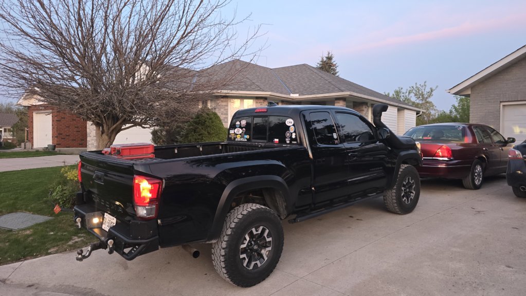

    I'm at around 70k km on my Cooper ST MAXXs, think I'd like a slightly less aggressive tire next time. They've done absolutely everything I asked of them, but they're getting noisy at around 7/32nd of remaining tread. I like the Wildpeak as a tire, but not thrilled with how heavy they are for a 6 ply. Sucks that we've only got the 2 options for AT & RTs in the 16 inch. Maybe I'll have to buy 17s....20250512_204413.jpg

    Did you notice a big drop in mpg?

    Not really

    At4ws are half a pound lighter then what your running now. My personal opinion is people get to hung up on weight, I went from a 55lb 255 to a 63lb 285 and my fuel economy improved. Less Rolling resistance on a new at compared to a worn mt. Buy a set of scs f5s and you'll shed around 5lbs a corner.
