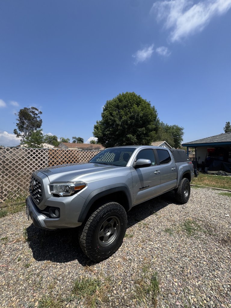

  4. Jun 5, 2025 at 7:56 PM
    #5144
    kalani619
    kalani619 New Member
    Mar 3, 2024
    #445157
    4
    2020 TRD Offroad

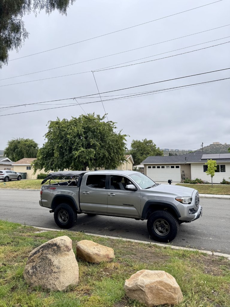

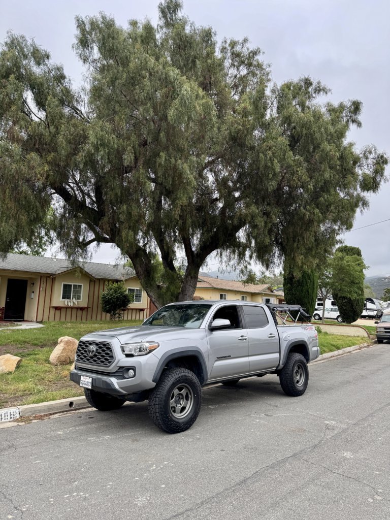

    Another SCS F5 (16x8 +0) wrapped in 255/85/16 Falken Wildpeak at4w
    Silver sky metallic and the gunmetal wheels look so good
    Had at4ws in 265/75 before this

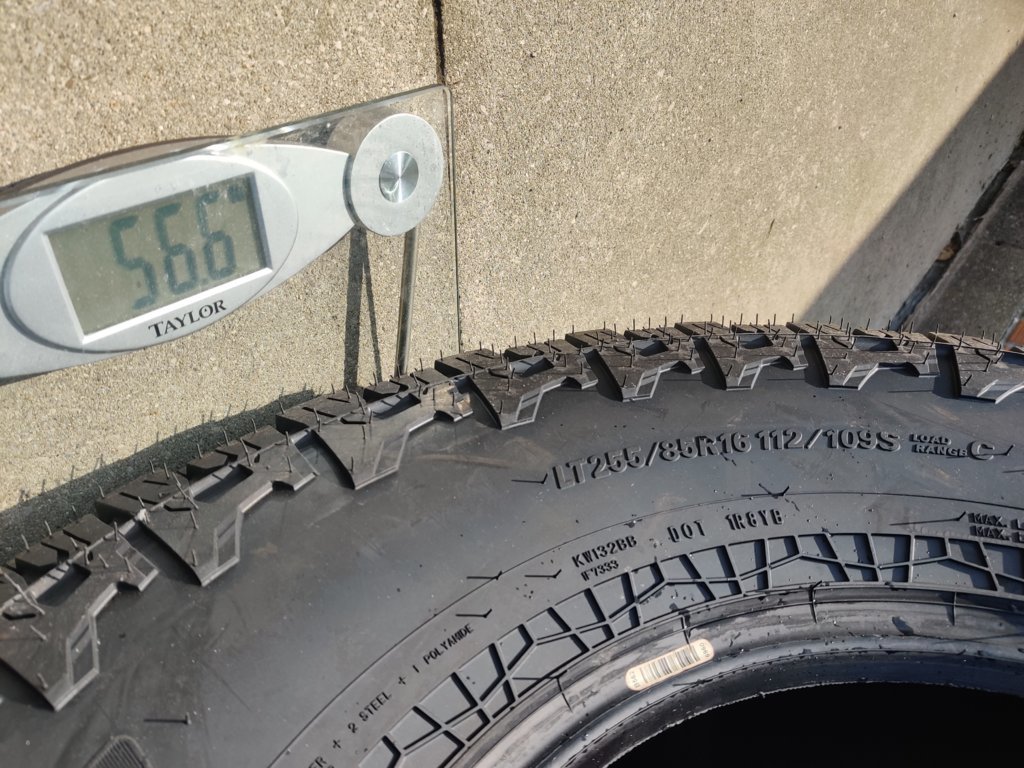

  5. Jun 10, 2025 at 8:16 AM
    #5145
    Saturnine
    Saturnine YVAN EHT NIOJ
    Jun 25, 2020
    #332540
    4,336
    Dar C
    North of the wall
    TRD go brrrr
    All the mods

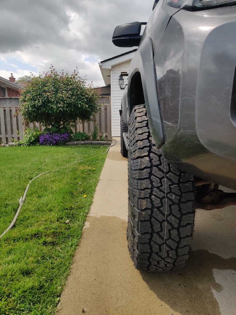

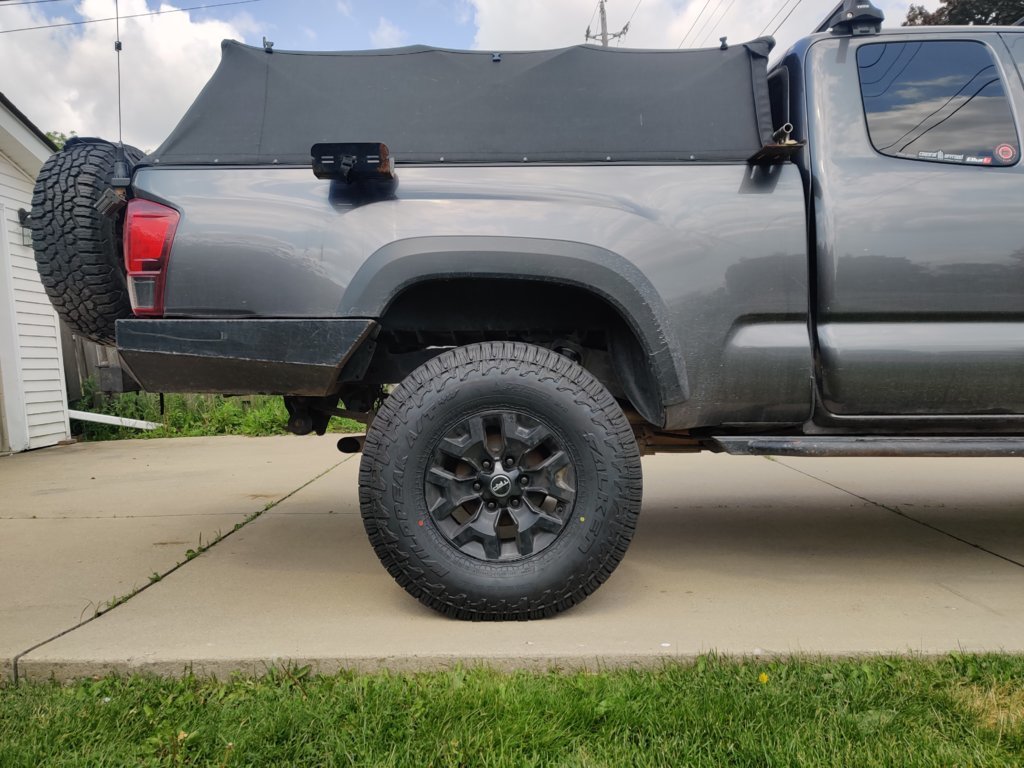

    Real weight of wildpeak AT 4w C-rated (insofar as a home scale is accurate)
    Mounted on stock OR wheels
    With 1.5" spacers (I know)
    Road_Warrior and banditcamp like this.

    Looks good. Suspension? Any cutting/trimming needed? Did you run without spacers a bit or jump straight into them?

    I ran 255/85r16s for 3 years with the same config without spacers. No rubbing anywhere including off road. I do have some rubbing on the plastic when reversing at full turn and full compression head on but that's insignificant, I think.
    I have icon rxt stage 2 and elka 2.5s in the rear and ADS 2.5s set to 2" up front.

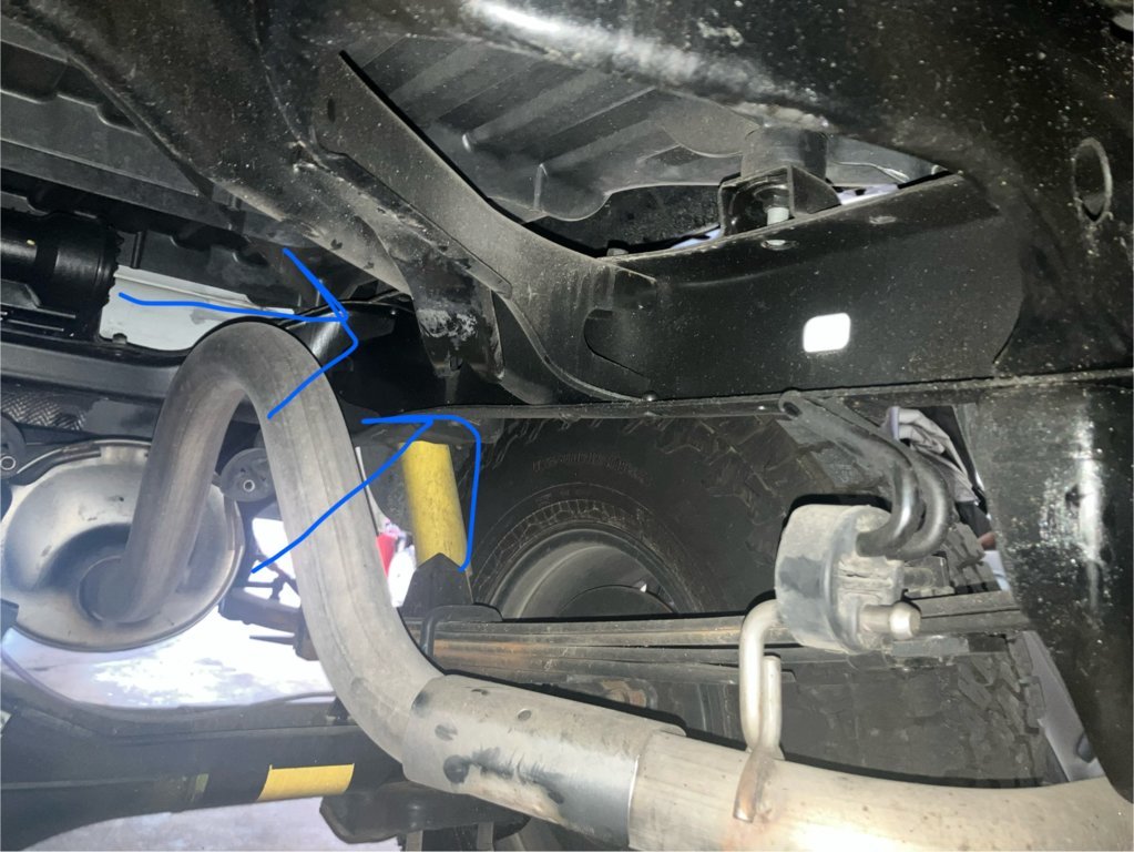

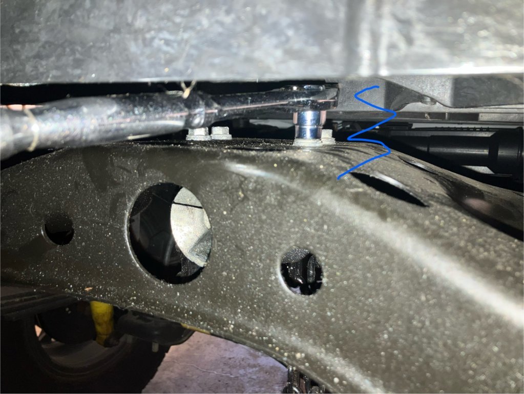

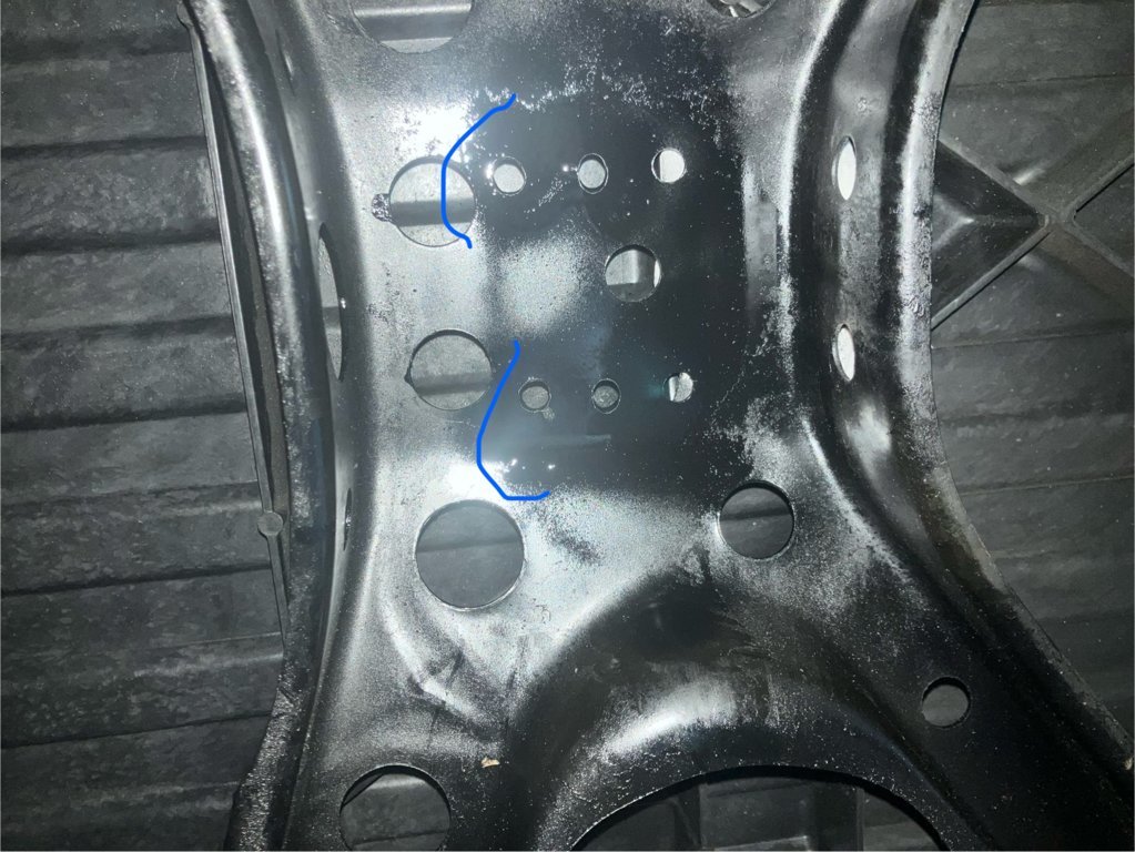

  10. Jun 28, 2025 at 2:52 PM
    #5150
    topochico23
    topochico23 Well-Known Member
    Dec 17, 2023
    #439775
    65
    2022 DCSB SR5 V6 4x4

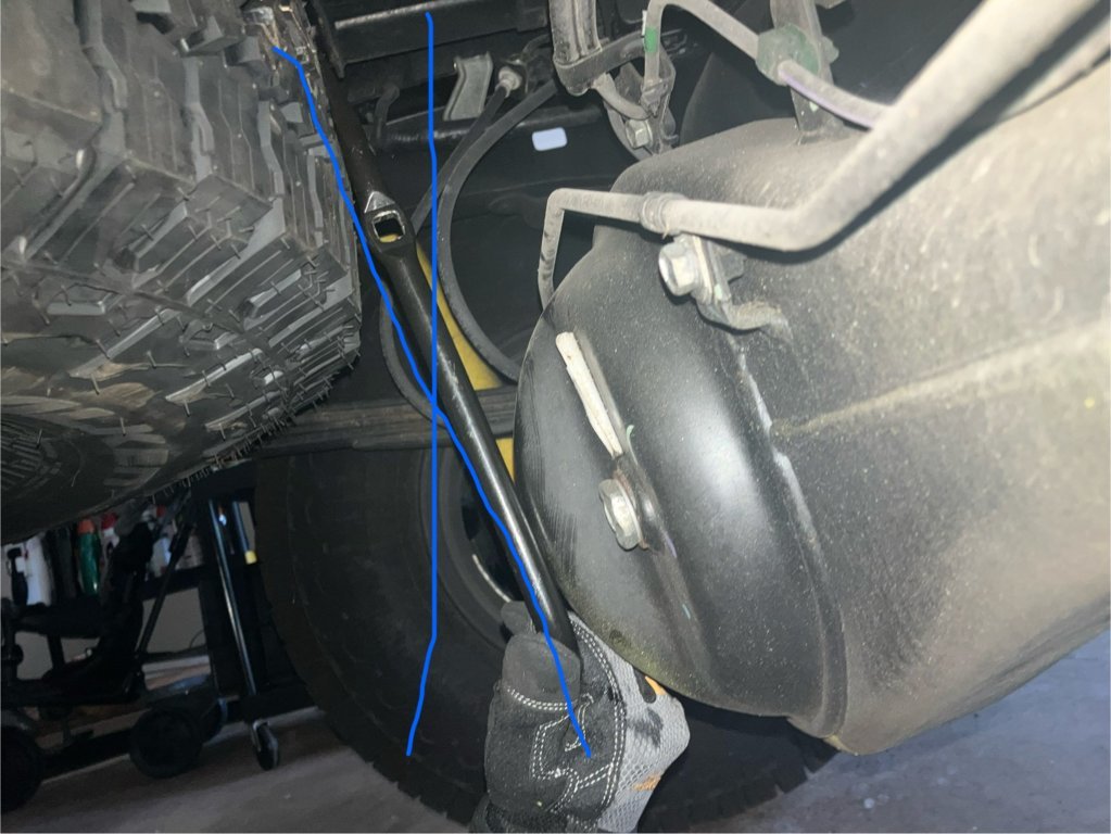

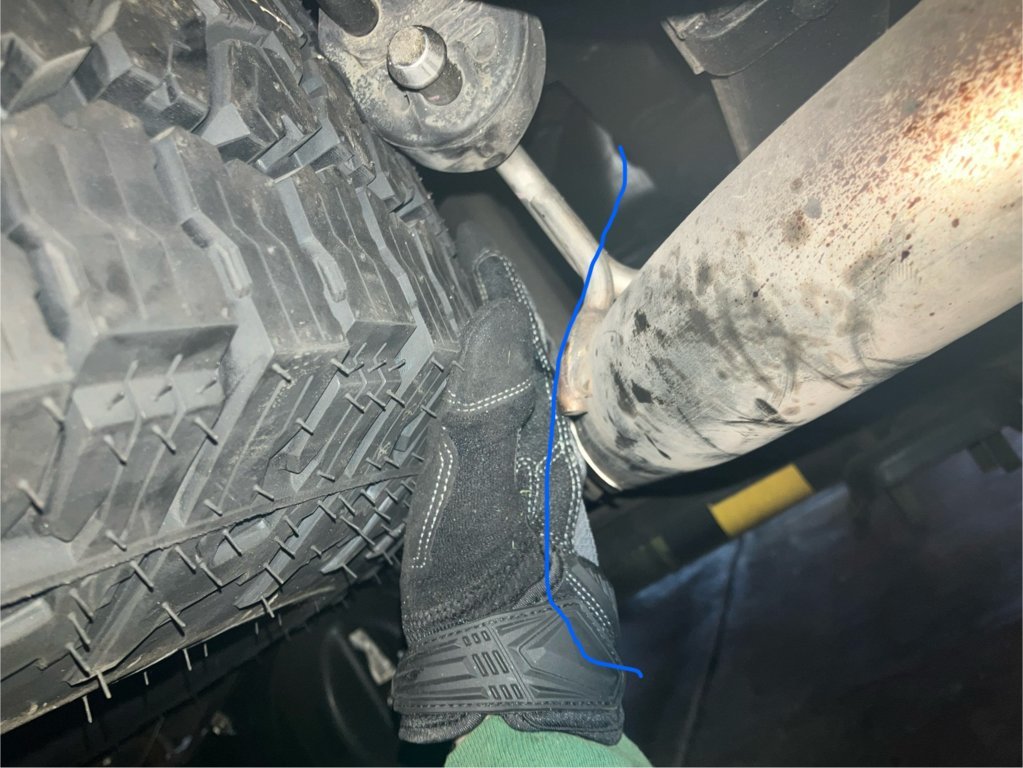

    255/85r16 33 inch spare hoist relocation. There are other dedicated threads but here's my Wildpeak AT4W under the bed.
    requires a 12mm crescent/ box-end wrench. Speed wrench would be better. My 1 inch Toytec body lift allowed me to get a regular socket over the bracket to remove the hoist.
    Drilled a 2nd pair of holes back toward rear of truck. Filed smooth and sprayed with black gloss rust oleum. Anti seize on the hoist bolts and Corrosion-X Red all over the hoist itself and chain.
    Bashed the tire mount tabs/ears/arms back to nearly flat with medium dead blow hammer. Tire touches the driver side leaf spring hanger and the rubber exhaust grommet. I can fit my hand between the tire and the exhaust pipe and the factory heat shield is there. Rear diff should clear the tire during big droops or hard landings.

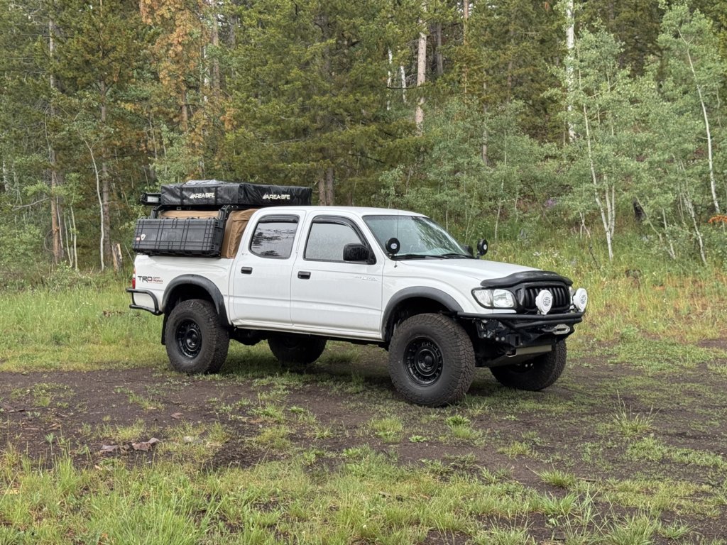

  11. Jul 10, 2025 at 5:08 PM
    #5151
    Indyteecee
    Indyteecee bad at building Toyotas, good at breaking stuff
    Jan 11, 2018
    #240940
    223
    Wyatt
    Utah
    04 Tacoma Double Cab TRD
    Installed these wildpeaks a few weeks back. Coming from a 33x12.5, I never considered how much a skinnier tire would improve ride quality. Way nicer to drive now.
  12. Jul 14, 2025 at 10:02 AM
    #5152
    clenkeit
    clenkeit Well-Known Member
    Apr 30, 2019
    #291841
    2,489
    Colin
    Lakewood, CA
    2010 White DCLB TRD Sport
    I also weighed mine when I got them and got little bit higher of a number and I believe mine is more accurate as I've tested this bathroom scale against a ton of other scales (e.g. accurate scale at my gym and postal scales for shipping large packages). See quote below from my original post in the thread regarding the AT4W:
    Love the idea of shifting the hoist rearward. I was able to get mine in there without doing this but I do get some rubbing on the diff. If I try hard and get it positioned right I can get it not to rub but it seems to be tough to consistently get it positioned correctly. Moving the hoist would be a huge help.
