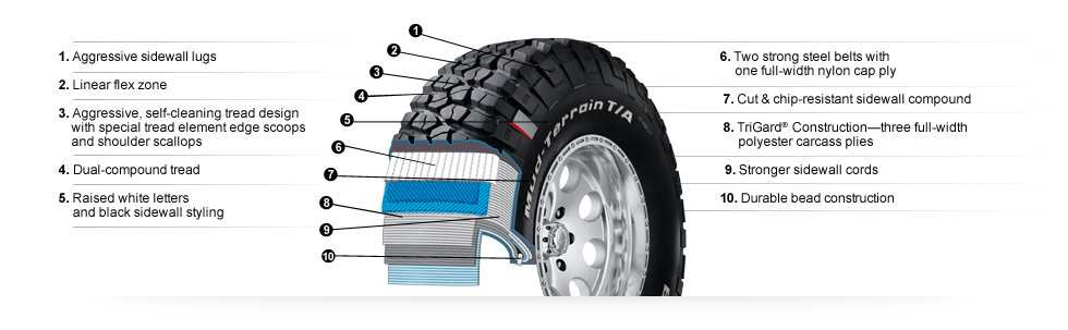

    Your tires DO NOT have six separate plys thus the term "6 ply" is total utter BS and should not be used. It's pretty easy to understand so I do not get your confusion around it.
    All KM2's are 3 PLY regardless of rating. From BFG's website "three-ply polyester construction".

    highlights_0017_Mud_Terrain_KM21_zpsa051_580e7e2f453fc8720874469e48071ba318cead3b.jpg
    seee #8

    your mixing carcas ply and crown plys.
    please stop thinking so hard................
    If you don't beleive me or the quotes I gave you from BFG's site or the tire rack link someone provided please call BFG of go to their site yourself.
    I give up.
    this was already addressed numerous times in this thread and it's very simple to understand.
    People like you are why the tires till say 10- ply :D

    Not sure what you are questioning. Tread will always be thicker. You drive on it and it is a wear item.
    The diagram I posted shows the exact construction of the tire in question.
