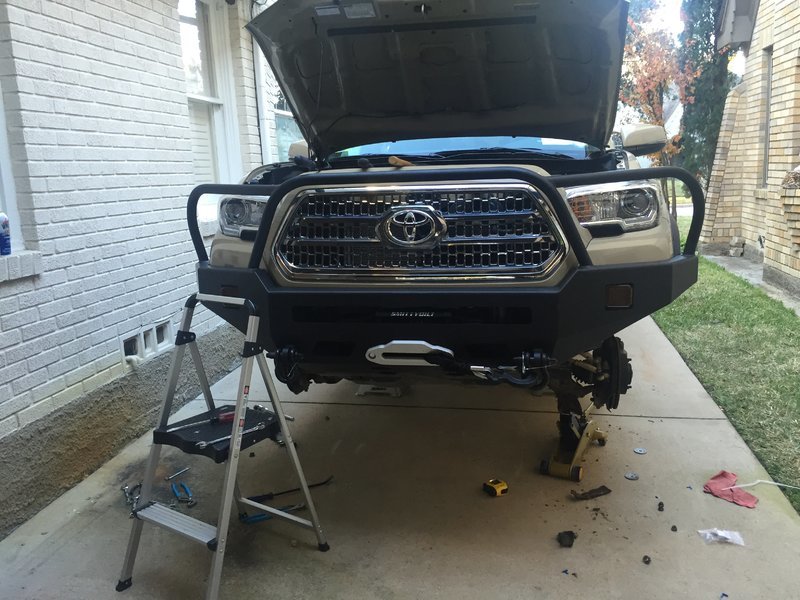

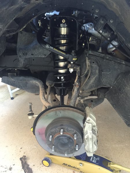

    image.jpg image.jpg They keep them stocked around here because of all the snow. One day wait. I said to hell with it and threw the kit on myself today.
