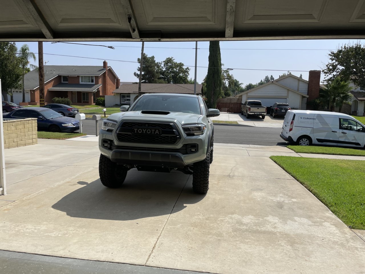

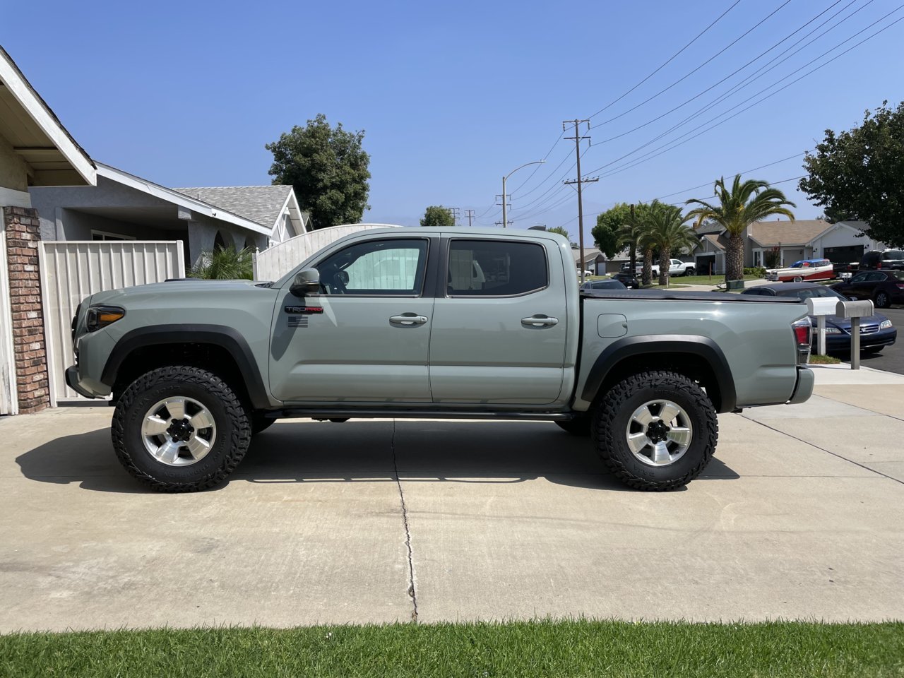

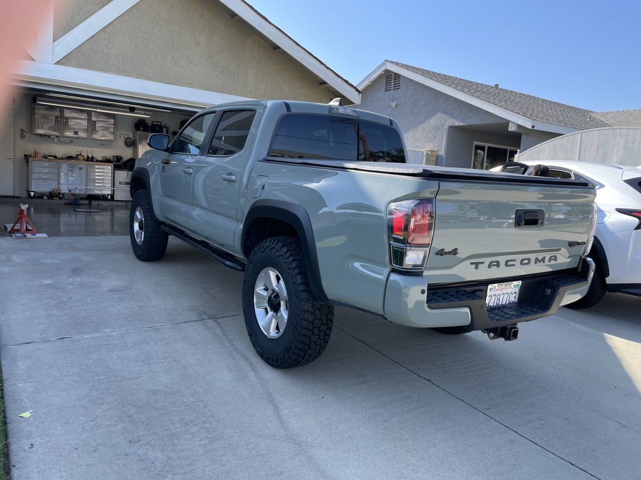

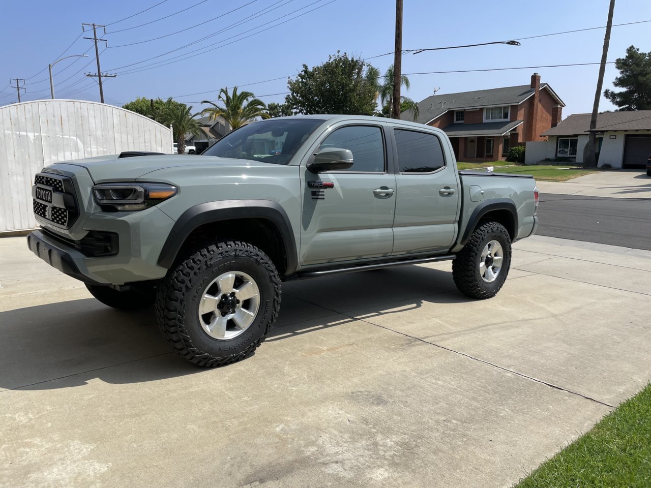

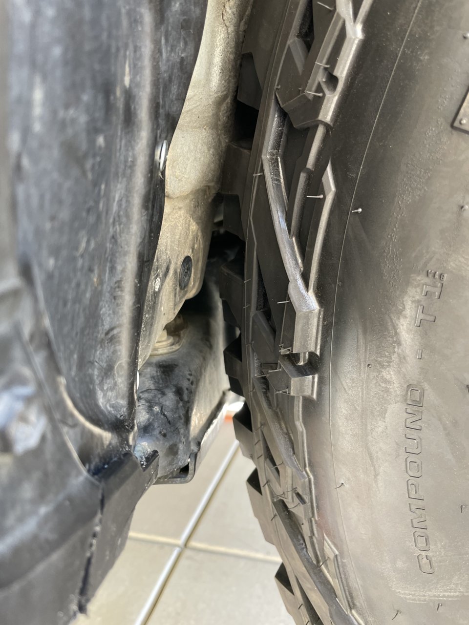

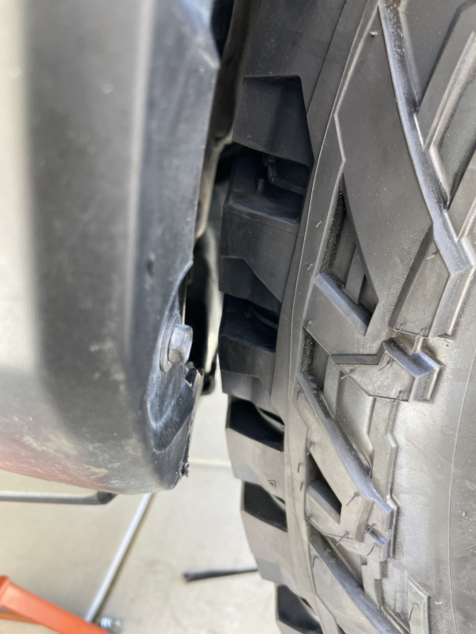

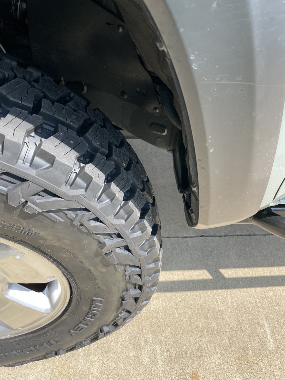

    I got my SPC UCAs installed this weekend and worked on getting the 35s installed. Good news is, with the SPCs ball joint in the farthest forward position and the lower cams set for max caster (max forward position), the 35s cleared the cab mount at full suspension compression. I had to bend flat the pinch weld and trim some of the fender liner in the front and rear.
    Bad news is (and this is probably do to my setup), the upper ball joint is touching the coil spring a little at full droop. I am running the stock TRD Pro Fox coilovers with the Wescott 1.5" lift. I also installed an additional 1/4" spacer on top for a full 2" lift. With this setup, I have more down travel than most, which is why the ball joint is touching the spring.
    When I was aligning the front end, I ran out of camber adjustment on the SPCs. I was at +0.5 deg on both sides with the ball joints all the way in on the SPCs. I had to back off a little on the front lower cam to get the camber at 0.0 deg. Caster was ok at 2.0 and 2.1 deg.
    The truck is totally drive-able like this, but I'm going to make some changes to improve things. I'm going to get a cab mount chop (I always thought I would end up needing one but I wanted to see how things would end up without one). That will allow me to run the SPCs in the middle castor position, the lower cams both in the farthest out (max negative camber) and dial in the camber with the SPC camber adjustment. My goal is to eliminate the ball joint touching the spring and to get about 3.0 deg of castor.
    Here are some pics:
    At normal ride height
    At full compression with the wheel turned max and partial
