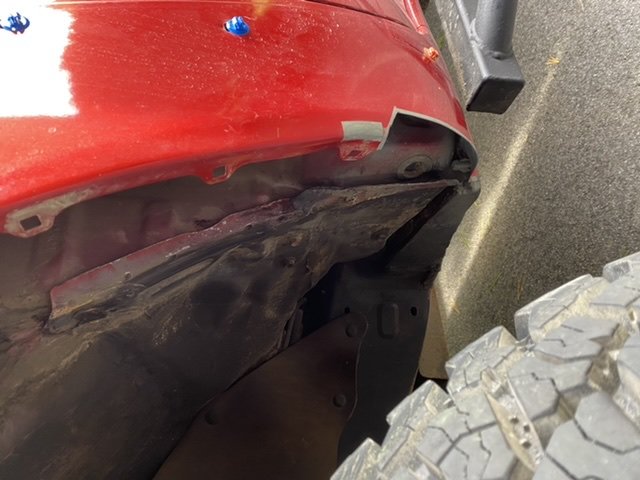

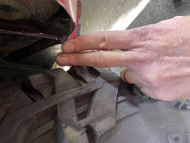

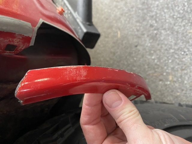

    I'm still trying to determine how much trimming I'm going to need. Apparently my LCA cams are getting seized up and I was unable to move my tire on the driver's side forward anymore.
    Unfortunately for me my LCA cam is seized up in the drivers side and I was unable to more my tire forward in the wheel well :-(
    I’ve removed the Front Fender Flares and chopped a slight bit off the cab corner and beat the pinch weld flat for now. This weekend I’m hoping to do some flex testing to see how much rubbing I’m going to do.
    (Sorry the photos came in side ways) anyone know how to rotate them?)
