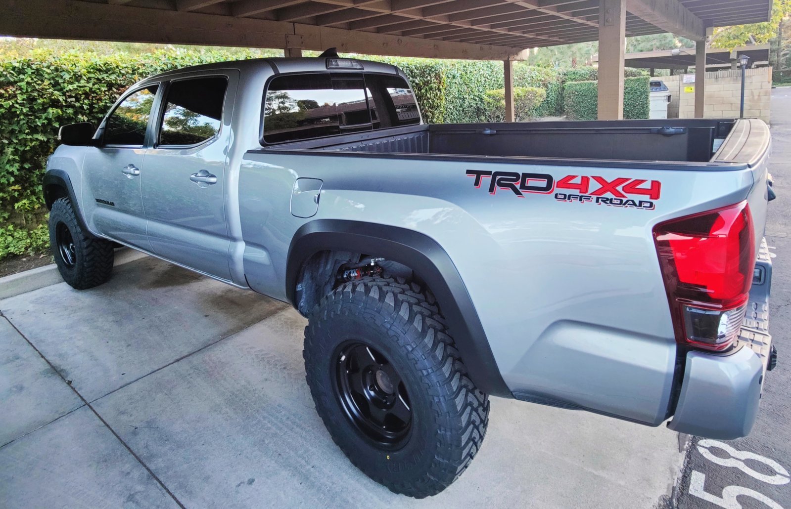

    2018 metallic silver TRD OR
    Work in progress
    Toyo 255/85/16IMG_20231215_163427.jpg

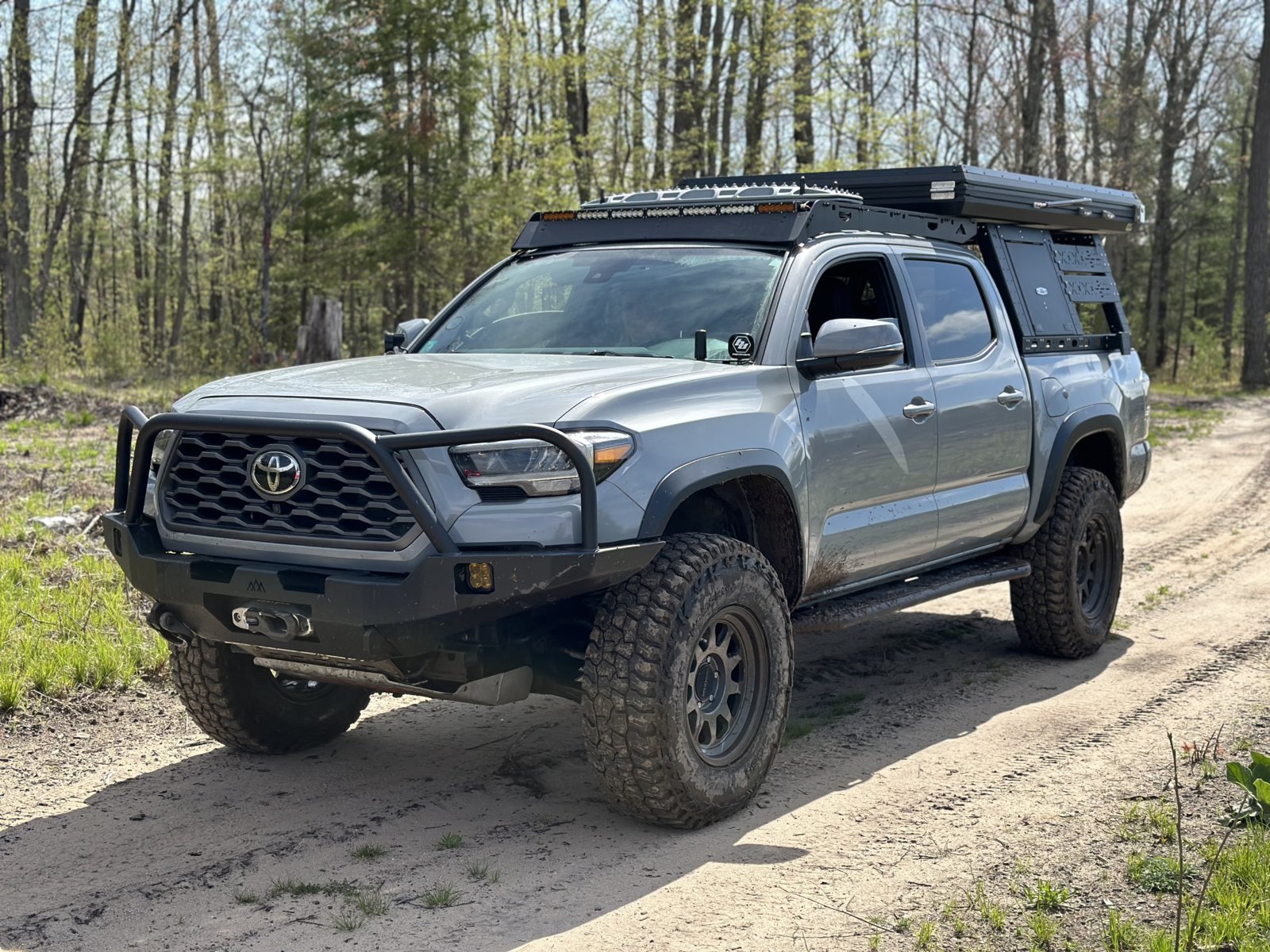

    Dobinsons MRA, AG + 12” smoothies, Deaver Stg 2, 4.88s, 35s, tuned...

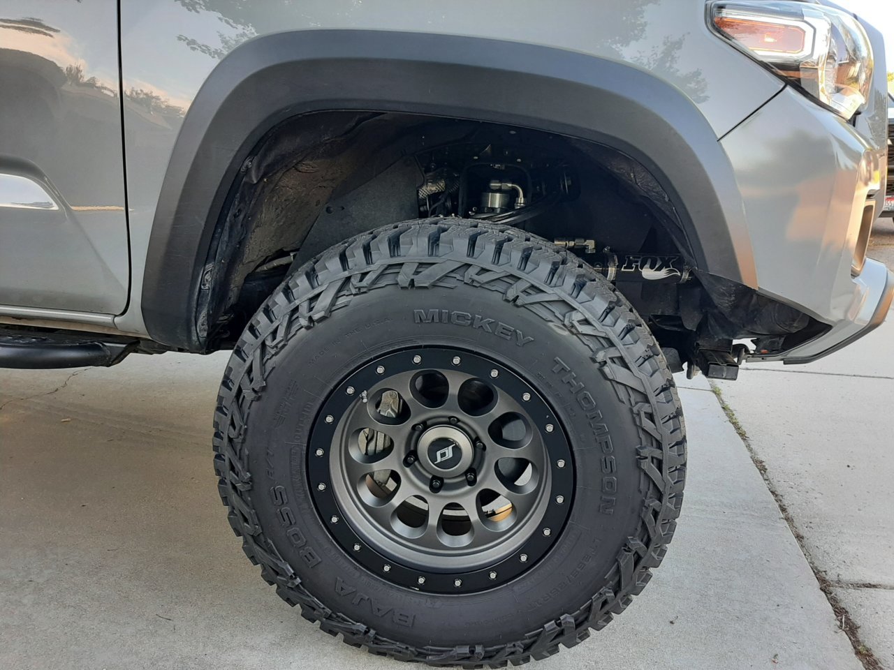

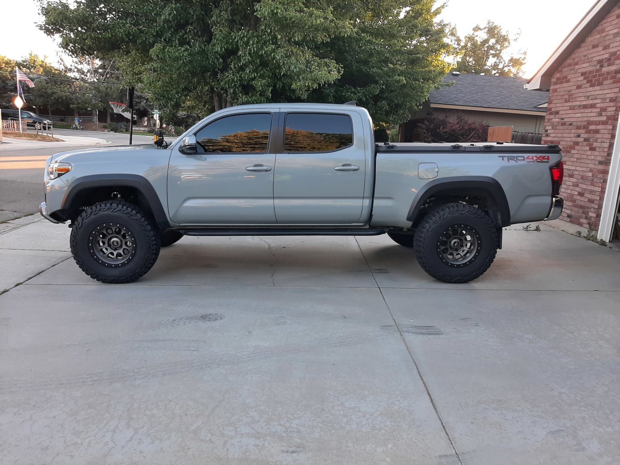

    Really pleased with my Baja Boss ATs.

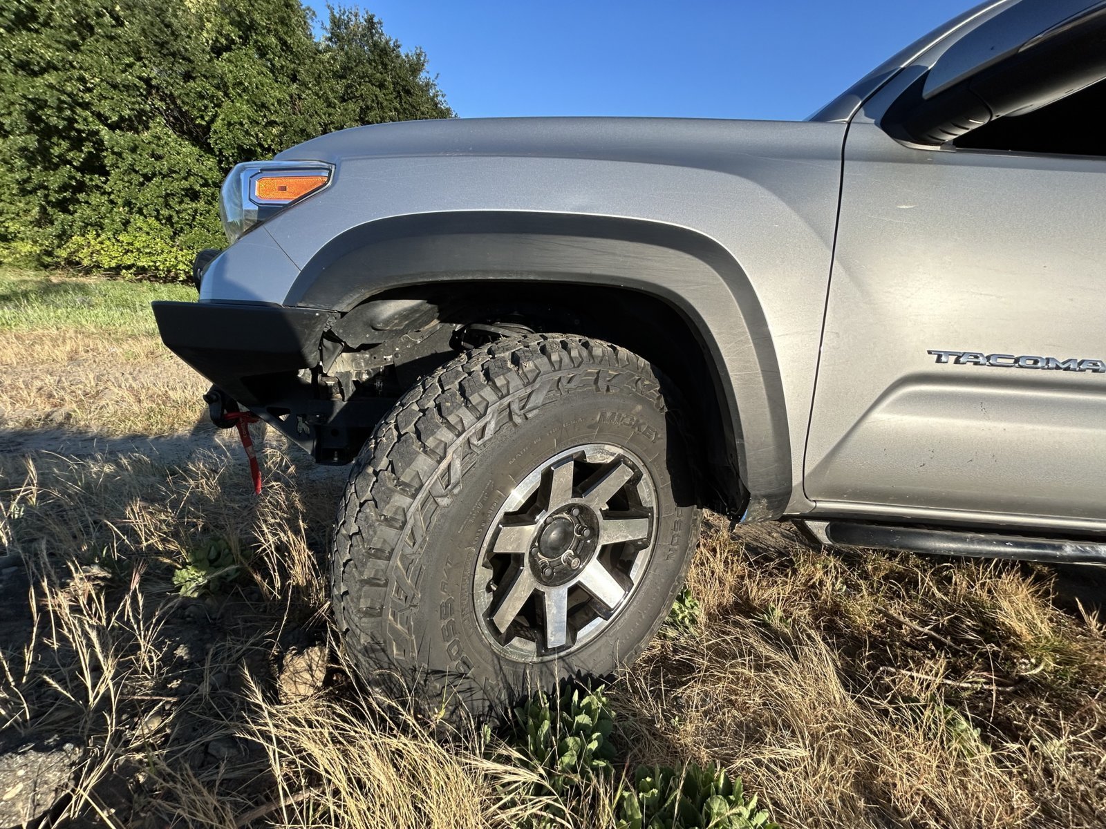

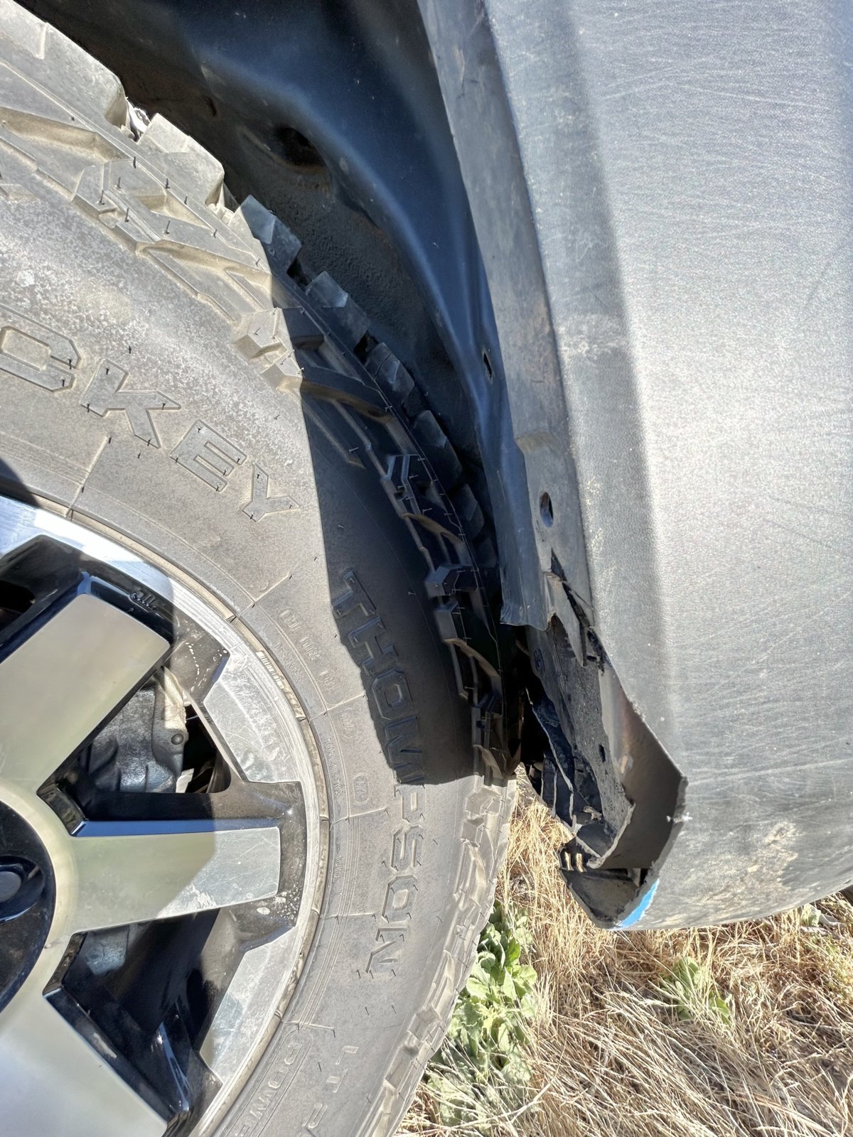

    Finally got my hands on a set of these Mickeys. My current set up is a 1.5” lift using OME 888 coil springs with the SPC control arm in the neutral position. I have a cmc and had to trim the lower part of the fender. Driving and off road at full psi does not rub the cmc nor the lower fender. I do plan on extending the bumpstops
    In the pic, it looks like it is rubbing but it isn’t, the tire is turned all the way driver at the same time on an incline. Haven’t aired it down to see if the tires will rub the control arms or the cmc. As it sits now, it drives great on and off road at full psi

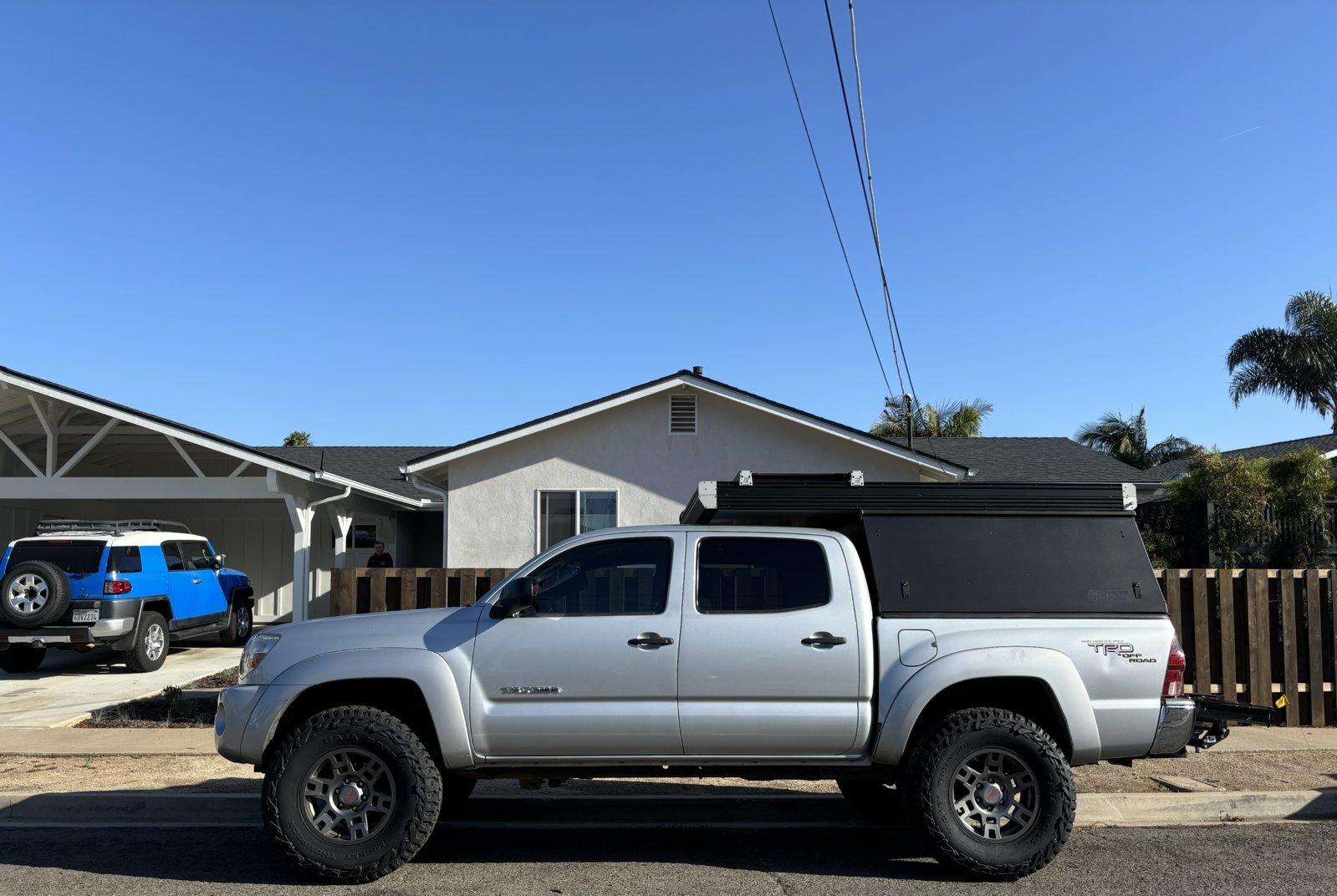

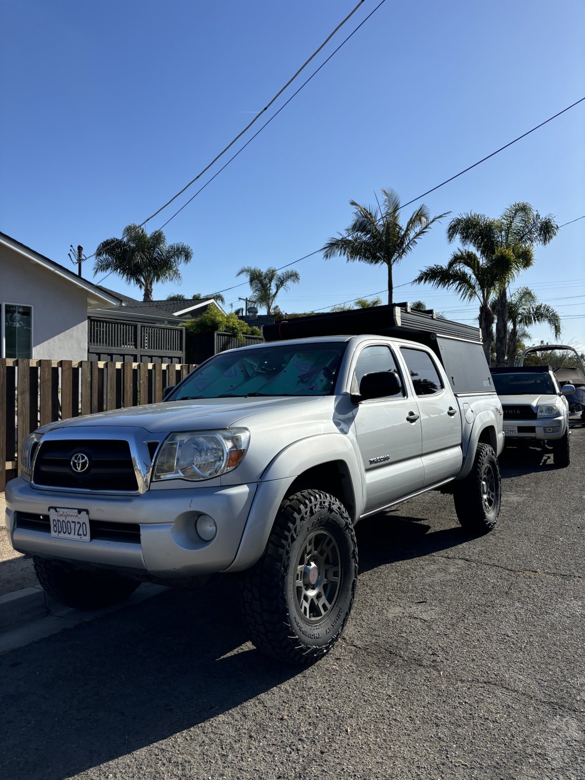

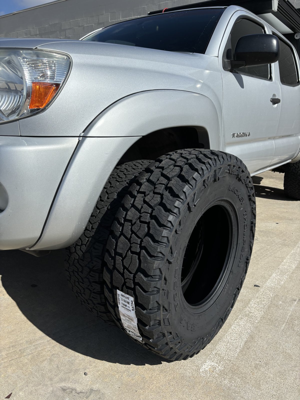

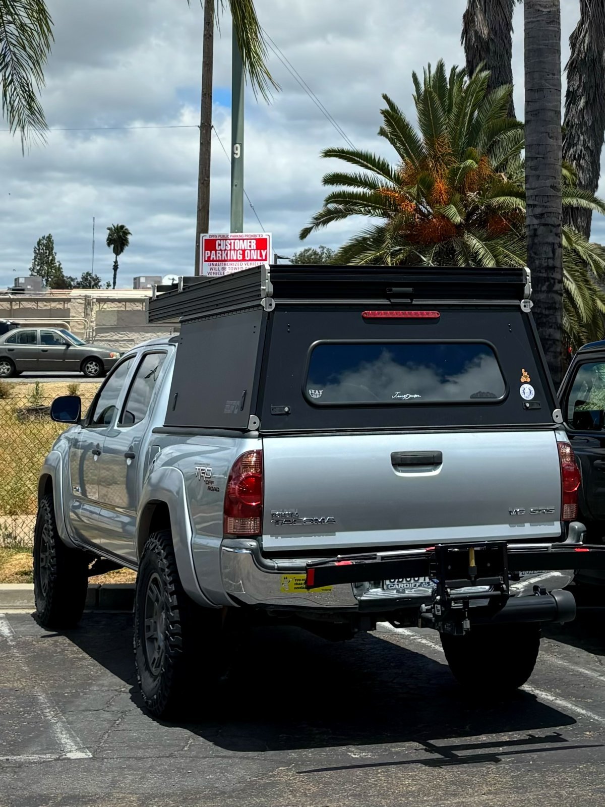

    New meats. Coming from 275/70. Love ‘em so far. Needs some work. UCAs, CMC, and new tie rods for a proper alignment. Trimmed a whole lot of fenderwell.
