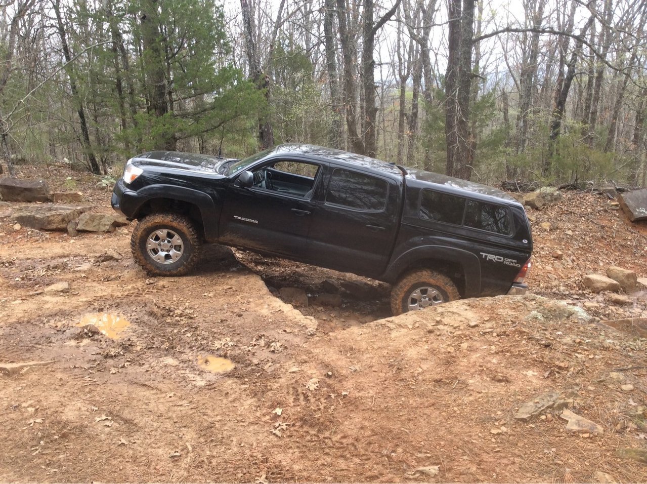

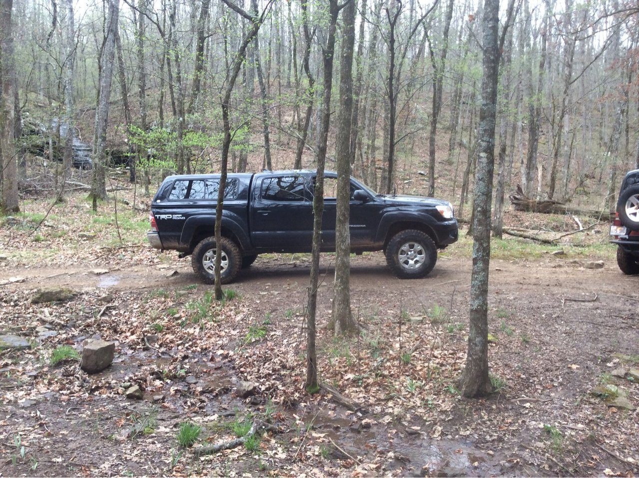

    I have a 3in stage two icon kit with ome dakar rear leafs and 255/85/16 maxis bighorns. It looks great and rides great on and offroad and I did not have to chop or cut anything other than take the mudflaps off. I have a 2014 trd 4x4 quad cab with the stock trd wheels. I also have the stock upper control arms. I would recco upgrading these though.f66fb95376b74f7f73c8f88edfad05d4_52a6a5540c0beac566765d01ecafa238ec2a2cf7.jpg7f6e1546b031d10c5b36870285db7da8_1c17111983dc42c377389f5e08b837385f70d65a.jpg
