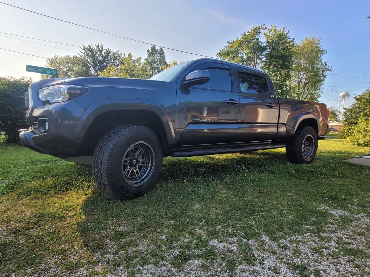

    2020 Tacoma SR5 4x4 DCLB
    None
    I'm going to a 255/70R17 on pro wheels. Going to be selling my set of 5 fuel nitro 17x9 -12mm with falken wild peak 265/70R17s
