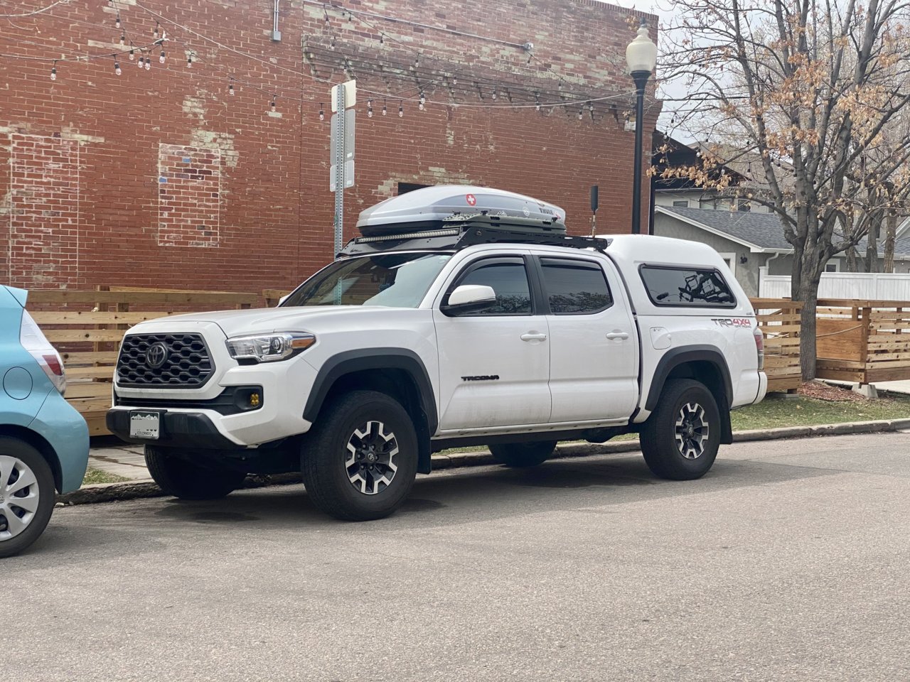

    Hi All,
    I'm looking at wheels that are 16x8 with -10 offset and 4.1" backspace, and want to run them stock (actually, I want a suspension, but I can't find anything below $2000 (including labor) that won't worsen the ride quality when I load up the rear with camping stuff). I have a ~$2000-$2500 budget right now and my stock tires are pretty much worn to the ground so I HAVE to buy new tires, which is an unfortunate limitation. I also don't want to install the suspension myself because 1) I've never done one (even though I'm mechanically inclined and probably could figure it out, 2) I don't have a buddy to help me, 3) I tore my AC joint and will likely need shoulder surgery soon.
    So here are the options I'm looking at:
    My thought process is that a 255/85r16 will probably be my chosen tire when I have a lift anyways, bc I expect the diameter fills the wheel space well, and ibc it's lighter than the 285s which seem overkill. So this way I can use my budget to have a sick looking rig with great tires that I'm not looking to replace once it's lifted.
    Do you think a Skinny will fit on a stock TRD Off-Road with a -10 offset? I've read about people doing it on the stock OR wheels (+25mm offset) but the -10 offset on these makes me concerned that it'd be no different on the exterior clearance and will rub on the cab mount. I understand this can be a problem with 285s (33") and that the +25mm offset of the stock OR wheels help the skinny sit IN the wheel well all the way to the back, but since the stock OR wheel isn't as wide (16x7 instead of a 16x8) the spacings for each offset number changes and now I'm lost again. Would anyone consider this option? Or am I being an idiot for spending my money on wheels when I can buy suspension parts and hopefully find a cheap installer? I don't want any kind of block/spacer lift because of the performance so I can't imagine a lift kit that qualifies but is still < $2000 installed.
    Alternatively, would I be better of getting a 265/75r16 because of the availability of a KO2 and the better price? I'm concerned that I'll be left wanting more because it's not that much more than stock and I'll probably still be trying to lift it down the road. Clearance has been an issue in the past and that's also why I like the skinnys.
    Thanks for your help. Here's how she sits today:

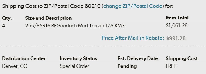

    I have recently tried to pick up a set of those 255/85/16 KM3's and they don't seem to exist anywhere. While they are listed as an available size I heard from a guy at Michelin that they have no eta for when they will produce another run.
    If you find some I'd love to know where!

    I can find them on tire rack with shipping to Denver o_O. It's a special order with pending delivery date but still.

    Call them, they'll call BFG (Michelin) and you'll get the same spiel I did.

    Ya don’t order what is not actually available or you might end up with grey hair before things arrive!
