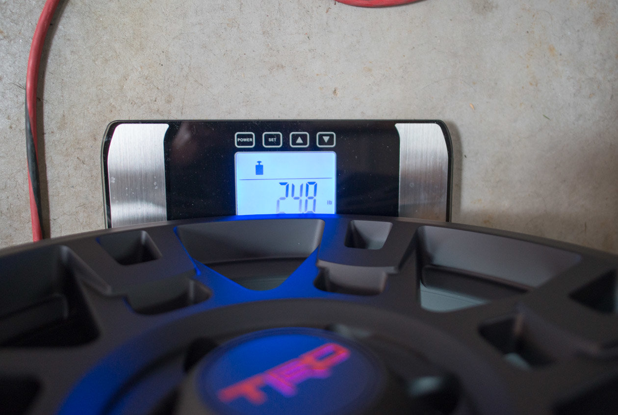

    some stats I've collected:
    I believe the stock Good Year tires come in at 37 or 38 pounds vs
    TRD Sema weight cited here:
    https://www.tacomaworld.com/threads/wheel-weight.537633/#post-17318356
    TRD Off-Road and TRD Pro (2020) wheel weight cited here:
    https://www.tacomaworld.com/threads...heels-weight-comparison.652337/#post-22698062
