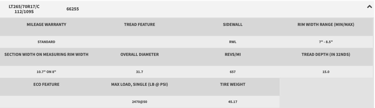

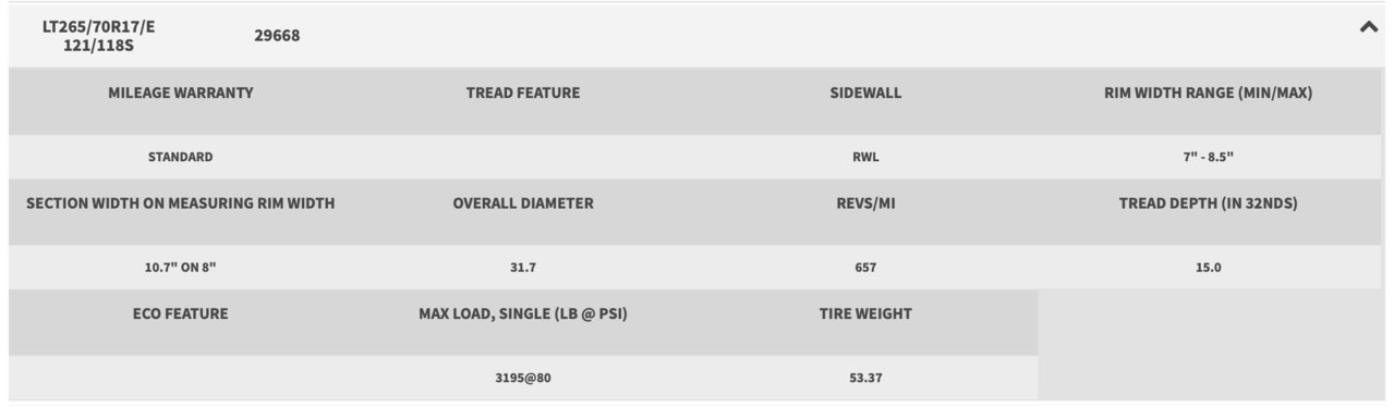

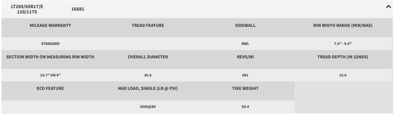

    Looking at the BFG All-Terrain T/A KO2...It looks like LT265/70r17/C are about 5lbs lighter than the shorter LT265/65r17/E. Going from C to E rating adds 8lbs to the LT265/70r17. So, does the lighter tire make up for the larger diameter?Screen Shot 2019-09-02 at 6.50.50 PM.jpgScreen Shot 2019-09-02 at 6.51.18 PM.jpgScreen Shot 2019-09-02 at 6.51.37 PM.jpg
