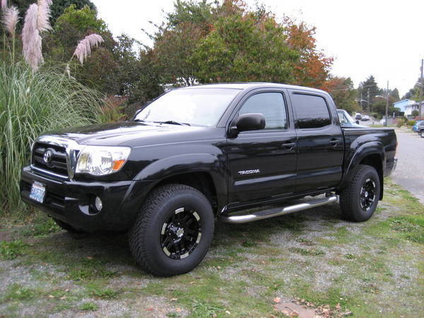

    16" Moto Metal 951 black 265/75 Pro Comp A/T, chrome tube step, wet okole seat cover weathertech digital mats, sockmoney TRD Oahu decal. AWEsome!
    I went from 265/70/16 to 265/75/16 moto metal 951
    I had to remove the front mud flap and trim some of the front plastic
