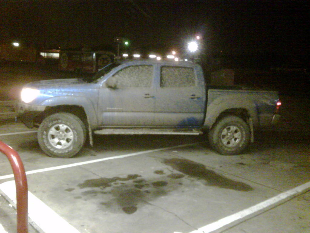

    I've got 265's on a 9" rim...but they aren't duratracs. Here you go...

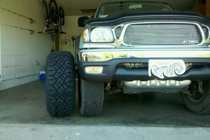

    That size might look funny on a 9" rim. I got 33"x12.5"x15's on a 10" rim and there WIDE!!
    This is a shot of my 33's mounted on the 10" rim next to my stock 265x70x16's
    As you can see the 10" rim bulges out the 12.5's

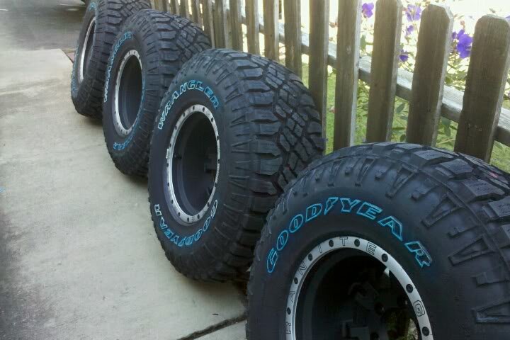

    I have this exact setup with no lift for about 8 months with no problems. I think they look better without that "balloon" effect....

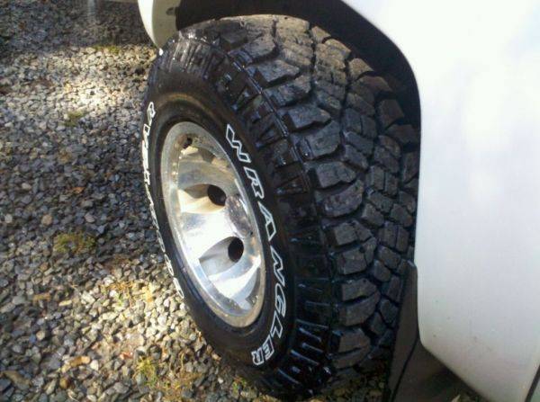

    I've got 265/75/16 Duratracs on a 10" wheel. Not exactly what you're lookin for...but here they are
    They bulge out a bit, but I haven't had any problems.

    yep, my setup is exactly what you are asking for. 17x9 rim on 265/70/17 Duratracs. you will love the 17s way better than 16s.
