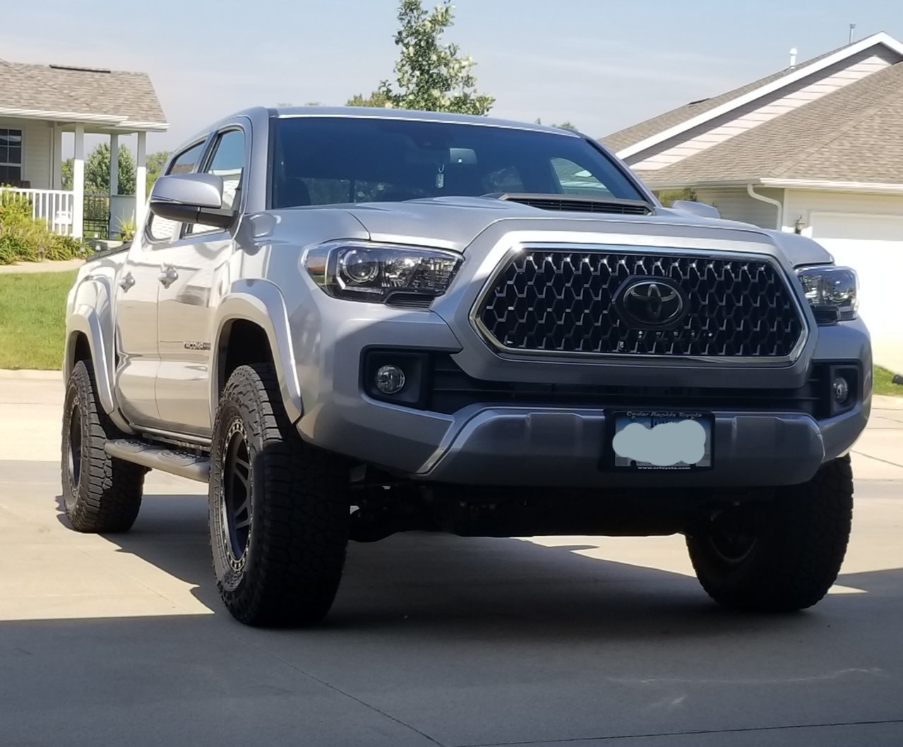

    No lift yet with 17X8.5 0 offset Methods & 265/70 Wilpeaks. They sit nice & flush plus I think they ride better than the factory wheel/tire combo. No rub or trimming but I did have a guy I know do an alignment since the factory alignment had way too much camber to it. I've gotten lots of compliments on this setup!

    Wow, awesome set up! That is the exact look I am trying to go for. That being said,

    Yep sure do & still stock height. Love these wheels & tires!!! Wait till Memorial Day & Discount Tire will probably have another 20% off sale for both & free installation

    That looks perfect. Thanks man! I was going to wait to save up for a lift but that looks great without one. If there is no rubbing then I can pull the trigger now.

    Thanks they are the 0 offset since I didn't want them hanging out & slinging mud & shit all over the sides of the truck.

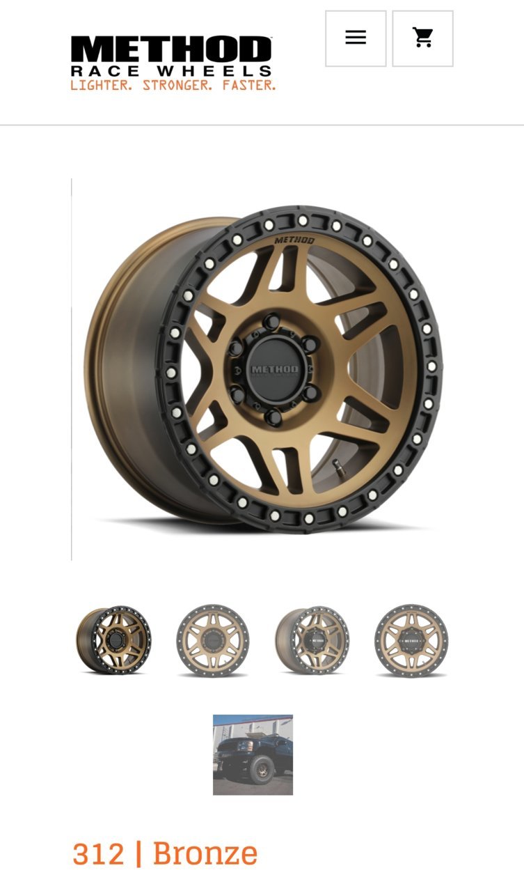

    Another good choice is the bronze ones that would look great on black or quicksand!
