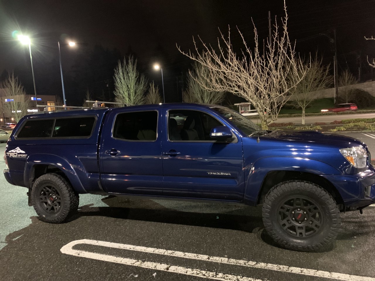

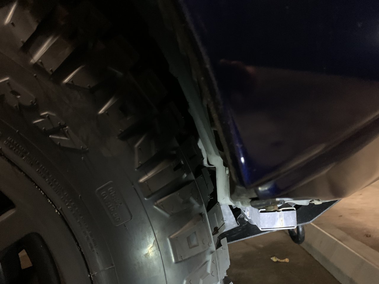

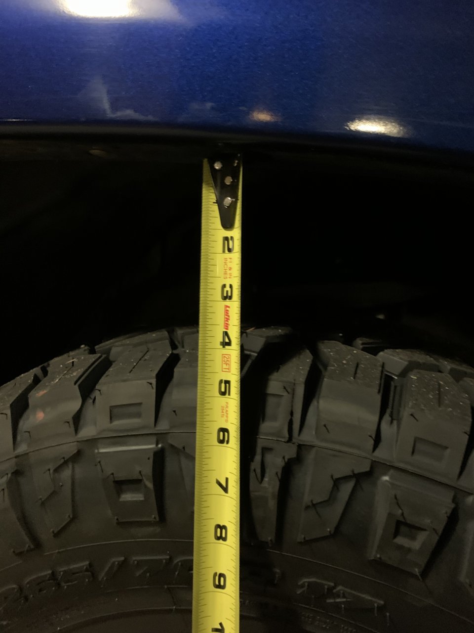

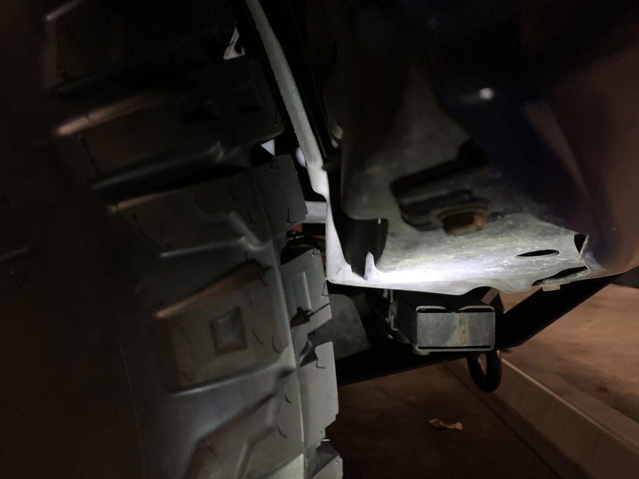

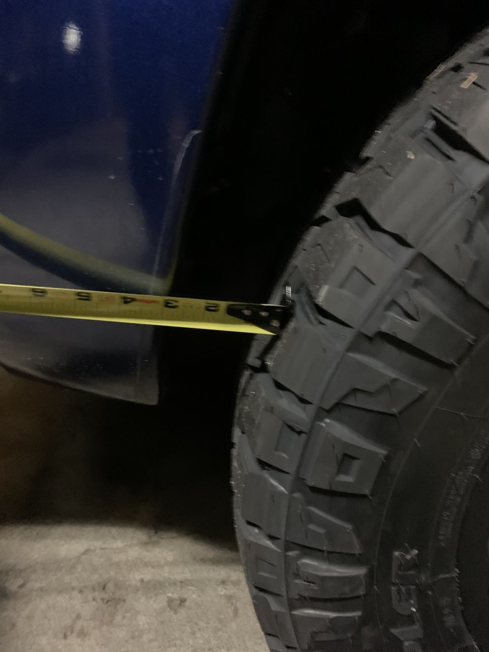

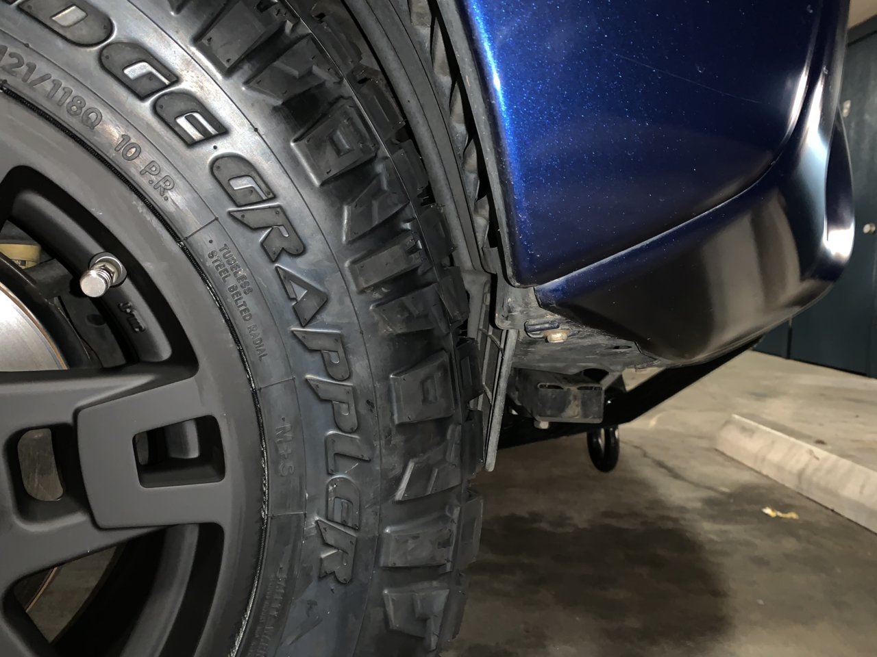

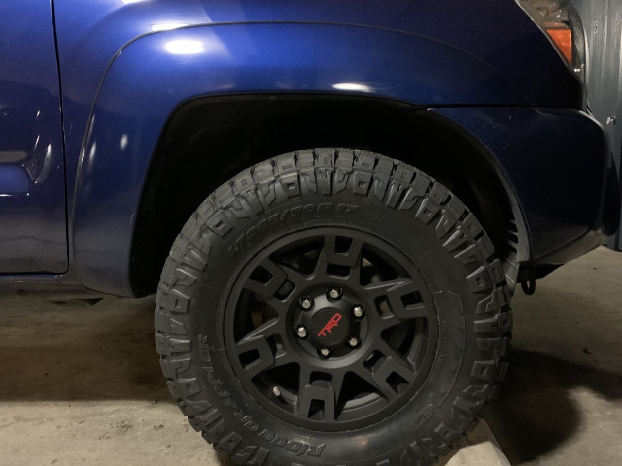

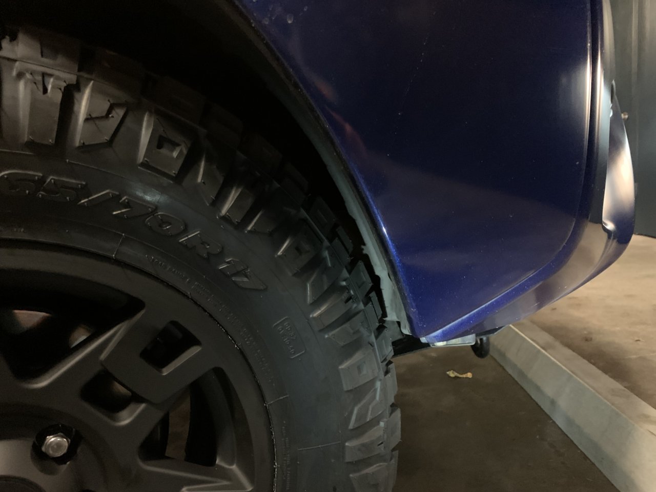

    The 265/70/17 Nitto Ridge Grapplers ended up being much larger in real life, than I thought they would be. There is slight rubbing in reverse when the wheel is locked, but I’m concerned when going off road.
    I have the TRD Sport package. If it’s going to be a problem, what are my options?
    passenger side pics, wheel center, wheel locked left, wheel locked right.

    Get rid of that little flap in front of your wheels, thats whats rubbing probably. You should be fine going offroad with that wheel size.
    Your tire and wheels look good.

    It looks like your front flaps are rubbing. Take them off and report back.

    Thanks guys, I’ll take those off and test and get daytime pics

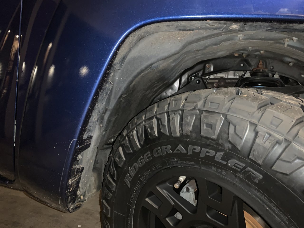

    Like you guys suggested, removing the flap did it. This is at full wheel lock
