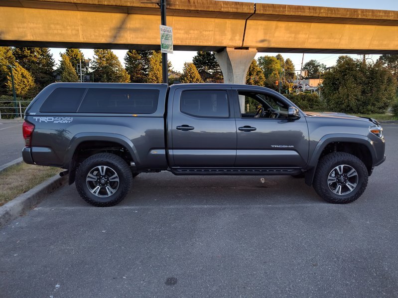

    Where was this picture taken? Looks like Skytrain tracks in the back... I have the same truck. What did you use to life 2 inches?

    Indeed it is....Rona parking lot on Grandview Highway.
    It's the Bilstein 5100/OME 887 combo with AAL.

    The best Rona we have. What did that lift cost and who did it? Your truck is so clean and looks great.

    Thanks. I bought it from Marie @HeadStrong Off-Road earlier this year when she had a special on kits. I installed everything.

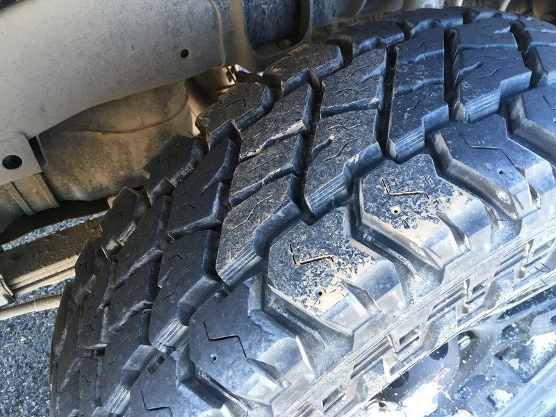

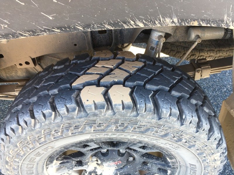

    Chalk test it (or wet latex paint- easier). Very simple to do. My e rated Cooper ST/Maxx tires were very happy at 42psi.
    34176E18-92D3-430E-BD21-3C0461CA3B4A_zps_67b8afa96e0e0a4fbc720db4f5dd7c720f08124b.jpg
    DF84391E-246B-4409-BE92-39ED1B8A1299_zps_b1e20c633fcf58fe503426a6701a80b30e1f0bdf.jpg
    The answer is in the wear pattern for your truck, not from someone else's observation.

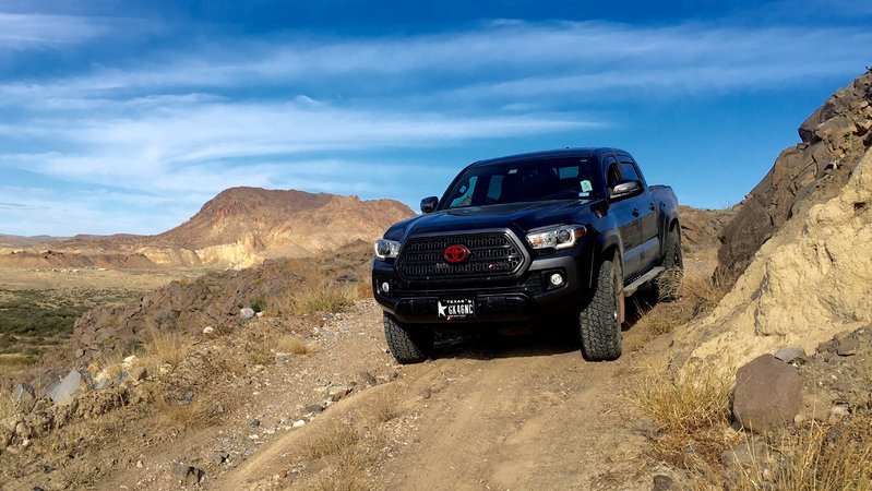

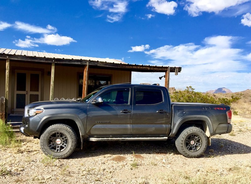

    I have 265/70/R17 LT15, C rated, Nitto's Terra Grapplers G2, rated at 45psi, after chalk testing I keep them at 48psi.
    Wheels are FN.
    Lost 2 mpg.
    Been in east Texas, Nachadoches mud/sand, South Padre sand and out in Big Bend National park area, trails etc....no need for any lift, not even close. Not knocking lifting, just saying no need for me. 90% of my driving is concrete/asphalt/hard pack.....the other 10% is fun time.
    Images of my truck, 2016, stock suspension.
