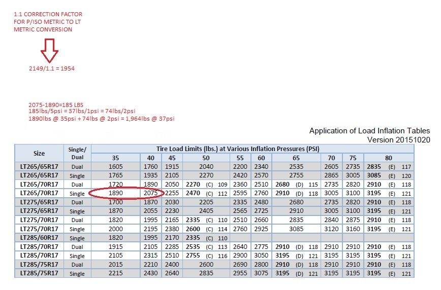

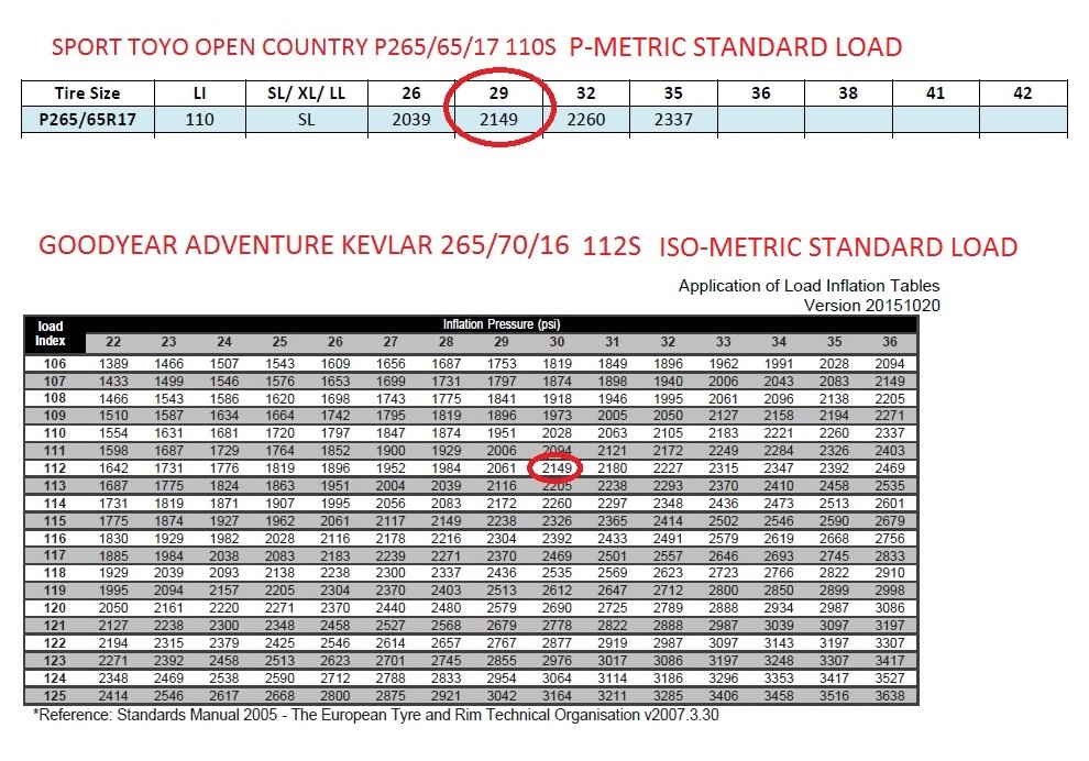

    I'd say +/- 5 psi; 37 being the average. But I digress...:)
    It will vary depending on; the truck's weight, weight distribution, tire size, load rating, etc.
    The tire placard psi a good place to start. It is a recommendation based on GVWR, for the stock tire's size and load rating.
    It is the PSI required to attain a 2,149 load rating from a P or ISO metric standard load tire.
    Since you changed both, adjustments in PSI must be made.
    The info/charts come from here: https://toyotires-1524598101.netdna...ication_of_load_inflation_tables_20151020.pdf
    This is how I arrived at 39 PSI in my previous post.
    Or, do a chalk test.

    Great info... Is there a chart like that for the BFG KO2's? I think 31/32 is a bit low which s what mine are running at. I am wondering if thats attributing to some terrible fuel economy right now.
  7. Jan 1, 2017 at 11:59 PM
    #207
    splitbolt
    splitbolt Voodoo Witch Doctor
    Mar 7, 2010
    #32761
    7,858
    NW Arkansas
    2016 TRD OFFROAD DCSB MGM
    LT is a standard; those charts work for BFG KO2s.
