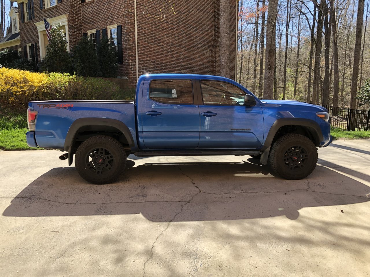

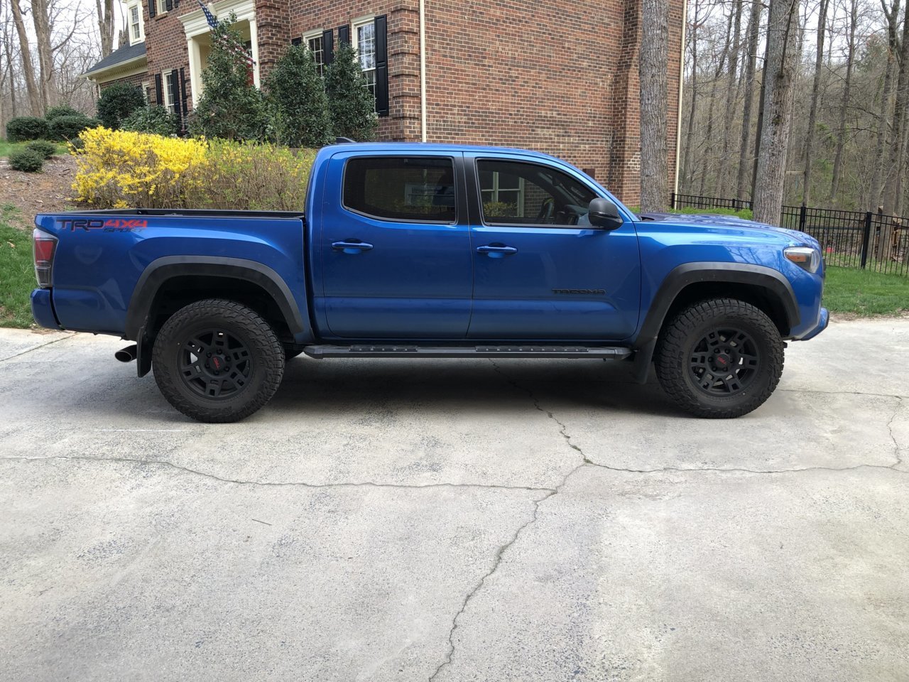

    Forgot to post in this thread after I had my lift installed a few weeks ago. Bilstein 5100s all around, front set to 4th notch 1.55 inches, 1 inch rear blocks. Also had ECGS bushing installed at same time. Has about 1 inch of rake. I think a smaller lift like this is a good fit for 265/70/17 tires. Before and after pics below.
    Before
    After

    Looks perfect! My kind of lift, just enough to give it aggressive look and more ground clearance.

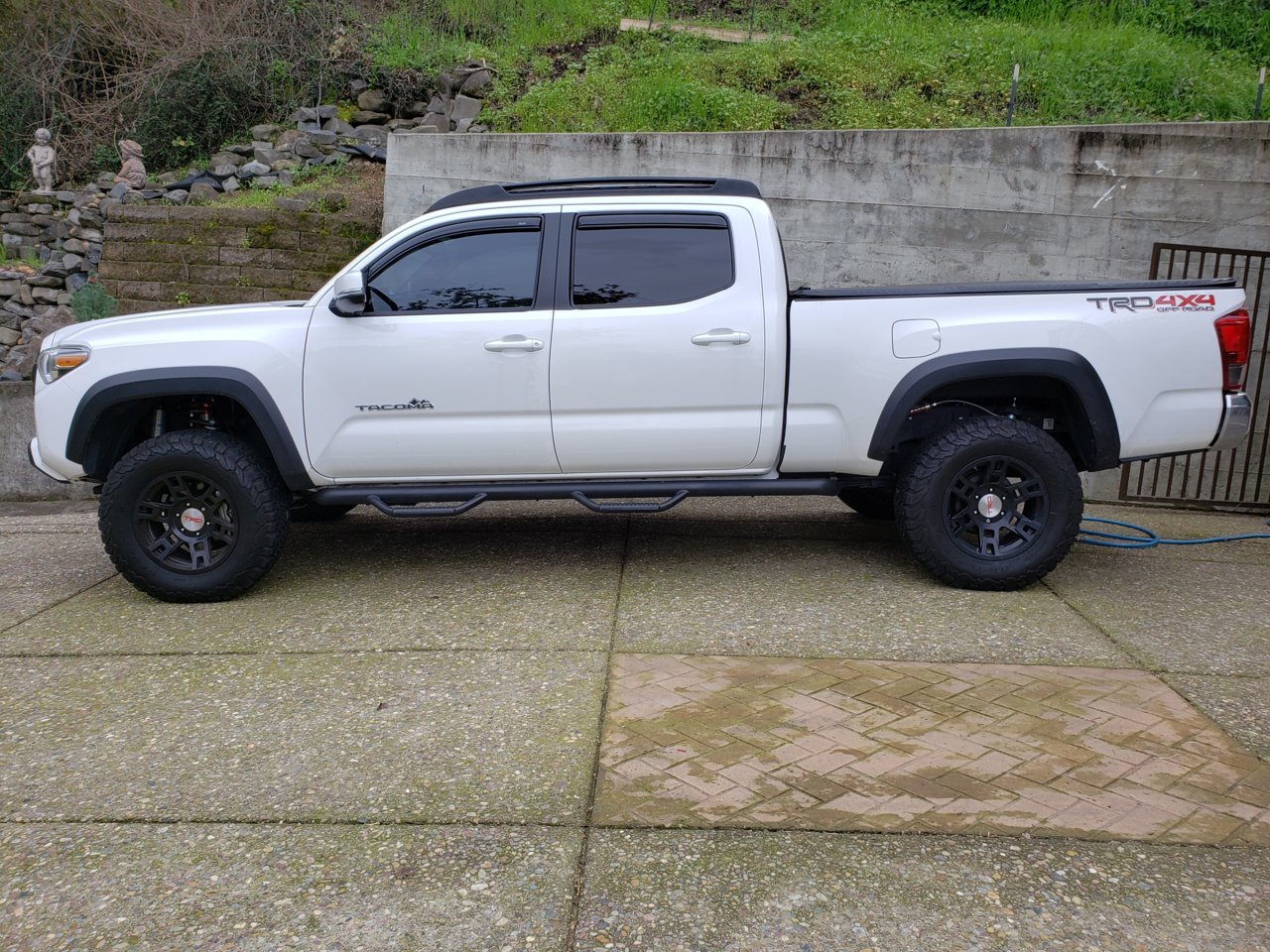

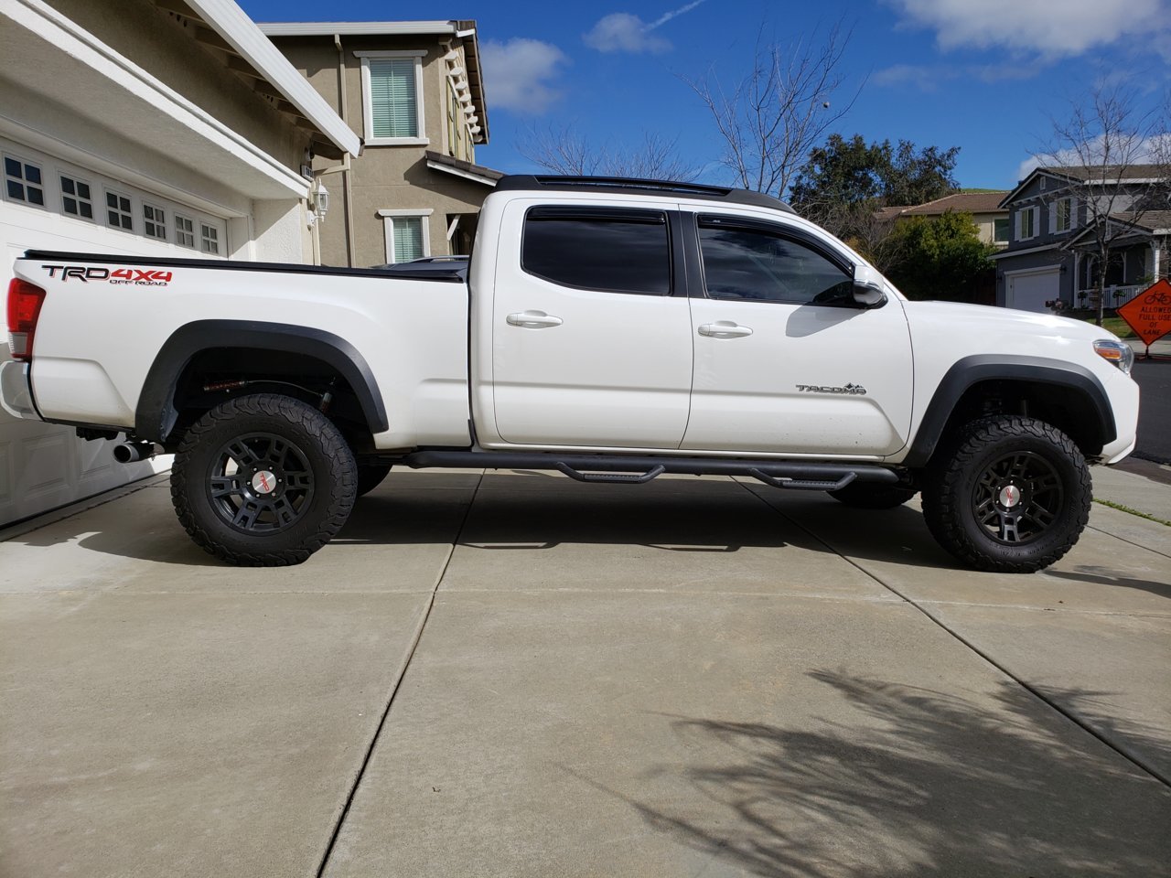

    Just about 2 inchs up front and 2 inchs in the back with a slight rake. On toytec boss 2.5 front and toytec 2.0 in the back with a progressive 3 leaf AAL(*edit* removed overload) and SPC UCA with 265/70/17 bfg ko2s C rated.

    Nice. Did you keep the overload in?

    Took the overload out
