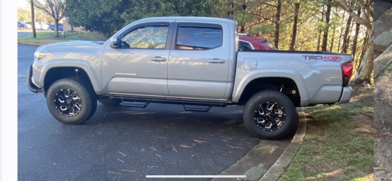

    134
    Jody
    Canton 30114
    2019 Cement DCSB TRD 4x4
    Fox Shocks JBA UCA
    I put a 3” front 2” rear Rough Country on mine.
    265/70/17 Nitto Terra Grappler G2
    No rubbing no issues at all
    BlkTaco47 likes this.

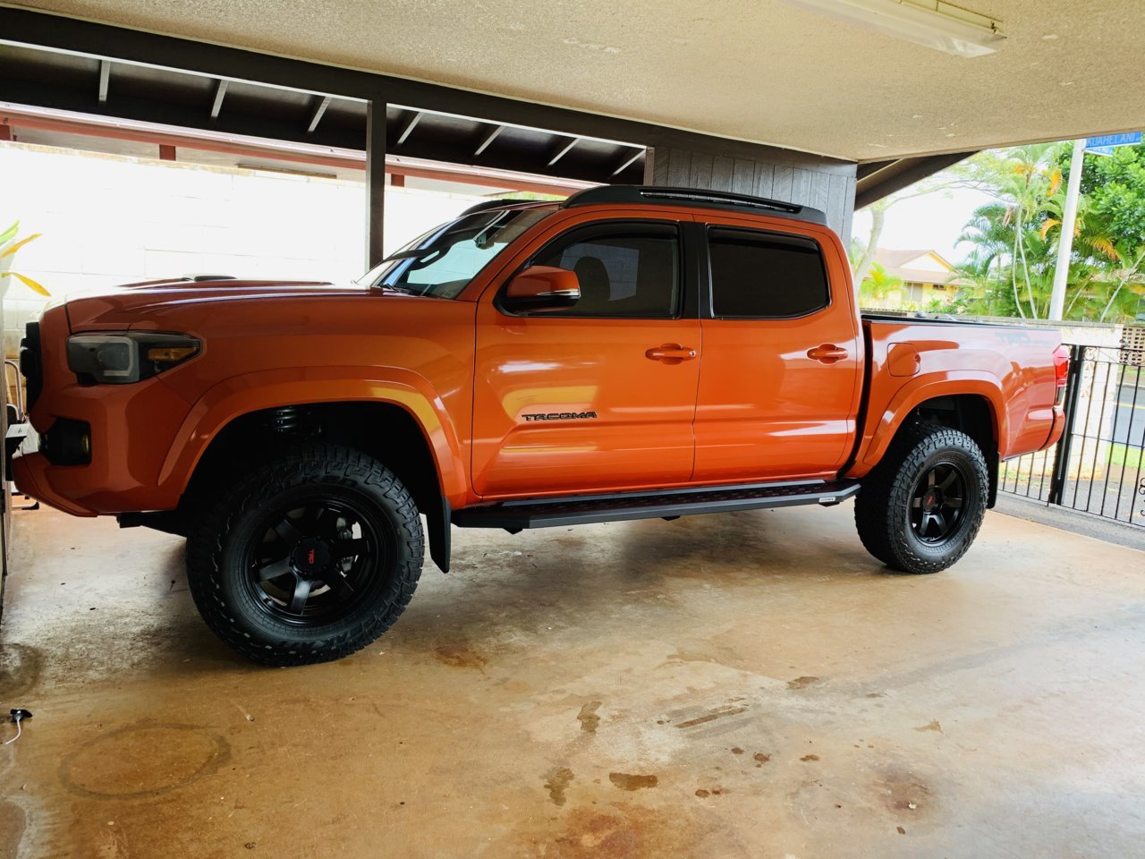

    siKjiTz Well-Known Member
    Nov 21, 2014
    #142795
    321
    E
    Oahu, HI
    2017 DCSB TRD Sport Inferno
    TUNED 2.0 Beta 87 Eibach Pro Truck Lift Kit Stage 1 Wheelers 1.5” Progressive AAL Level 8 MK6 17x8 Falken Wildpeaks 265/70/17” Redline Tuning Hood struts Matt Gecko LED Bed lights OEM Roof racks GoRhino RB20 Running boards A/C drain Mod Kicker speaker upgrade w/kicker key amp. MESO Stage 1 Tail light upgrade OEM Bed Mat
    Eibach Pro Lift kit stage 1
    265/70/17 Falken Wildpeaks 0 offset
    17” x 8 Level 8 MK6
    Wheelers 1.5 progressive 3leaf AAL
    Overload out

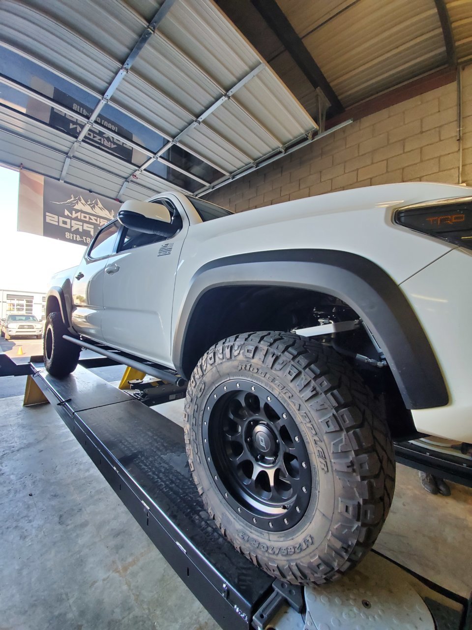

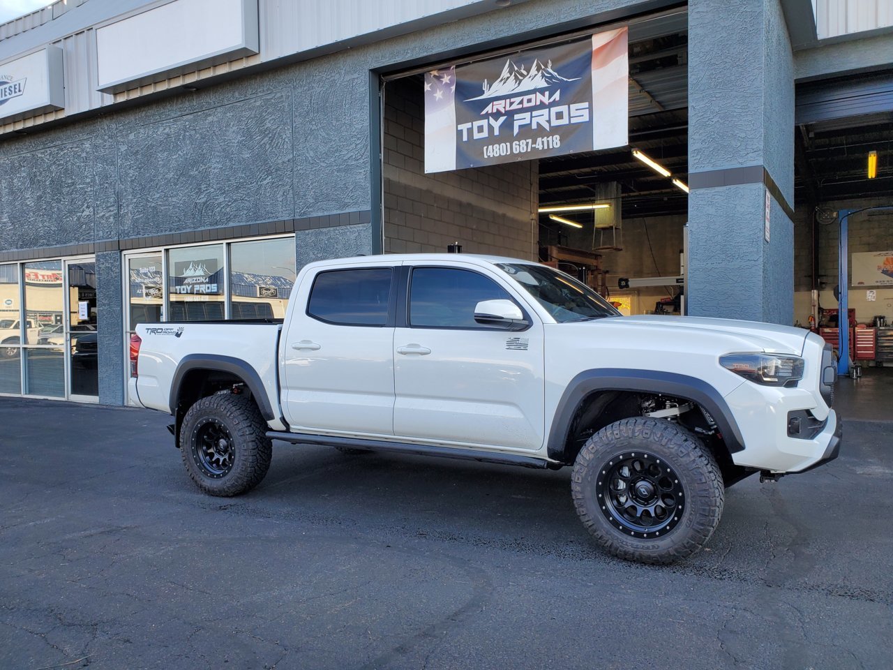

    tacochep
    tacochep Well-Known Member
    Apr 17, 2017
    #216462
    655
    Phoenix AZ
    2019 S White Taco DCSB TRD 4x4
    scs ray 10's, demello sliders, meso stuff
    ICON RXT packleft at option 1, (23 7/8" center hub /bottom fender in rear 1 7/8" overstock) your current offroad/camping weight keeps it 1/2"above level when loaded up
    700lbs spring rate coil-overs (came at 6 threads on driver side and 3 threads preset from ADS-which was perfect for about 2" of lift)
    Goal was to get to 2.5" lift in the front, (set driver side to 8 threads and passenger side to 5 threads-center hub/bottom fender-22.5") springs will settle in a bit-then we can touch up adjust it again.
    Txt Copied from my installer
    Thank you. Really happy how the set up is performing
    levie125 likes this.

    J Barry
    J Barry Well-Known Member
    Jan 6, 2020
    #315361
    134
    Jody
    Canton 30114
    Fox Shocks JBA UCA
    Is sitting slightly in the gutter there so it looks a tick lower in the rear but it’s in fact level
    no rubbing even when I turn it all the way both directions I’m forward and reverse
