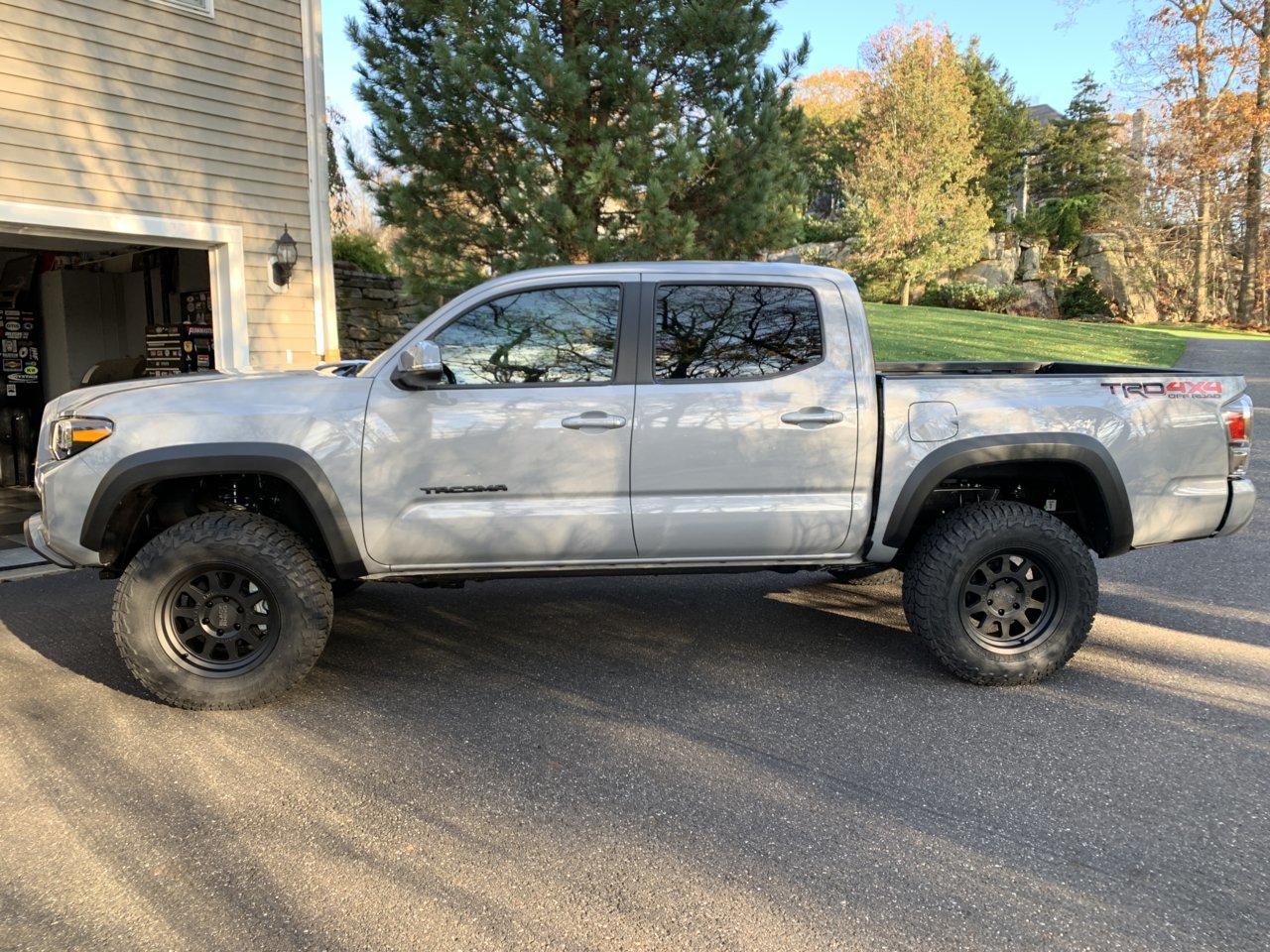

    One more.

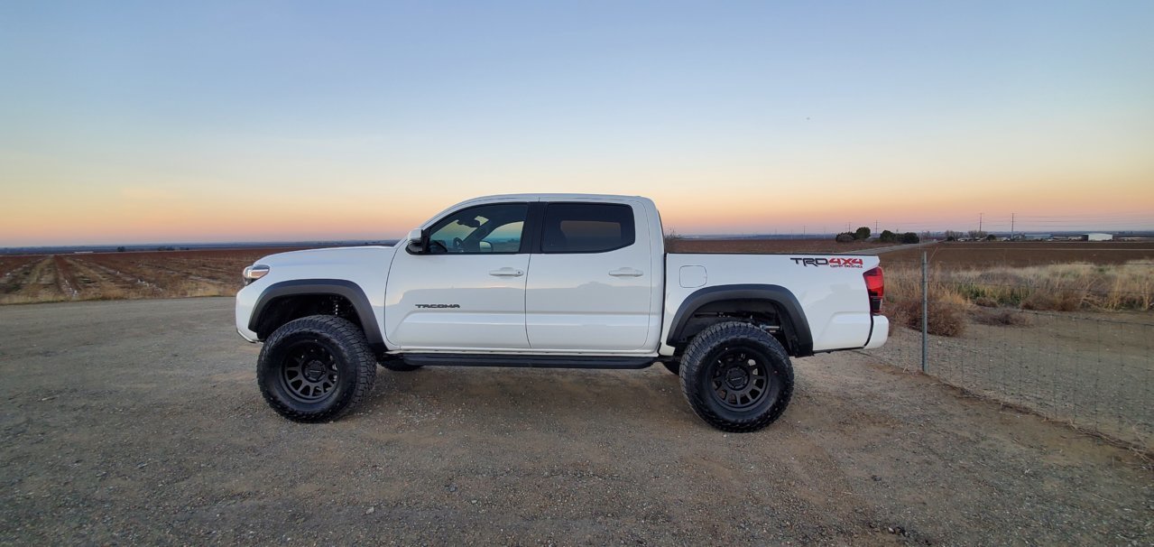

    For anyone that is on the fence between 265/275 vs 285. I actually returned my 265/70/17 and haven't looked back.

    Setup?

    Honestly I don't feel the that much of a difference performance wise. The tacoma was slow with stock tires the tacoma is slow now with 285s.

    Bilstein 6112 at 5/6 setting and 5160 with 1.5" AAL with overload spring kept in.
    Falken wildpeak at3w 285/70/17
    Method 703 17×8.5 0 offset

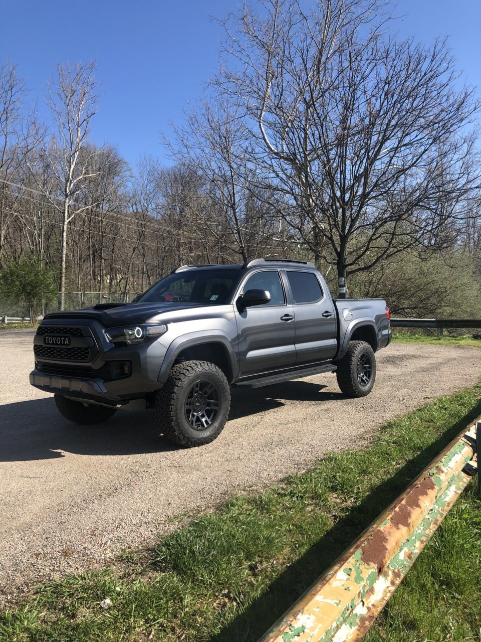

    Here is my truck done finally.
    Eibach pro lift, 1st notch with icon aal. Net 2in front, 1.5 rear(overload removed). 265/70/r17 wildpeaks on a -12 offset wheel

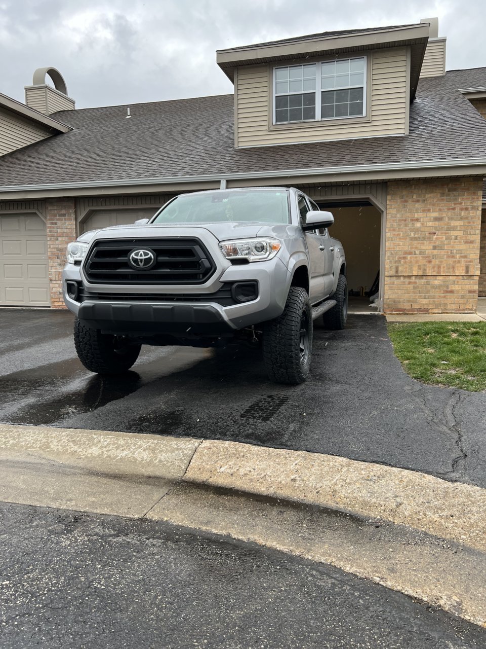

    Bilstein 5100, KMC Trail 17x9 -12, Falken Wildpeak AT 265/70R17
    Frequent visitor of TW but this is my first post: just had some work done on my 2021 Tacoma SR. Bilstein 5100s in all the corners, KMC Trail 17x9 -12, Falken Wildpeak AT 265/70R17.
    Rides like a dream, stiff but in a good way. As for MPG, not sure about the hit. I was driving back 40 miles going 75 with the old wheels sticking up out of the bed, which I’m sure killed aerodynamics.
    No rub at full lock on flat ground, haven’t stuffed it yet. I freaking love the way it looks.

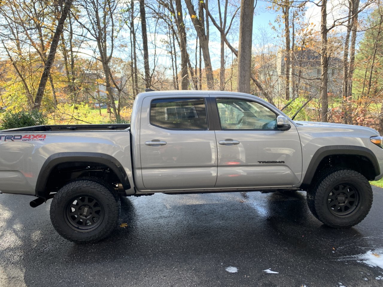

    Eibach Stage 1, 17x8.5 Ray 10s, 265/70-17
    Eibach stage 1 on 1st setting (2") , Eibach 1" block in rear. 17x8.5 0 offset KMC Summits w/ 265/70-17 Goodyear Ultra Terrains

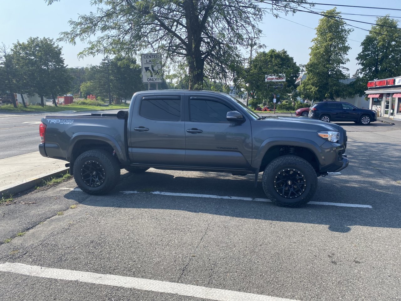

    Here is my OME setup with 265/70 KO2
