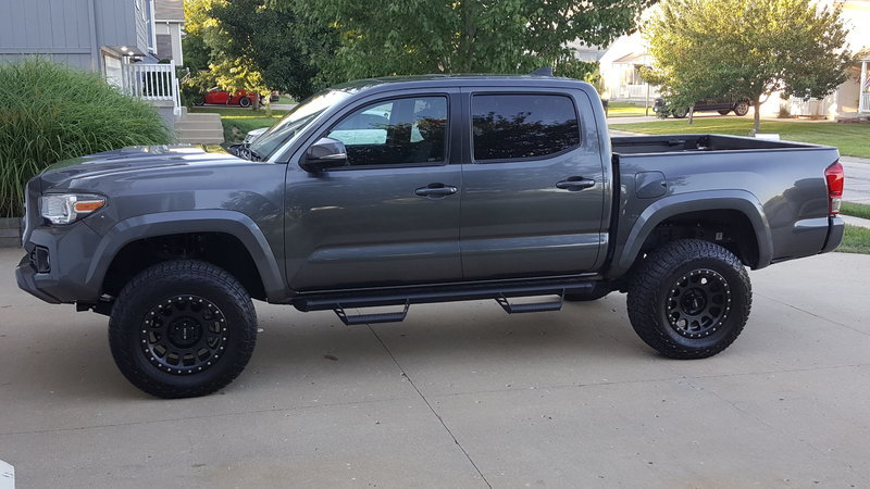

    Here is a side shot from last weekend.
    My ground to fender measurements are....
    PSF-38
    PSR-39.75
    DSF-37.75
    DSR-39.75

    I did get more than that with the Dakars. See post above for measurements. I just realized I didn't take any measurements after everything settled, so it looks like I ended up with about 2 inches of rake with the Dakars.

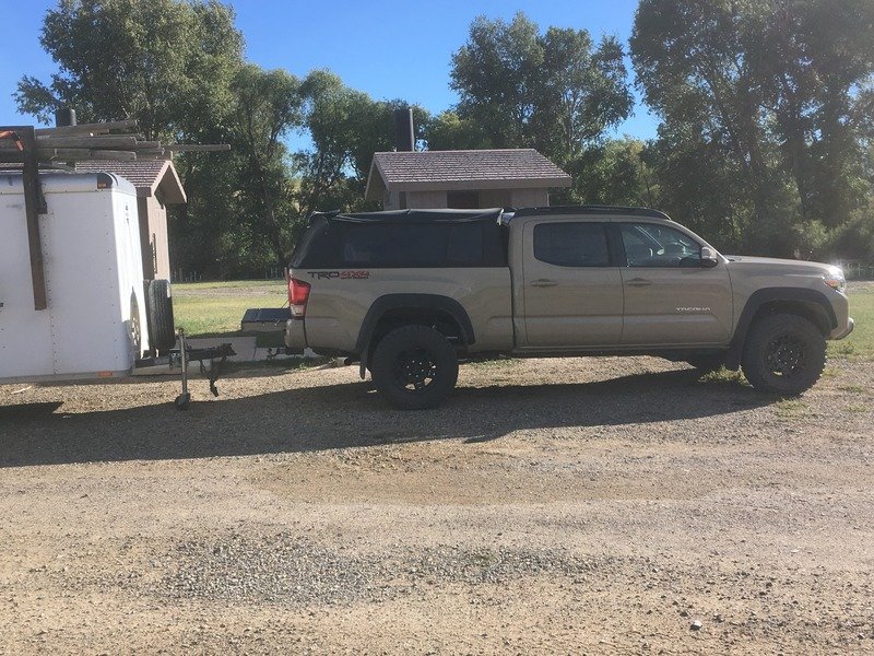

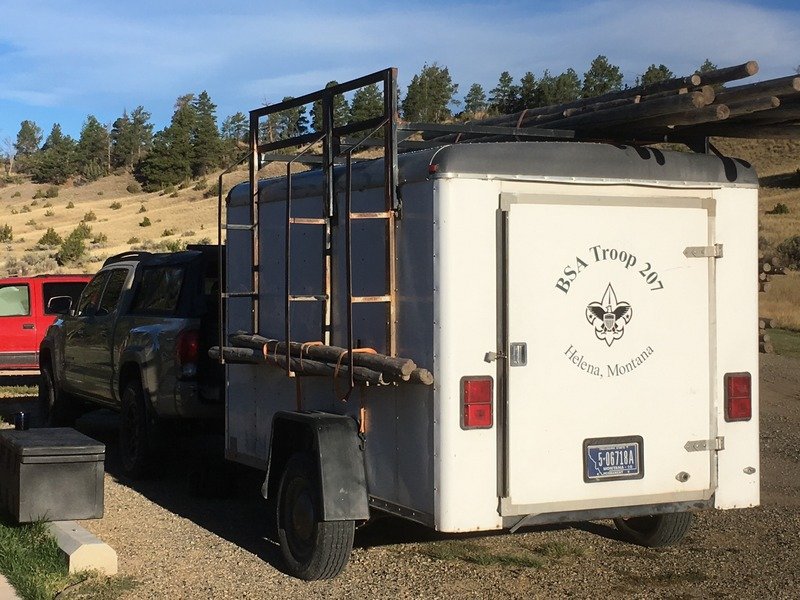

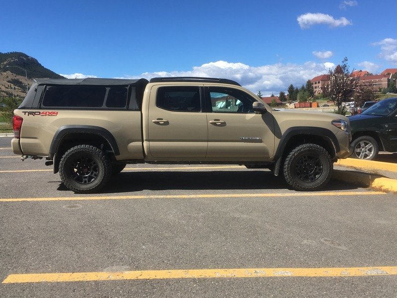

    I had a fully loaded bed yesterday. Camping with scouts this weekend. Rear dropped 3/4" and was fine driving around- no problem.
    I hitched up our troop trailer which is an old single axle with a weight over 3,500 lbs. That did drop her down a bit. Towed this up and down grade 30 miles.
    If I did this regularly with the trailer i'd put the overloads back in
    4D317523-A5D6-4E4D-9988-EC5DBA537EB8_zps_37f6d3e46664b97f33d00d3024746616a58be08e.jpg
    9715AD17-267D-4512-8EFC-282EB5BDD188_zps_6e8885181e8e4917a16887051f70f93f3c6b41ae.jpg

    Who's sliders are those? Look nice and clean

    Three run, who's soft topper is that? Looks good. Why soft topper vs. hard topper?

    Demello-Offroad bolt ons

    Bestop.
    1. Price-$2,000 vs $550
    2. Versatility- can fold back in minutes to use truck bed.
    3. Portability- 60lbs- I can remove and store top by myself in my shop.
    I owned a Leer fg top for my 8' dodge bed. It become too much of a hassle for me.

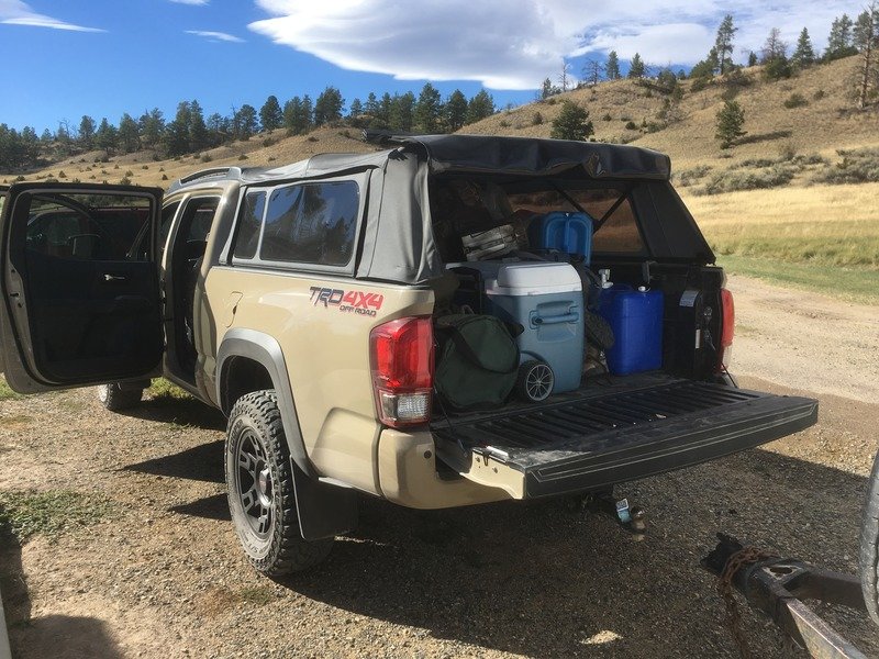

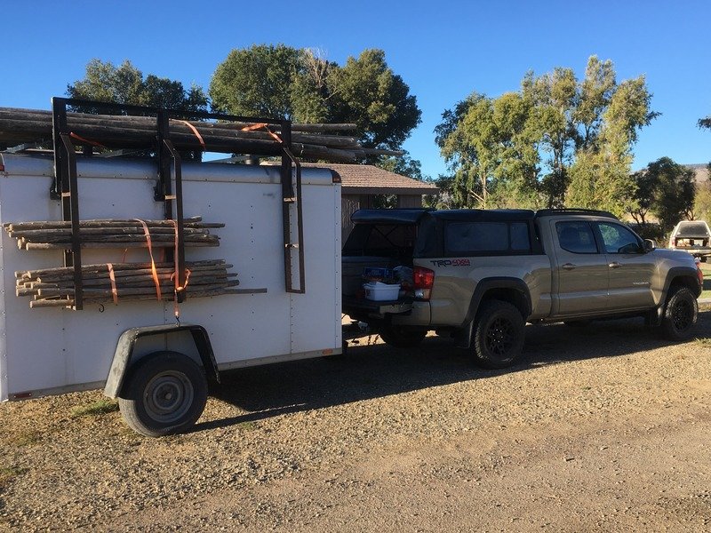

    Okay- Fully loaded bed- not hitched to 3500lb trailer with shitty tongue balance..
    E402C80E-02DA-43D2-B7AC-AD515A79BA3D_zps_1f3b3a6264583bded3f4187ad1c670930d391fc4.jpg
    784C1791-4901-4C6C-A07F-74942BB0282E_zps_5c27217e4737fa393dc5b1736255141ee06eae19.jpg
    Empty Bed-
    64A1F94D-D9BE-434C-A75A-E9335236A6A2_zps_4f5828510189816aa7e2651bfd5c6c3460cdf3c0.jpg

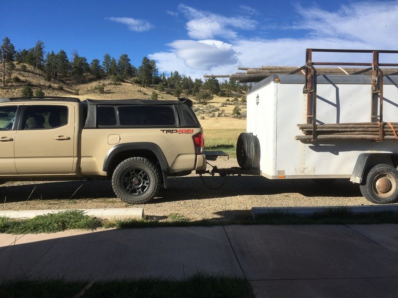

    Hitched up to trailer with est. tongue weight around 400-500lbs.
    5BE192C6-FC58-4237-94F5-B1BF2AB932D6_zps_b6e07079c6081d26acb46d558cb33f008bfb0f7d.jpg
    Quite frankly driving with just a load in the bed is fine. It holds the load very well, I think it would do well offroad. It's a comfortable drive.
    Add a crappy old overloaded single axle trailer carrying 3,500lbs with a tremendous amount on the tongue? Not a very happy truck. I towed this 40 miles round trip to a local camp spot for an outdoor training skills weekend- up and down grade, curvy mountain roads- not fun. The truck can pull it- that I have no doubt, the weight is really distributed poorly- so lot's of rear bounce with that weight shifting on one axle from tongue to rear and back again. That trailer needs to go on a diet, or better yet we need a lighter trailer, tandem axles and ditch one of the two canvas outfitter tents stored in there...
    Sheesh that thing is a beast for such a small trailer..

    That's good to know. I may have to switch to Dakars if I get called upon to haul that little beast trailer often. I'll definitely have to add the overload back in if not. I have to check to make sure the rear 5160's can handle it. I can always kick up the 6112's a notch to proportionally match any increased lift in the rear.
    I just don't want to wind up sacrificing my ride quality 90% of time in order to handle the 10% of the time I need the beefier spring. Time will tell.
